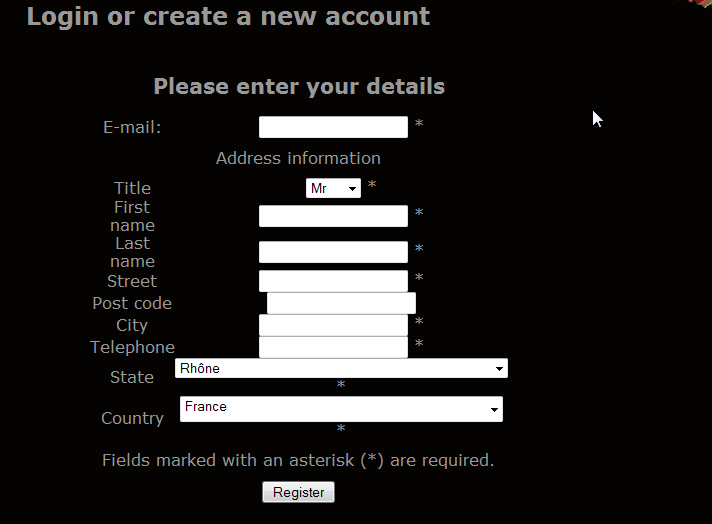

I am using business 1.4.9, and have deleted all amendments from the relevant view files, so I am using stock files.
My checkout workflow is: cart,login_address,shipping_payment_confirm_coupon_cart_status_fields,end
Registration is disabled.
My problem is that when I click next on the cart page I am taken to the Login or create new account page (presumably the login_address part). when I enter the details and click register, the same page reloads with the information I entered being kept, but does not progress me to the next page.

I've looked at all three of those files and cannot find what I need. I want to put the email address at the bottom.

In the file registration of the view user, you have the code below that you can put at the top in order to move the email field below the address fields:
<tr class="hikashop_registration_address_info_line">
<td colspan="2" height="40">
<?php echo JText::_( 'ADDRESS_INFORMATION' ); ?>
</td>
</tr>
<?php
$this->type = 'address';
echo $this->loadTemplate();

Nicolas, moving that code to the top just leaves me with a completely blank page..

That's because you didn't copy it properly. You need to put that code outside the <?php and ?> tags.

I did put it outside the tags, I presume you mean to put it after the <table>?
<table cellpadding="0" cellspacing="0" border="0" class="hikashop_contentpane">
</td>
</tr>
<?php
<?php if(!$this->simplified_registration){ ?>
<tr class="hikashop_registration_name_line">

Sounds good. Could you look in your PHP errors log for the real error message, or turn on the display_errors option in your php.ini file so that the error message appears on the page instead of a blank page ? Having the error message will help understanding what is going on
  • Posts: 43
15 years 2 months ago #16306
[Fri May 13 14:36:42 2011] [error] [client 82.9.46.143] PHP Fatal error: Out of memory (allocated 207618048) (tried to allocate 40961 bytes) in /home/sites/bytebackinternet.co.uk/public_html/vintageleathersofas/libraries/joomla/application/component/view.php on line 561, referer: www.bytebackinternet.co.uk/vintageleathe...l=checkout&Itemid=10

That indicates that there is some kind of a loop on the loading of views. Could you post the whole registration view code (as a txt file) ?
