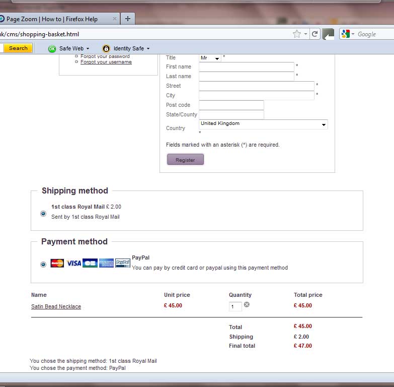

  • Posts: 19
15 years 3 months ago #16377
Hi Nicolas
The Main Tax zone is: 222 United Kingdom.
The zone in the two Shipping Methods is also set to: 222 United Kingdom.

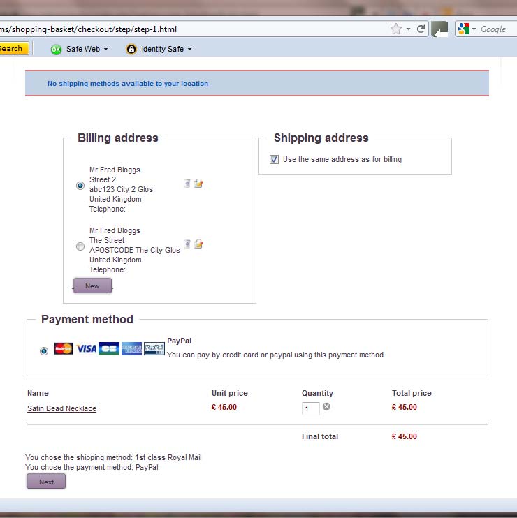

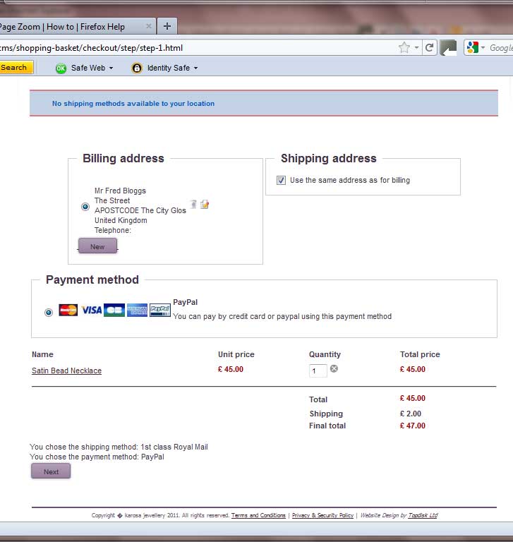

Before I logon with my test user, there is no problem. But once I logon with the test customer, Fred Blogs - in whose Billing and Shipping address the country has been set to United Kingdom – then the error appears:
“No shipping methods available to your location”
I have attached some screen shots to show this.
Shipment Methods:
Checkout before customer logon:
Checkout after customer logon:

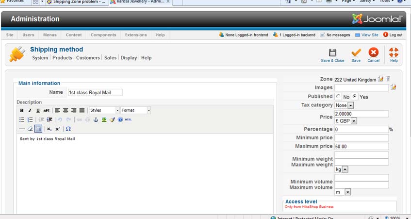

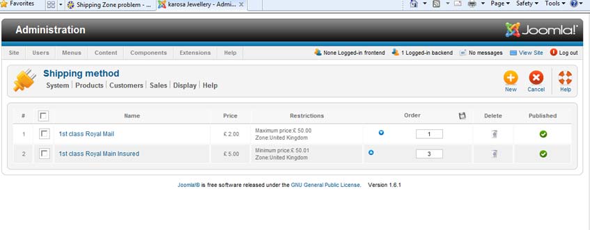

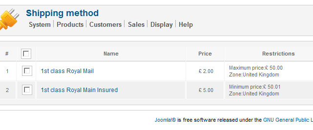

It's a bit blurry but I think that on the shipping methods listing screenshot you made, one of the two methods has a maximum price in euros while the minimum price of the other is in pounds. So that could explain the problem: the price of your order is within the gap of the shipping methods and thus they are discarded. Could you check on that ?
  • Posts: 19
15 years 2 months ago #16414

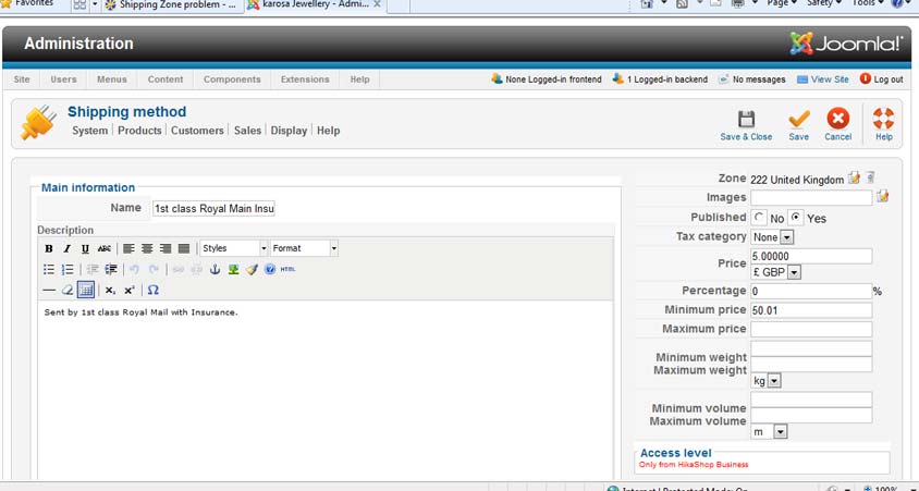

No, I think they are both in GBP. I've included screenshots below.
Shipping method 1:
Shipping Method 2:
The shipping methods seem to work fine if I do not restrict them to zone "222 United Kingdom" - so I think I must have got something wrong relating to the shipping zones. But I can't figure out what.

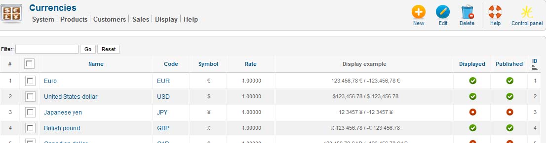

On the listing of shipping methods do you see a € or a £ ? If you see a € and that you have a £ when you edit the shipping method, that's because you have the € saved in the preferences but that you unpbulished it. So the system doesn't find it there and displays the dropdown with £ because € is not available but the € is still there as long as you don't save the shipping method.
  • Posts: 19
15 years 2 months ago #16420
No, I see £ for both shipping methods in the list of Manual Shipping Methods - I've added another screen shot below...
I've also checked the currencies and both Euro and British Pound are published.

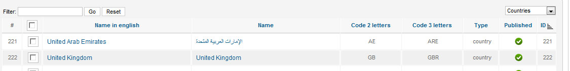

That's indeed fine. Could you check that the zone for UK on your System->Zones listing if of the type country and has the id 222 ?
  • Posts: 19
15 years 2 months ago #16425
Yes, United Kingdom Country Zone has id 222 - screenshot below...

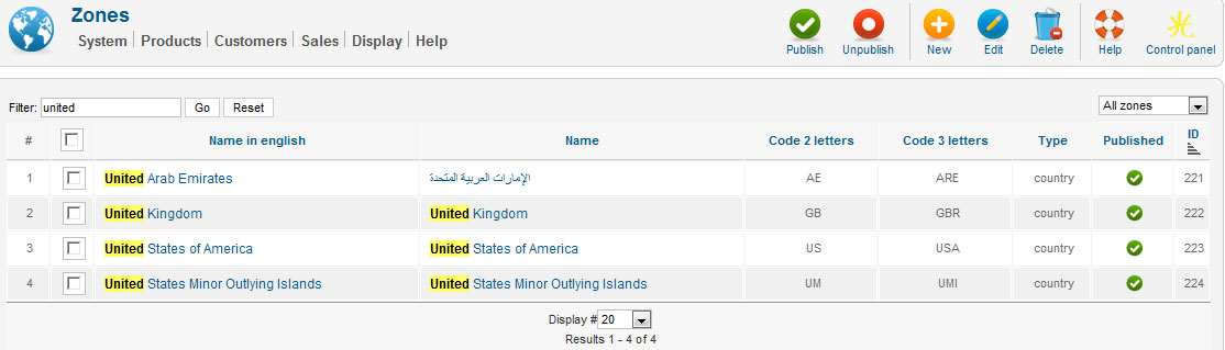

Could you check that you have only this one (because if you created another UK country zone and that you used that one for the address, that would explain the problem)?
  • Posts: 19
15 years 2 months ago #16429
Yes, there is only one United Kingdom zone (i.e. Country Zone 222).
When I first hit this problem, I tried to solve it by creating a Shipping Zone "United Kindom" that contained the "United Kingdom" Country-Zone as a sub-Zone. But that didn't work, so I have since deleted that Shipping Zone.
Current Zones starting with "United":

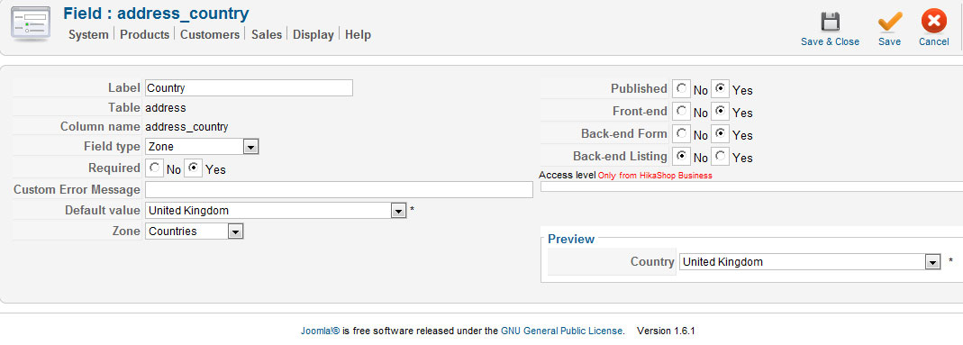

I have also set the default value for the address_country field to the country zone: United Kingdom 222:
Last edit: 15 years 2 months ago by td001.
