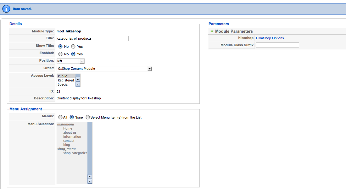

  • Posts: 117
15 years 2 months ago #16641
I have tried, but the categories are not showing up on the home page. I have given it a left position in the joomla modules section.
Please can you advise me
Many thanks
[img size=97.5 kb] www.allyoucanbear.com/ebay/picture 7.png[/img]

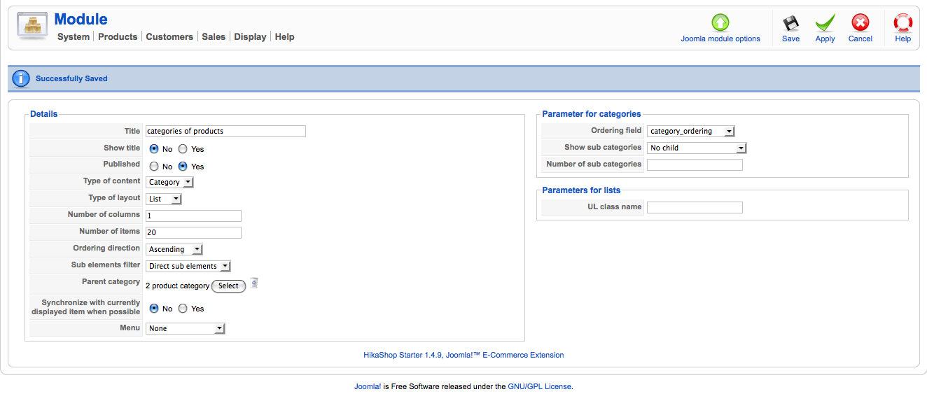

  • Posts: 86048
  • Thank you received: 14177
15 years 2 months ago #16656
Could you do a screenshot of the joomla module options ?

  • Posts: 86048
15 years 2 months ago #16663
You need to select 'All' in the "Menu" option.
  • Posts: 117
15 years 2 months ago #16665
Thank you. That did it.
