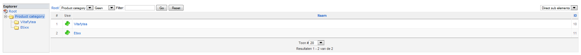

i want to select the category by clicking on the green icon in column 'use'. but nothing happens. the url is www.mijnapotheekonline.be/shop/administr...mponent&filter_id=2#

  • Posts: 9
15 years 8 months ago #1729
on demo website everything goes correct. the difference is that clicking on category icon (after 'category not found') the link is opened in the same window not in a popup.
