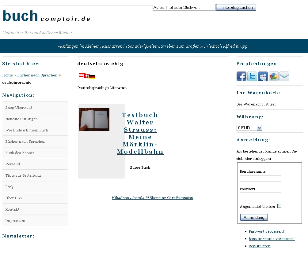

I have a display problem which only occurs in a certain module and all its subcategories:
http://shop.buch-comptoir.de/index.php/buecher-nach-sprachen/category/listing/cid-14/name-englisch--english.html
Here e.g. everything works fine:
http://shop.buch-comptoir.de/index.php/shop-uebersicht/category/listing/cid-42/name-broschueren.html
Thx in advance for help, M. :dry:

It seems that you have a table layout for your item boxes which shouldn't be possible.
You should check your menu/module's hikashop options and make sure that the item box layout option is not set to table.

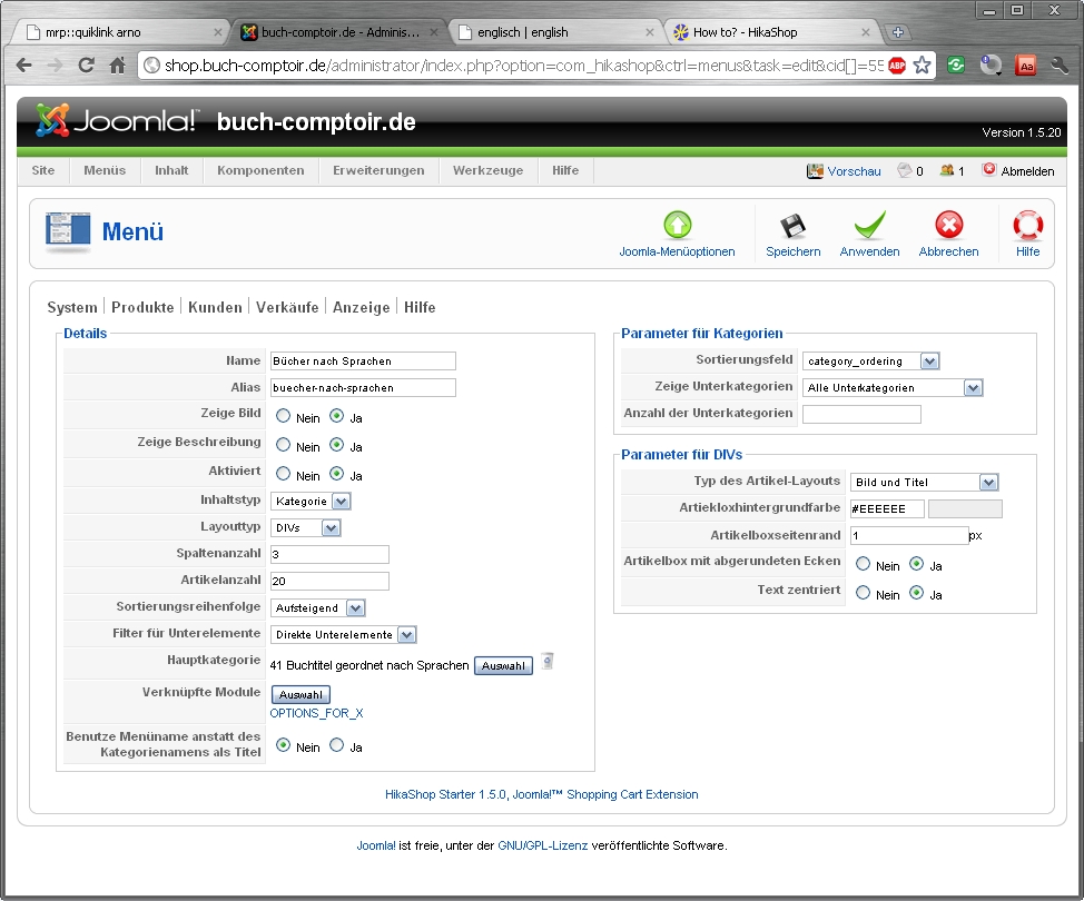

I checked ALL my modules and menus (associated ones, too), all are set to "DIV". Control panel for menu "Bücher nach Sprachen" looks like this:
Hm, pls let me know if and which additional information you need.
Thx in advance, M. :S

You need to click on OPTIONS_FOR_X. There, change the number of columns to 1 and that should be better.

Thx, looks better now for the moment.
Well, I'm done with the setup apparently and can start listing my products.
