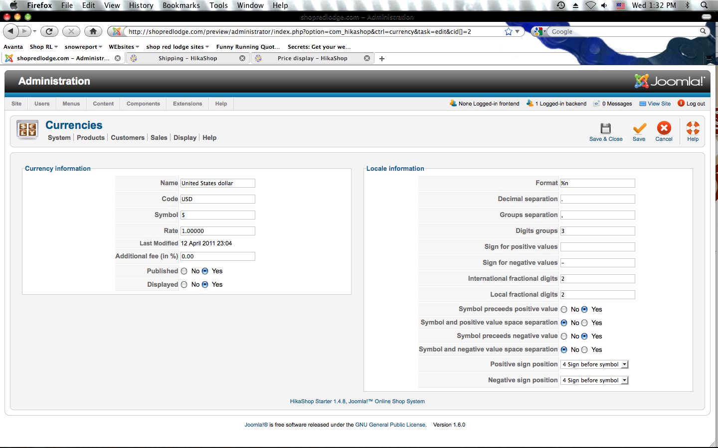

It must be because of the way you setup your currency in the currencies setup screen.
Could you do a screenshot of the options of your currency (menu System->Currencies) ?
  • Posts: 30
15 years 2 months ago #17163
Here you are. Thanks for your help

15 years 2 months ago #17165
That seems all fine.
I also see that when you open a product page, the price is fine.

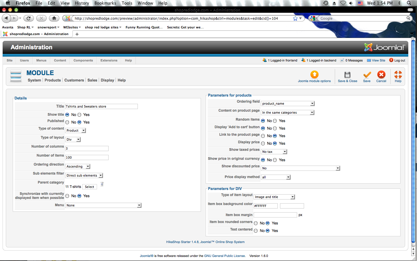

Could you do a screenshot for the hikashop options of your module ?
  • Posts: 30
15 years 2 months ago #17167
Yep, thanks again for your help. I set these modules up in a {loadposition } so that they would show in the article.
  • Posts: 30
15 years 2 months ago #17169
And thats it.... if you put the module in an actual module position then the prices show fine. But if its in a {loadposition} format something gets lost.
