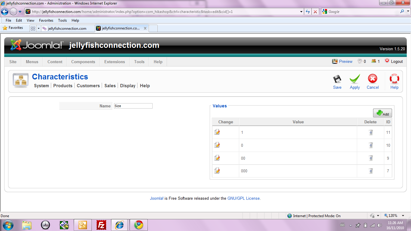

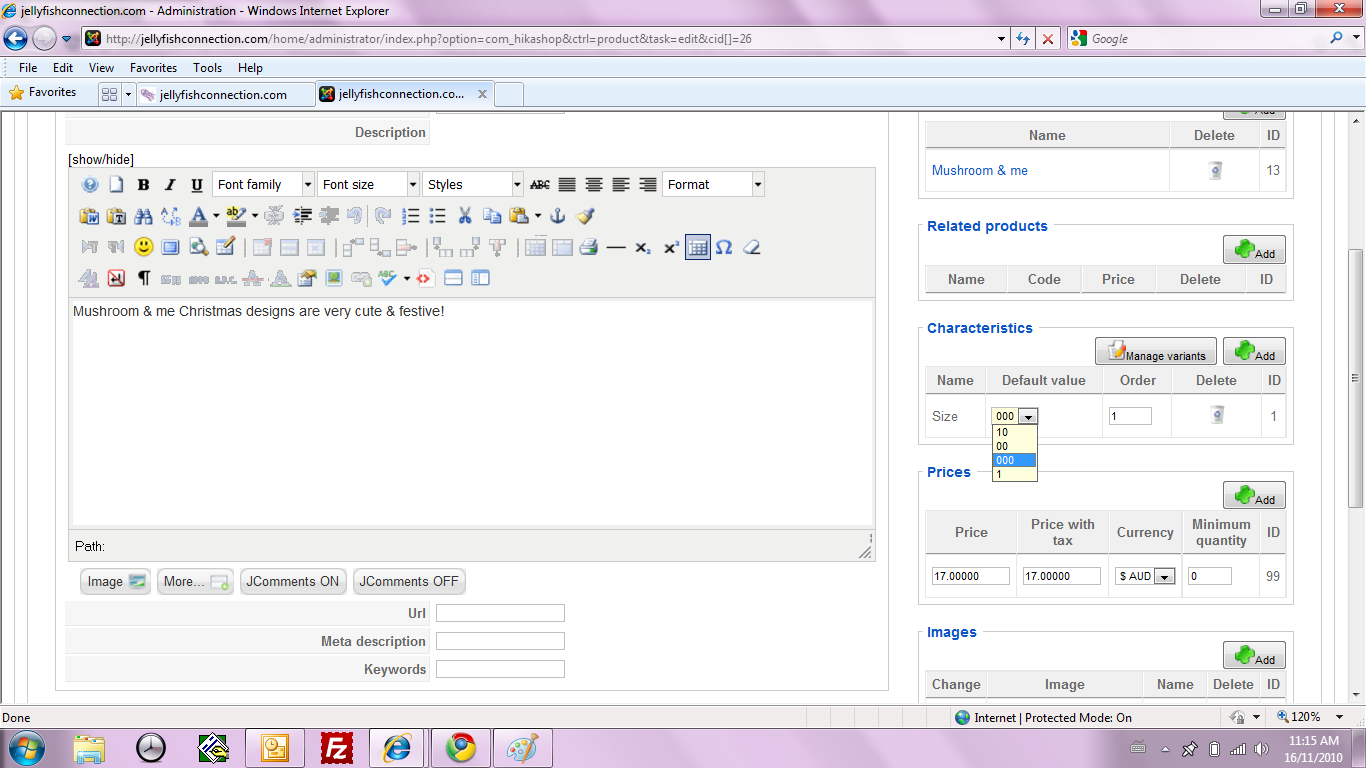

But one of my values is 0 (zero) (also 00, 000 & 1 for kids clothes) the 0 value appears as I've entered it when i go into values & variants but appears as 10 everywhere else & therefore on the dropdown menu on product page it is 10 insteas of 0. Is there any way I can fix this (without changing it to a letter O)?

Could you post a screenshot of the edition page of your characteristic ? That would help us reproduce the problem on our end.

15 years 8 months ago #1772
I hope this shows what you need.
  • Posts: 14
15 years 8 months ago #1774
OK?
  • Posts: 86042
  • Thank you received: 14174
15 years 8 months ago #1776
Yes, thank you. We will try to reproduce the problem and fix it.
That fact that you use 0 and 00 and 000 probably create problems with the checks on emptiness because with you check if a variable is empty in PHP 0 and 00 and 000 meaning the same thing. There are some ways to do the checks differently to avoid such issues.
In the mean time, I would recommend to cheat the system. You could use the values  0  00 and  000
Since   is replaced into a space by the browsers it should work.

15 years 8 months ago #1787
The problem comes from Joomla actually. We use their libraries to display HTML elements and they don't take into account the 0 properly in the library.
In order to fix the display problem for the 0, you can change the code
$this->values[] = JHTML::_('select.option', $key,$val);
to the code
if(strlen($val)!=0 && empty($val)){
				$val = $val.' ';
near line 145 of the file administrator/components/com_hikashop/type/characteristic.php
That's something we are going to include in next release.
