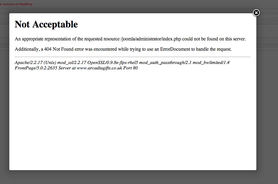

I think I understand how I should get rid of the "each" but it is not working for me. Whenever I hit save I get this message:
Not Acceptable
An appropriate representation of the requested resource /joomla/administrator/index.php could not be found on this server.
Additionally, a 404 Not Found error was encountered while trying to use an ErrorDocument to handle the request.
Do you know why this might be?
Thanks again.

Could you do a screenshot of the problem?

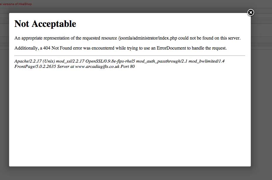

  • Posts: 10
15 years 2 months ago #17656
Does this help?

That's a strange error. No one reported such problem so far. Could you provide a back end access so that we can look at the problem ?
  • Posts: 86050
  • Thank you received: 14178
15 years 2 months ago #17737
You problem comes from mod_security, a module for apache, the web server you're using on your hosting.
It's a common problem on joomla and the solution is to turn off the security filtering engine.
Here are some thread on the joomla.org forum which explain a bit more the problem and how to solve it:
forum.joomla.org/viewtopic.php?p=715527#p715527
forum.joomla.org/viewtopic.php?t=126838
So you should be able to do that in your .htaccess (if you don't have one you should create it) at the root of your website.
