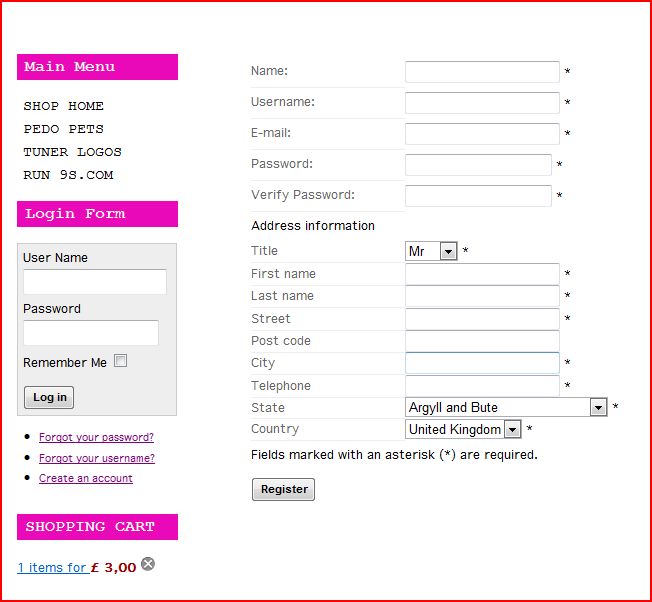

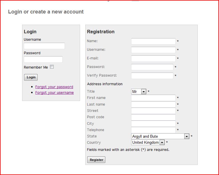

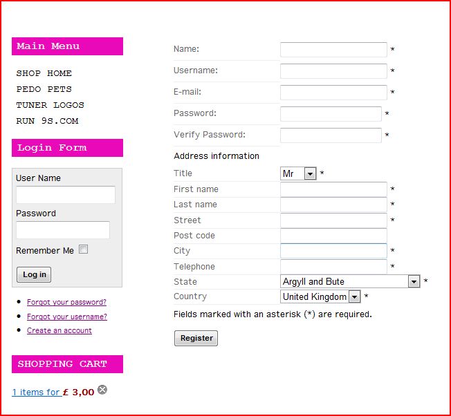

I have updated the create an account link now. If you click on the create an account link below the login box you are taken to the registration form page. You will see that the bottom section of the form is ADDRESS INFORMATION. The boxes are very squashed together and need spacing like the top section. Also there is no border or background colour.

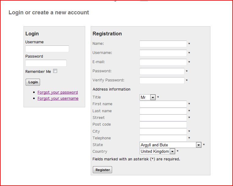

  • Posts: 10
15 years 2 months ago #17532
The picture above is what the form looks like if you go to checkout without registering or logining in.
This picture is what the registration form looks like.

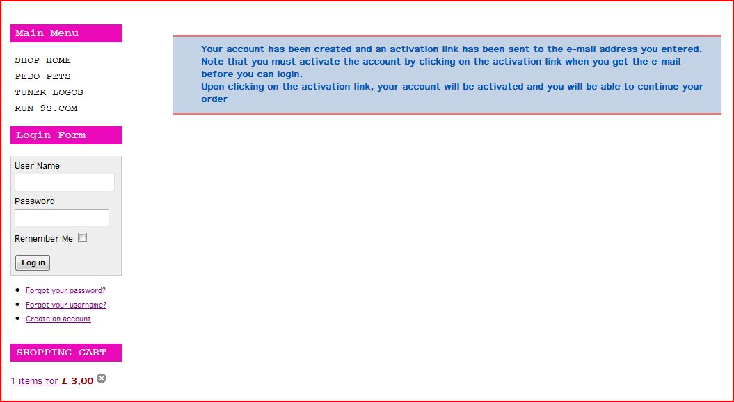

15 years 2 months ago #17535
This is a picture of registering with something in your basket

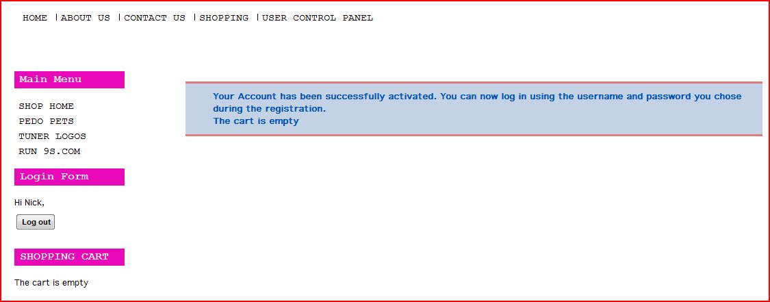

  • Posts: 10

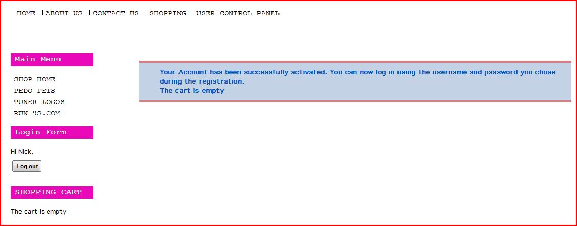

15 years 2 months ago #17536
This is after activating the account. You will see the basket has been emptied

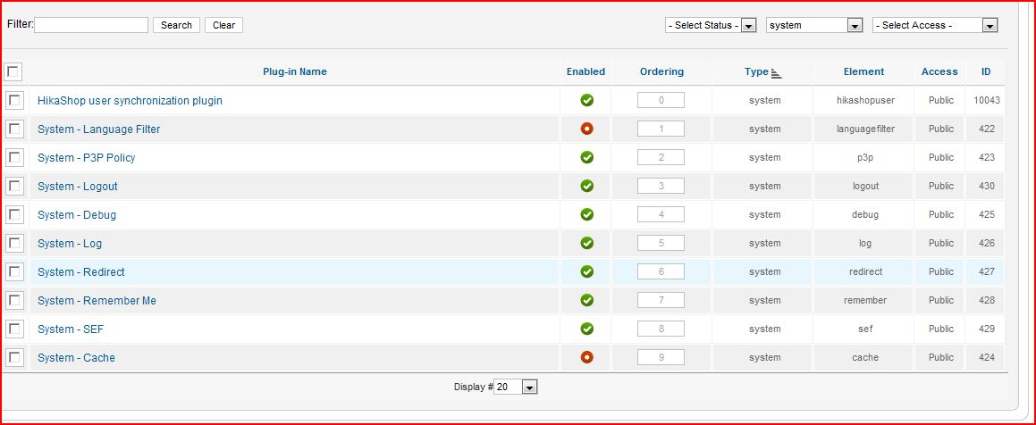

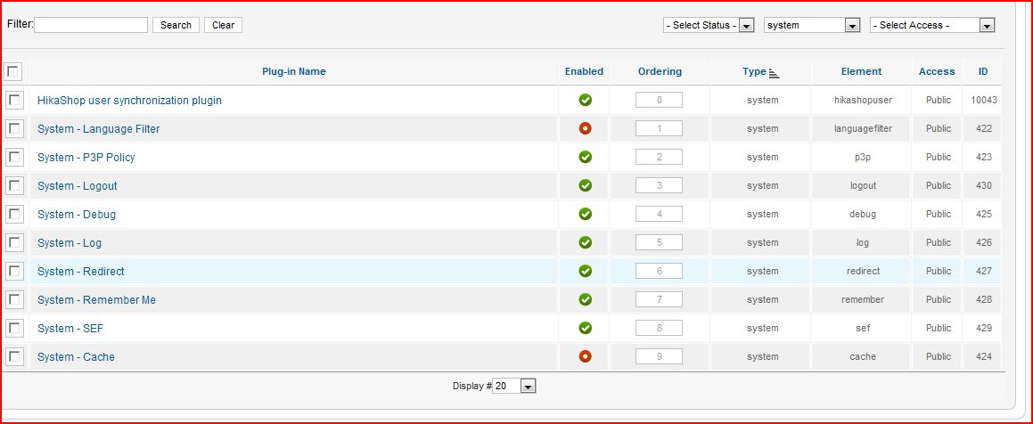

Could you filter the joomla plugins listing by the group "system" and do a screenshot of that listing ?
You can install it by hand yes. In the hikashop install package, in the folder back/extensions, you have a folder plg_system_hikashopuser. If you zip it and install it via the joomla installer, that will install the plugin.
  • Posts: 10
15 years 2 months ago #17583
I have installed it now and all working fine. Screen shot below before installation.
