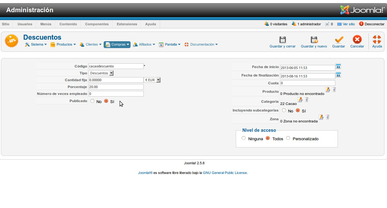

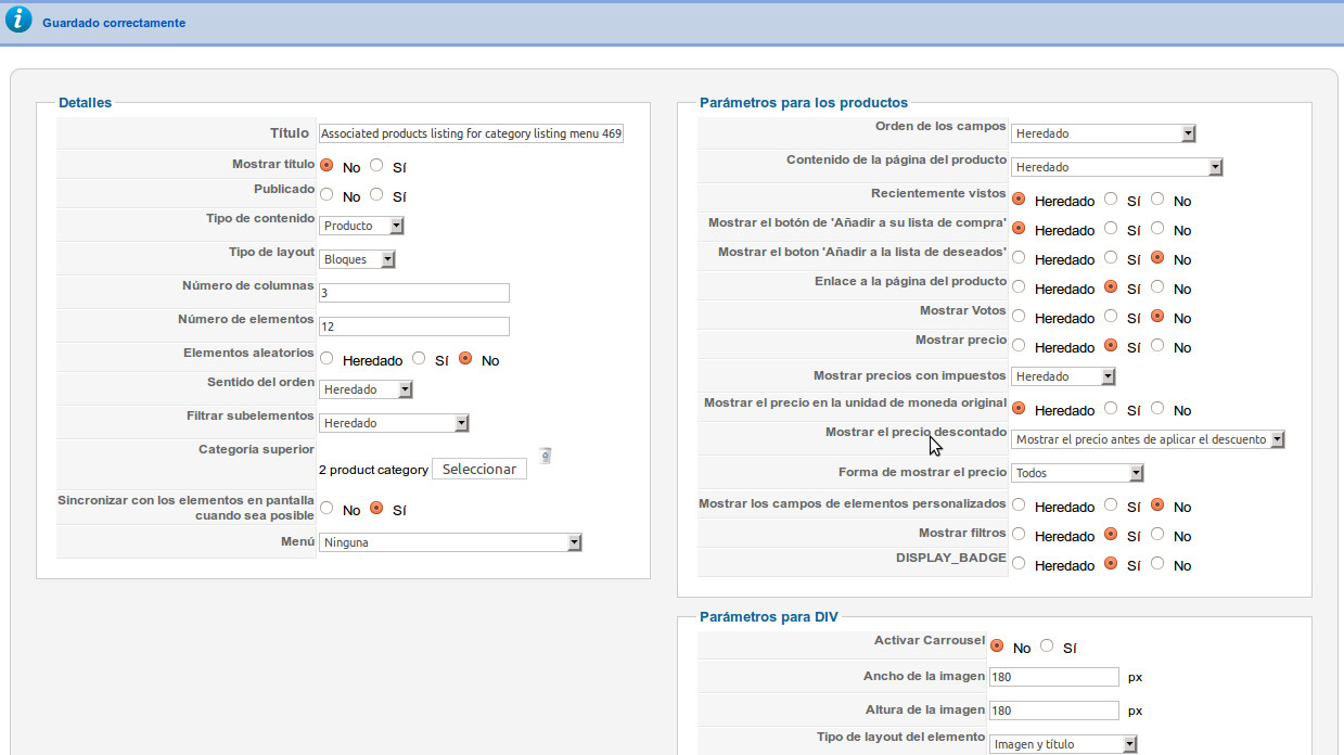

I am trying to show crossed price and discount price but I can't.
I have made a discount for a category (Alimentación->cacao 20%) but i can not see the discount and any crossed display.
We have hikashop business.
Also in system->configuration->products there is no option for discount in product show.
the url of the shop is www.tienda.tiendamundos.com/tiendamundos/es/
thanks

  • Posts: 15
13 years 2 months ago #108421
  • Posts: 86042
  • Thank you received: 14175
13 years 2 months ago #108570
The options you're editing seems to be the correct ones.
So it's like it's more a problem of the discount itself.
Can you try to remove the restrictions of the discounts to see if the prices/discounted prices display properly ?
  • Posts: 15
13 years 2 months ago #108604
Hi again
If I apply to a single product it works, but if apply to a category not works :(
