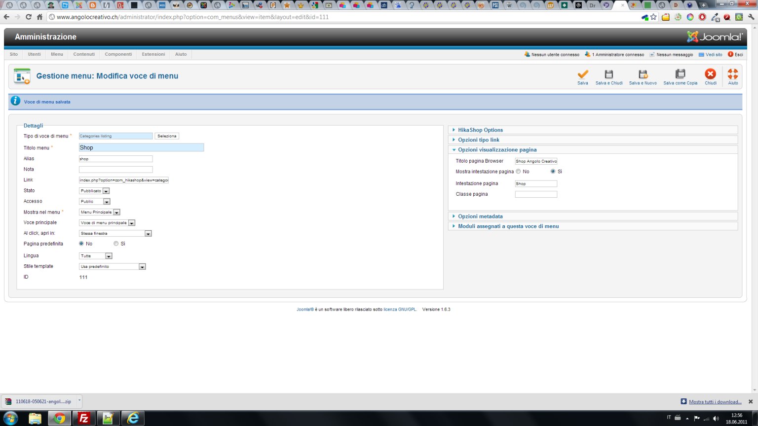

I would like that a title is shown when I am in the front-end shop page(I used the category listing in my case).
I checked the option to show the title in the Joomla menu's options.
I tried to check "yes" and "no" in the Hikashop menu's options to see if anything changes ("Use menu name instead of category name for title"..I read other topics in the forum regarding to it...).
But the title never shows.

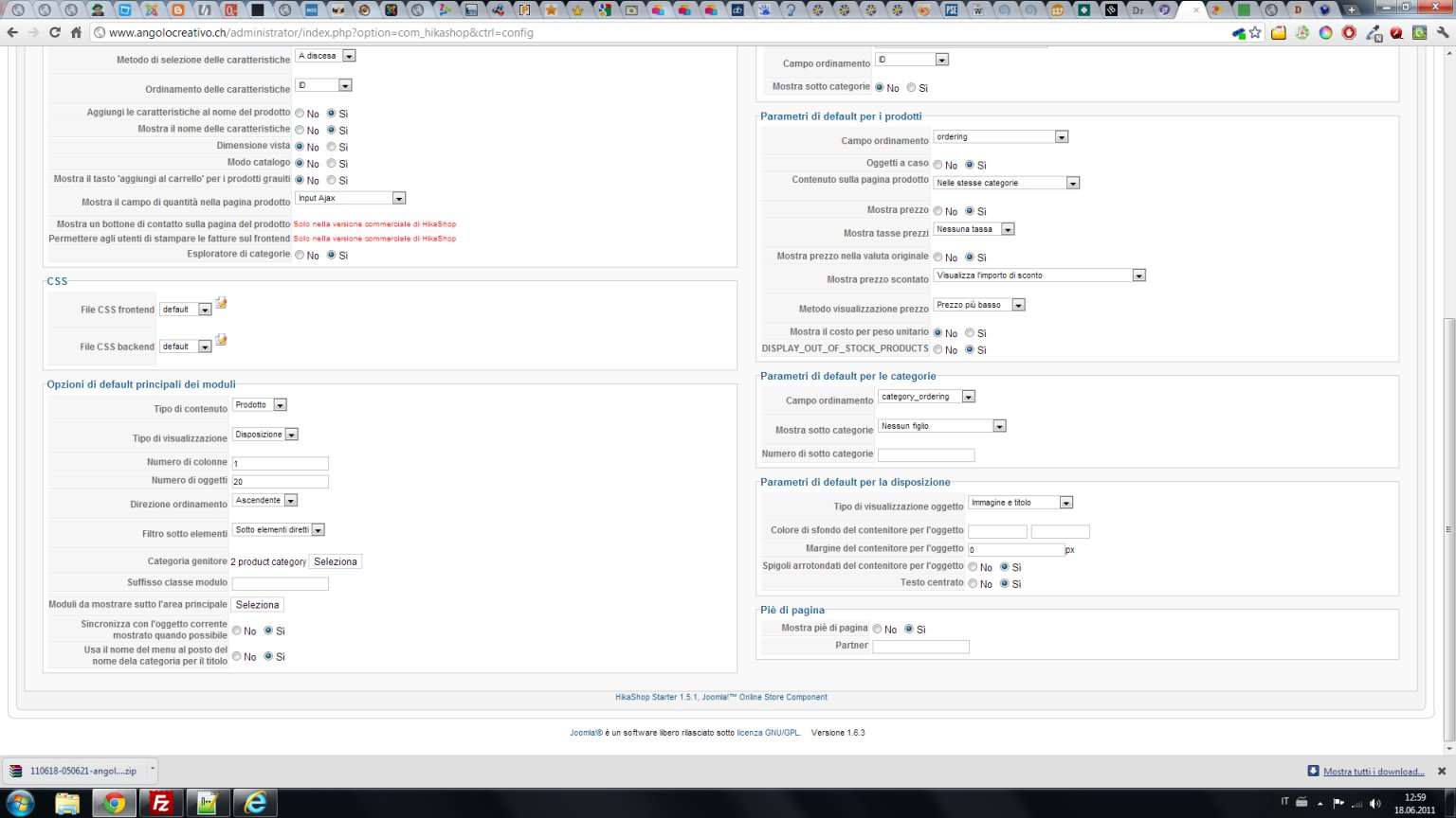

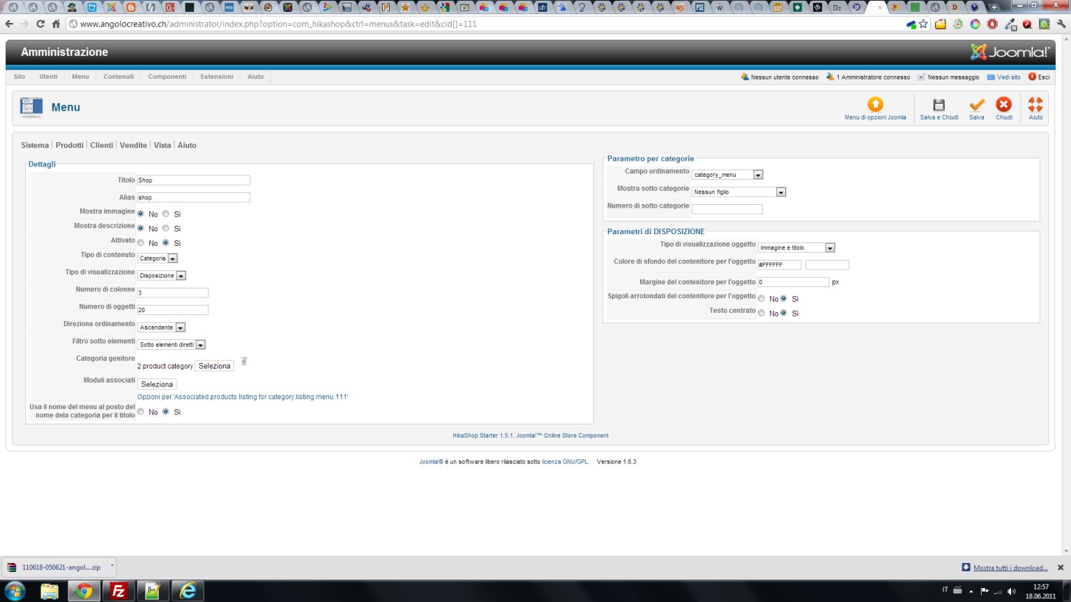

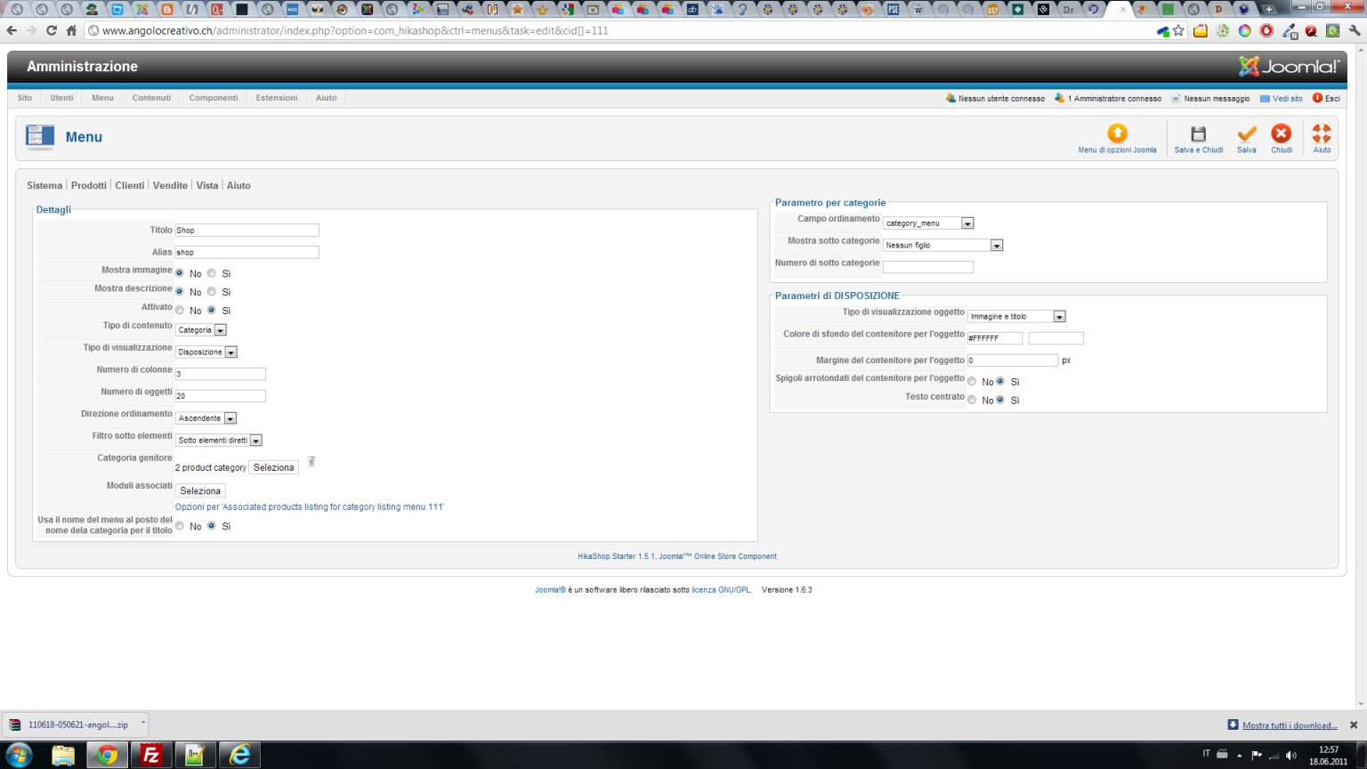

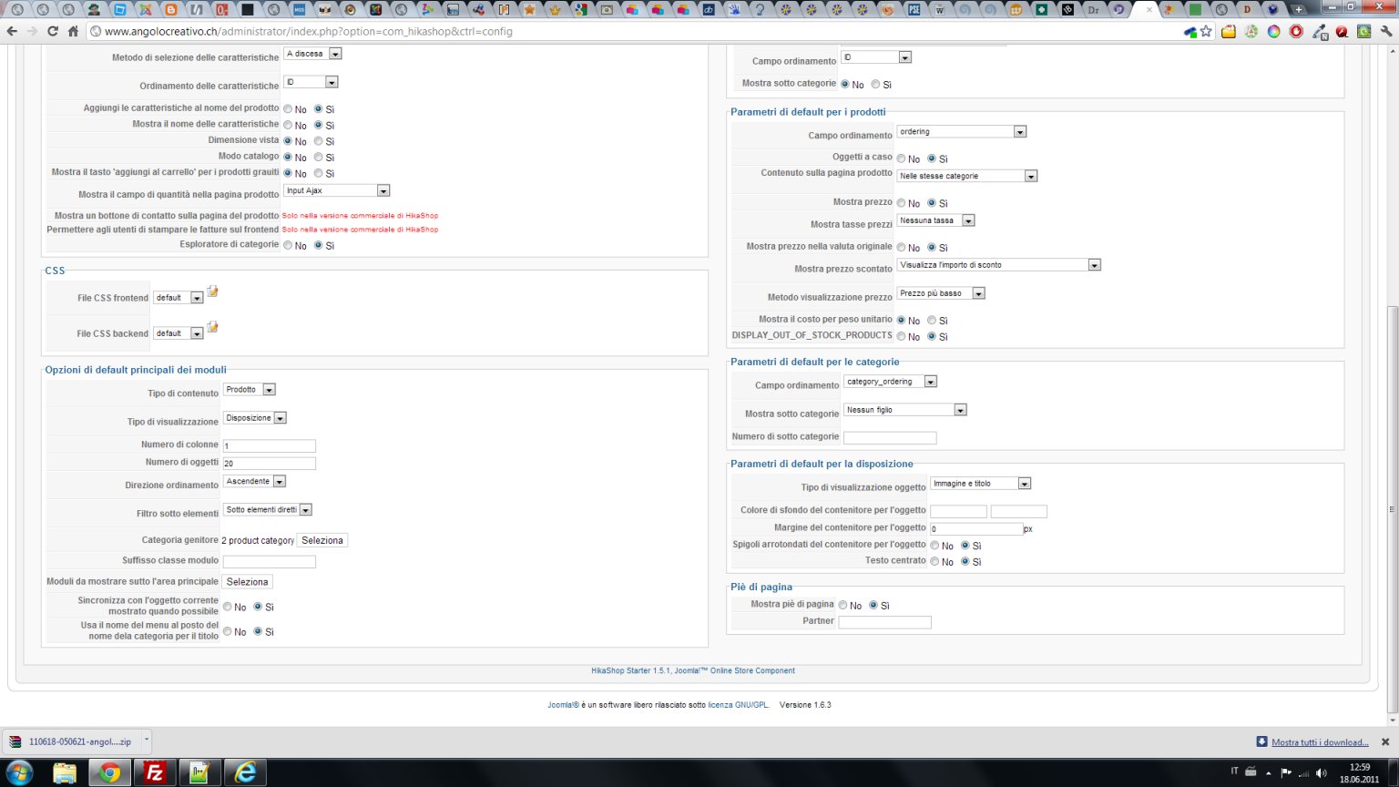

Could you do a screenshot of your shop menu options with the show title option activated ?
  • Posts: 55
15 years 1 month ago #19242
Here you have the screenshots
  • Posts: 55
15 years 1 month ago #19243
Last edit: 15 years 1 month ago by skatercorpse.
  • Posts: 55
15 years 1 month ago #19244
  • Posts: 86049
  • Thank you received: 14177
15 years 1 month ago #19251
Could you try to redownload and reinstall hikashop on your website just in case...You options are fine and it works with the same settings on our end...
