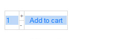

Is there a tutorial on how to insert an Add to Cart button in HikaShop?
Right now, I only have a link that displays "Add to Cart" as text. I know HTML and CSS pretty well, and I've already created the button I want to use. However, I'm unable to modify the product description's HTML using the toggle editor. Every time I change something it changes right back when I save.
Thanks for your help.

I don't have catalogue mode on, the product has a price, and the product quantity is unlimited. But I still don't have a button that looks like the regular one.
However, I changed the button style from "normal" to "CSS" and I now have a button that displays. It looks different from the gray one I usually see on other HikaShop Sites. But I think I like this one better.
Last edit: 15 years 1 month ago by bsmcgillis.

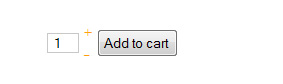

HikaShop displays the add to cart button with the default look like on your second image. However, it uses the CSS class "button" so that it adapts automatically to your template's CSS. If you see the button in blue, that's because your template CSS defined the button class like that. So if you want it to display normally, you should either:
change your template CSS to not change the button display style.
change the html of the button so that it doesn't use the button CSS class.
For option one, I can't help you as it depends on your template.
For option two, you can do that with a template override on the button display:
www.hikashop.com/support/documentation/6...tation.html#override
That way you won't loose your modifications. But if you're not a developer, that will be hard. So instead, you can just edit the file administrator/components/com_hikashop/helpers/cart.php and change the line:
$html= '<input type="submit" class="button hikashop_cart_input_button" name="'.$map.'" value="'.$name.'" '.$ajax.$options.'/>';
to:
$html= '<input type="submit" class="hikashop_cart_input_button" name="'.$map.'" value="'.$name.'" '.$ajax.$options.'/>';
