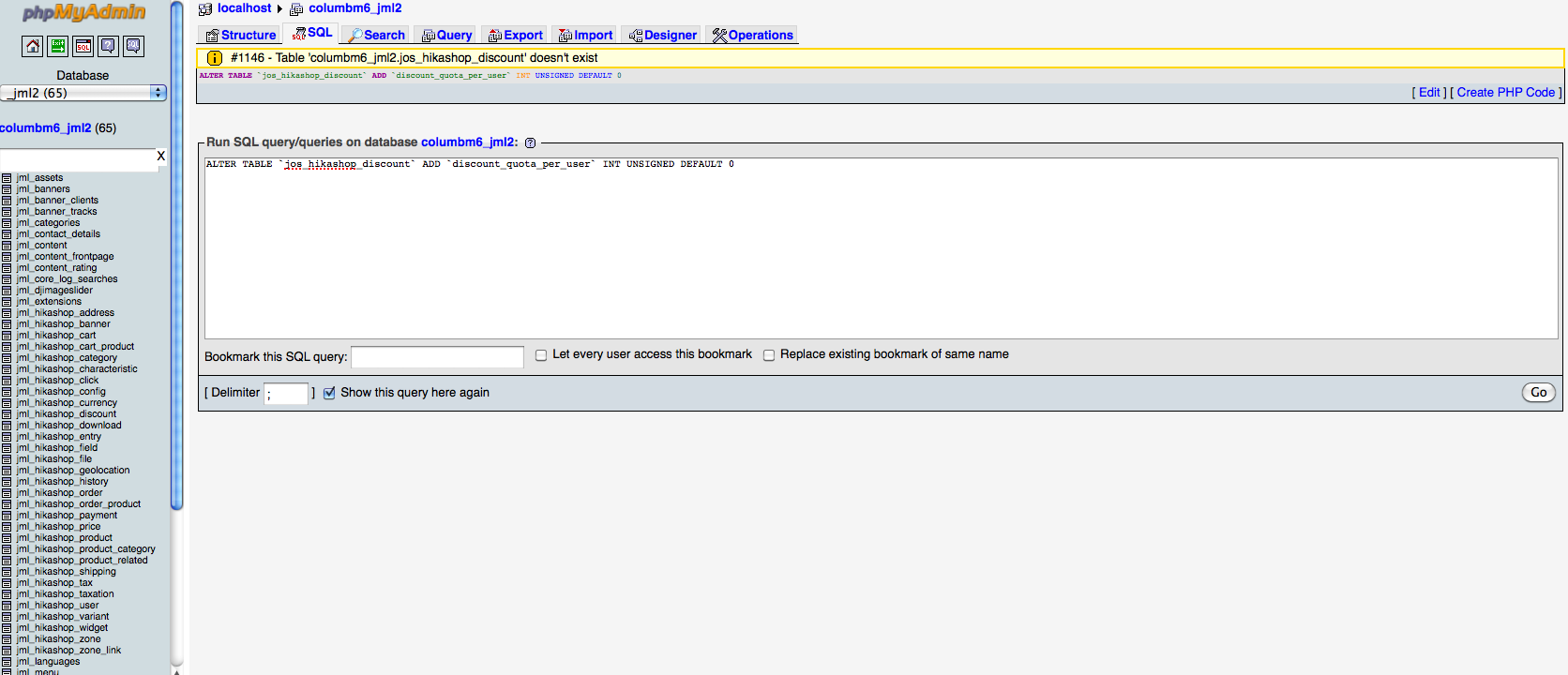

  • Posts: 35
15 years 1 month ago #19644
I get this error message. Should I change jos to jml? I wouldn't ask questions if I wasn't afraid of messing this up.. haha
thanks in advance.
  • Posts: 86049
  • Thank you received: 14177
15 years 1 month ago #19647
Indeed, you need to use jml instead of jos.
