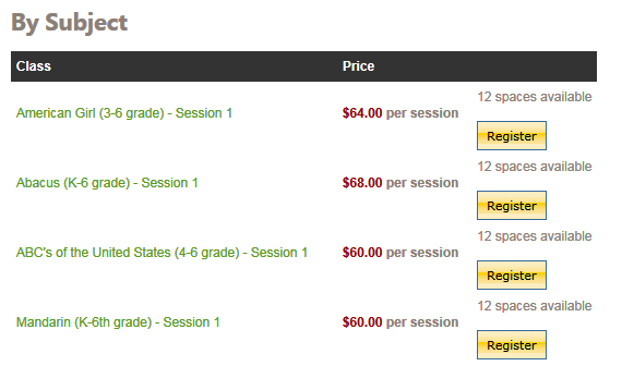

15 years 1 month ago #19717
I'm using Menu Item Type "products listing" showing "table" layout. Enclosed is what the page looks like. My queston is why is the table listing not showing up in one line. What I mean is why "12 spaces available" is showing up on the first line, and then description and the price and the "Register" button on a separate line (total 3 lines, instead of 1). I tried Display>View and looking at the PHP file for listing_table but I don't see anything that I can control the layout as described above.
Thanks,
-Jackson

15 years 1 month ago #19732
That's because there is a clear between the stock and the button. You should be able to have it all on one line with some CSS.
If you can give the link to that page we should be able to tell you what CSS to use.

  • Posts: 86049
  • Thank you received: 14177
15 years 1 month ago #19742
So, the right column is displayed by the quantity file of the view product. That same view file is also used to display the stock & button on the product page.
The two <br/> which make them display on two lines are in that code of the file:
echo '<span class="hikashop_product_stock_count">'.JText::sprintf('X_ITEMS_IN_STOCK',$this->row->product_quantity).'</span><br/>';
$config =& hikashop_config();
if($config->get('button_style','normal')=='css'){
echo '<br />';
If you remove the <br /> tags there, then you can just add some CSS:
.hikashop_product_add_to_cart_row{white-space:nowrap;}
and everything will be on one line on your listing.
However, the stock & button will also be on one line on the product page if you just remove the br tags. So instead you should have a check like that...:
if(JRequest::getVar('task')=='listing'){
//no br
}else{
//display br
  • Posts: 20
15 years 1 month ago #19743
Nicolas,
I can't find the info. you are describing in the "listing_table" view file. Which one should I use?
  • Posts: 86049
15 years 1 month ago #19745
it is not in the listing_table view file but in the quantity view file as I said in my previous post.
  • Posts: 20
15 years 1 month ago #19748
Awesome! It worked!

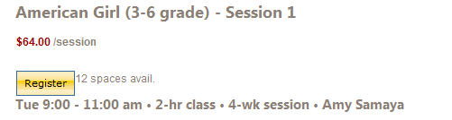

15 years 1 month ago #19825
Sorry to bother you again (I'm a novice of PHP). Now for the product page, I'm showing the price under the product name and then Register (add to cart) and then the availability quantity in a separate line (see attached).
I'd like to have the price, inventory, and then the Register (add to cart) all in one line.
For example,
$64.00 /session 12 spaces avail. [Register]
Instead of what's showing now. I know I need to change it at the "Quantity" view. Please advise.
  • Posts: 86049
15 years 1 month ago #19827

  • Posts: 86049
15 years 1 month ago #19832
You first need to edit the file show of the view product and remove the <br/> tag after the hikashop_product_price_main block.
Then you can add some CSS in your hikashop css file (via the interface in the Display tab of the config):
.hikashop_product_price_main, .hikashop_product_quantity_main {
display: inline-block;
.hikashop_product_stock_count{
float: left;
  • Posts: 20
15 years 1 month ago #19834
Awesome! It worked. The only thing now is that they are displaying too close to each other (no spaces). No big deal :)
