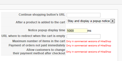

  • Posts: 7
14 years 11 months ago #20406
sure
the URl is:
www.intothewebportugal.com/
You can access the shop here:
www.intothewebportugal.com/index.php/sho...ing/cid-29/name-acer
The settins at this moment are equal to the image attached.

14 years 11 months ago #20409
The problem seems to come from your module mod_ppc_simple_spotlight which uses jquery and is apparently in conflict with the joomla mootools javascript library.
That is turns break the initialization of the popup.
If you disable that module it should work.
  • Posts: 7
14 years 11 months ago #20428
Yeah! True! Thank you very much!
