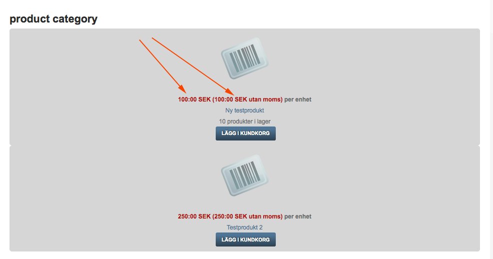

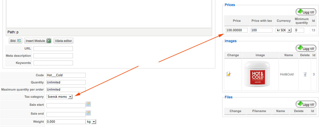

I think I have comfigured the tax correctly, see image
Still the price WITH tax will not show on fronend, image
How do I change this?

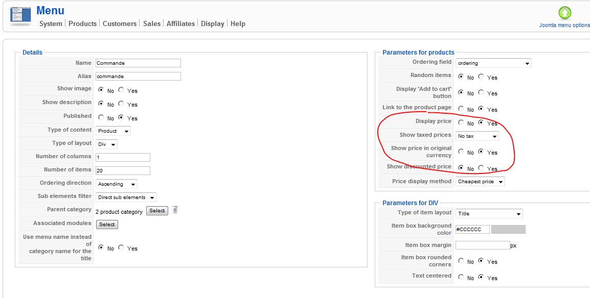

  • Posts: 39
15 years 8 months ago #2049
If you go in Hikashop menu ==> display ==> content menu you have an option to either :no tax, with tax and display both have you selected display both ?

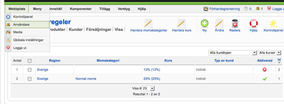

  • Posts: 86042
  • Thank you received: 14174
15 years 8 months ago #2100
I see that you limited the tax to individuals and to the zone sverige. On the main tab of the configuration, do you have the "Default address type" option set to individual ? Do you have the option "Main tax zone" set to sverige ?
  • Posts: 50
15 years 8 months ago #2101
Changes type of region and now it seams to work!

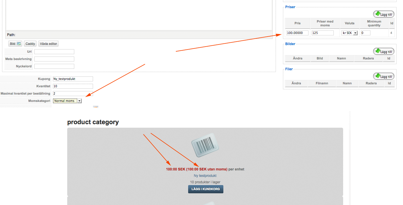

15 years 8 months ago #2123
OK. Here I am again. Had a crash on my site and had to start all over again.
And now I have the same problem. Tried to copy what I did last time. Price still only show (twice) before tax.
There must be some part of the tax handeling that I do not get. In how many paces do you have to set the tax - to get it right...?

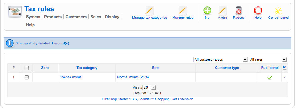

  • Posts: 50
15 years 8 months ago #2127
OK. So If I want to make it easy. The same tax for everyone. Where do I enter this?
  • Posts: 86042
15 years 8 months ago #2129
Create a new tax rule, select a tax rate and a tax category, and set it to published and leave the other fields to the default value and save it. There won't be any limitation on the zone nor on the customer type. You will just have to affect the tax category to the product for the rule to be applied to the product prices.
  • Posts: 50
15 years 8 months ago #2132
Done the first part. But the product still look the same. I will try to delete it and enter it again...
  • Posts: 50
15 years 8 months ago #2134
Tax not applied :(
Last edit: 15 years 8 months ago by weting.
  • Posts: 86042
15 years 8 months ago #2136
There is indeed a bug in the system when no zone is set in the tax rule.
We were able to replicate the problem on our end and fix.
Around line 145 of the file administrator/components/com_hikashop/classes/currency.php, if you replace the code
			$calculated[$key]=$tax;
		return $calculated[$key];
by the code
else{
					foreach($taxPlans as $taxPlan){
						if(empty($taxPlan->zone_namekey)){
							$tax = floatval(@$taxPlan->tax_rate);
that will fix the problem. We will add that correction to the next release we want to do today or tomorrow
