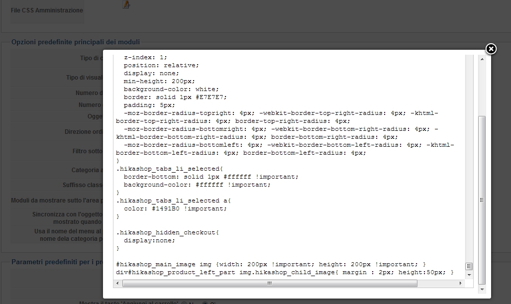

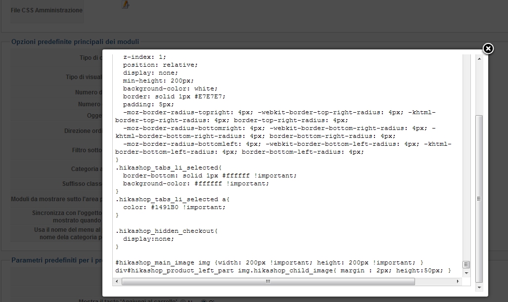

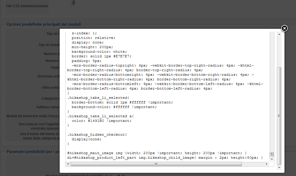

12 years 7 months ago #131170
Dear Nicolas,
I made several attempts to change product image size with no success.
Do you see something wrong in the last 2 rows of the attached image? (thumbs resize works but main product image doesn't...)
Claudio
If I add the following code:
.hikashop_product_main_image_thumb img{height: 200px!important;}
the image appears bigger but it overlaps thumbs and product description. The upper left corner of the image seems to be in a fixed position as the picture doesn't recenter after resizing.
Last edit: 12 years 7 months ago by tebba.
12 years 7 months ago #131198
The css seems to be correct.
Have you tried to simply change the values in Configuration > Main > Images ?
Thanks to follow that tutorial if the previous settings are not sufficient:
hikashop.com/support/153
  • Posts: 20
12 years 7 months ago #131200
<<Have you tried to simply change the values in Configuration > Main > Images ?>>
No.. and it solved the issue..... :unsure:
I get lost into so many menu...
thanks for your time

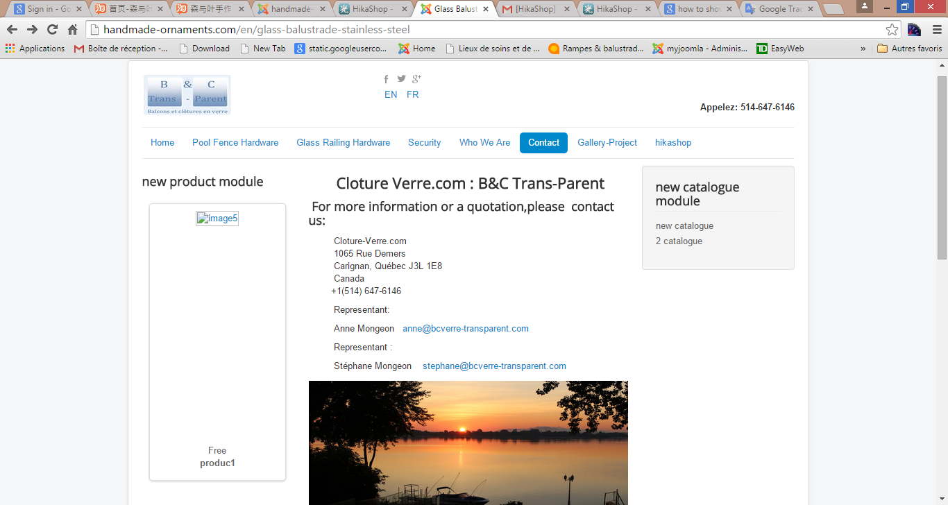

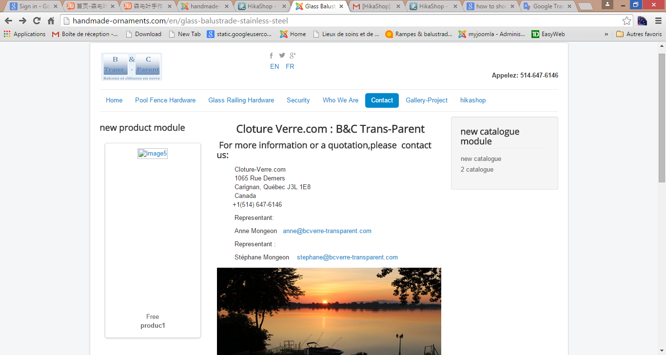

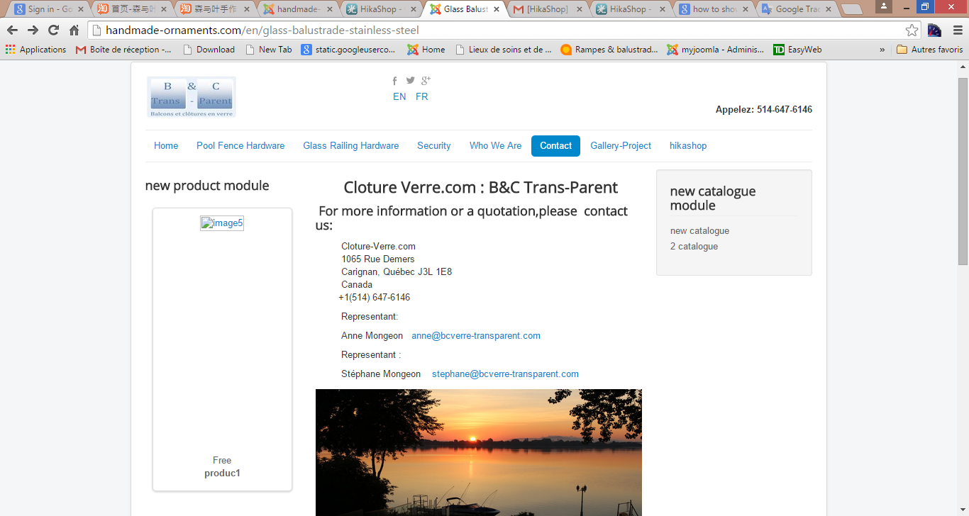

  • Posts: 7
10 years 11 months ago #207246
i am new here, can get my image appear? :silly:
many thanks

  • Posts: 7
10 years 11 months ago #207284
thank you for your reply, i can not get show even one image?
please see attached
many thanks
  • Posts: 85788
  • Thank you received: 14079
10 years 11 months ago #207319
I wanted to check your issue on your website with the link you provided but I don't see your left module anymore:
take.ms/M72gp
Also, you didn't provide the screenshots I asked for.
So I still can't say much in order to help you.
  • Posts: 7
10 years 11 months ago #207354
thank you Hikashop support
mistake from my site,
thank you for figure out my issue
I always hear good stuff about Hikasho
many thanks again
