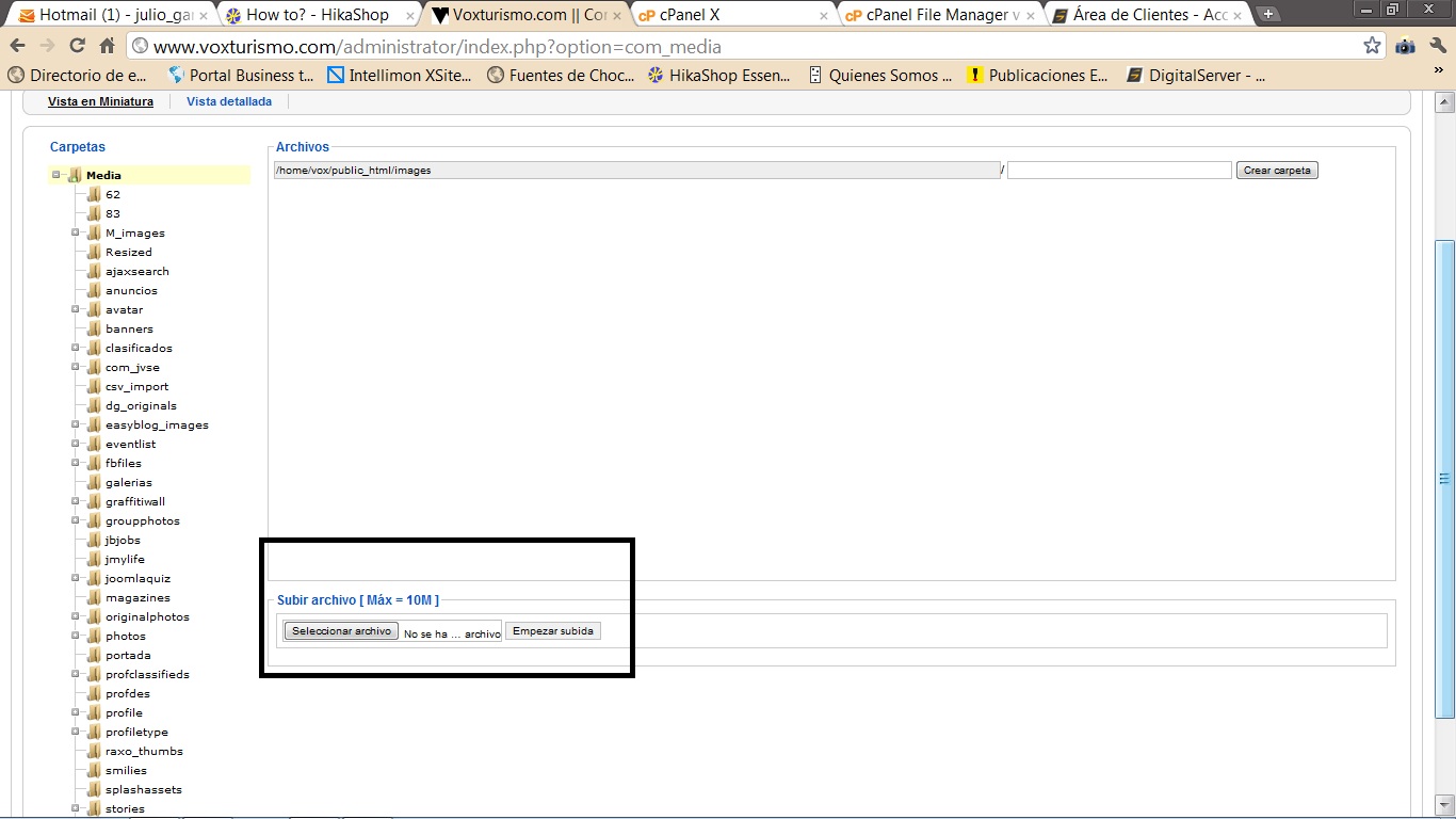

  • Posts: 19
14 years 8 months ago #27256
Thanks for your answer Nicolas.
I made any test and change the limit and I can see the joomla media center, the change is correct, I did change to 6, 8, 10MB and is correct but in HikaShop not change
I check in the php.ini and the php cpnfiguration into my root account and i have 10M but hikashop no change

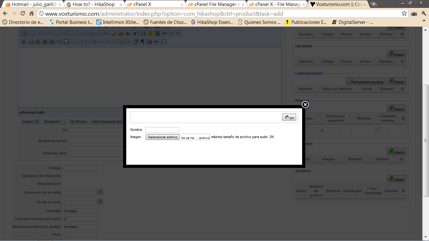

  • Posts: 19
14 years 8 months ago #27296
Hi, Nicolas
post_max_size = 16M
upload_max_filesize = 16M
this is my php.ini file
I send 2 screen in hikashop with 2M
Julio Cesar García
Voxturismo.com
  • Posts: 85794
  • Thank you received: 14085
14 years 8 months ago #27300
That message is displayed by the code:
<?php echo JText::sprintf('MAX_UPLOAD',(hikashop_bytes(ini_get('upload_max_filesize')) > hikashop_bytes(ini_get('post_max_size'))) ? ini_get('post_max_size') : ini_get('upload_max_filesize')); ?>
in the file "selectimage" of the view "product" that you can edit via the menu Display->Views in HikaShop.
As you can set, HikaShop just displays the biggest value between post_max_size and upload_max_filesize which are returned by PHP.
If you want, you can remove that line and not have that message, you can put another message also. But that won't change the upload limit of your server.
Again, this is just something displayed by HikaShop so that you know the upload limit of your server. Whether you display that message or not, the limit is the same, for any component.
