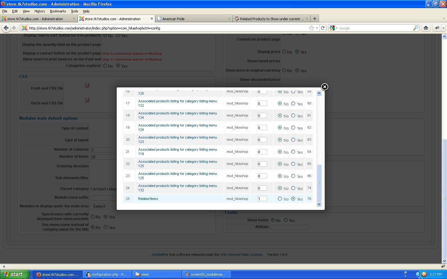

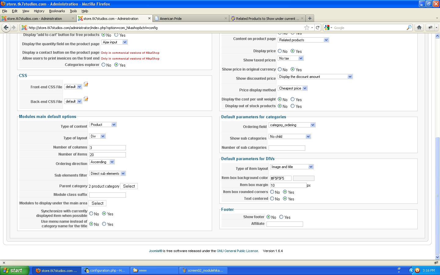

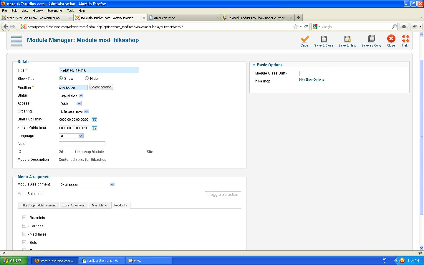

Okey so having problems getting related products to display.

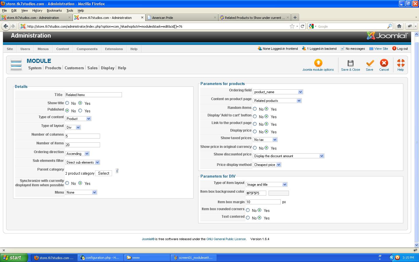

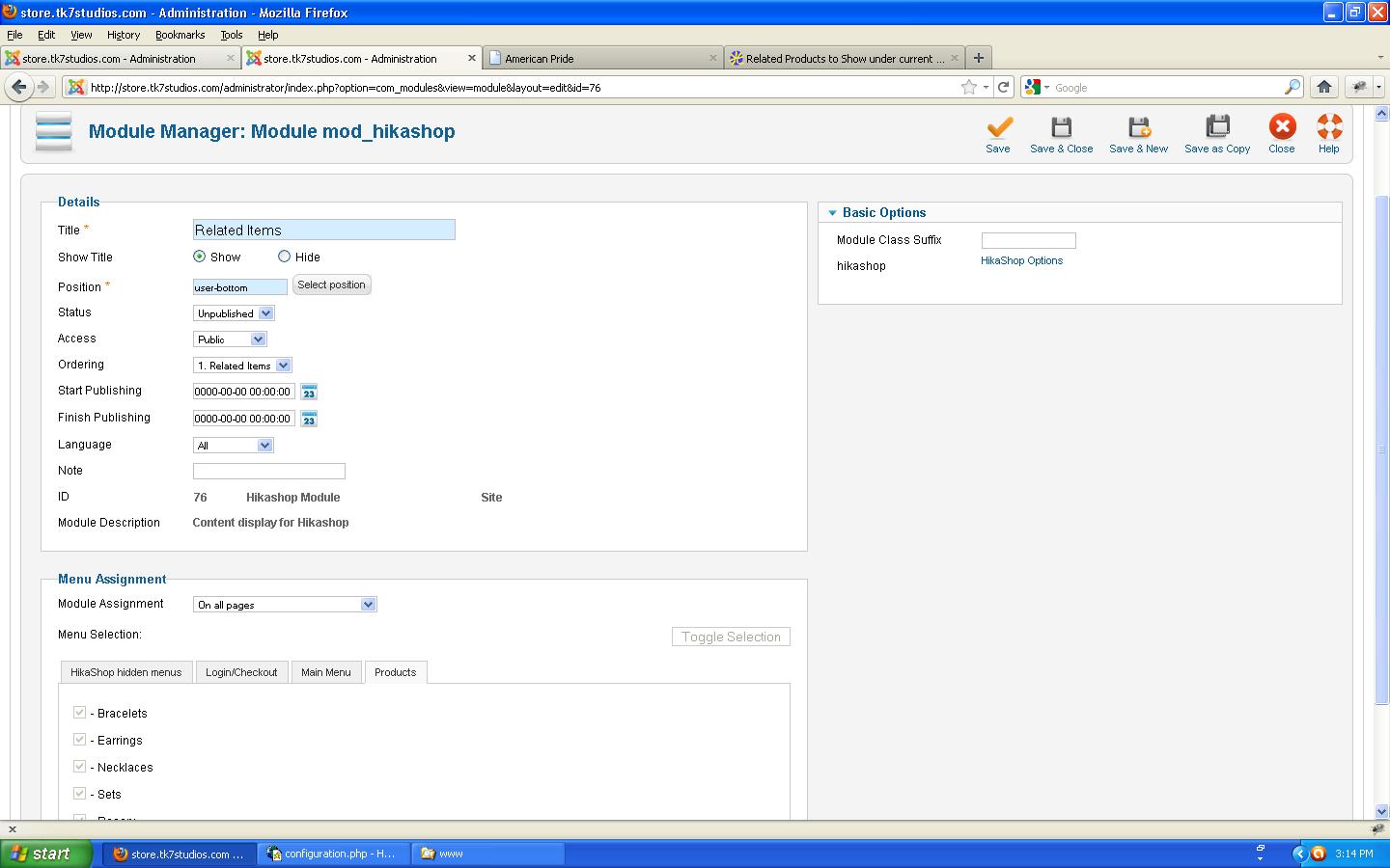

Step 1: Create the related products module
Joomla settings
Hika Settings

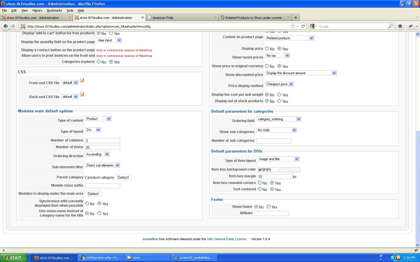

Step #2: Associate the module with hikashop configuration->display
It will only display if it's published which puts on every page, not just the product page.
What am I missing?

The problem is that you published your related module in the "modules under the main area" option of the "modules main default options". Adding it there does not add anything to the product page but means that your module will be attached automatically to your menus when creating new ones.
The option where you want to publish your related module is called "Modules under the product page" and is located in the "General display options" area of that same screen.

14 years 11 months ago #20782
got it, thank you!
