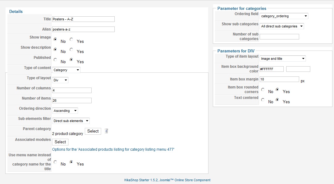

Could you do a screenshot of the menu's hikashop options ?
  • Posts: 51
14 years 11 months ago #20947
as requested...
  • Posts: 85792
  • Thank you received: 14084
14 years 11 months ago #20956
It seems to be setup properly.

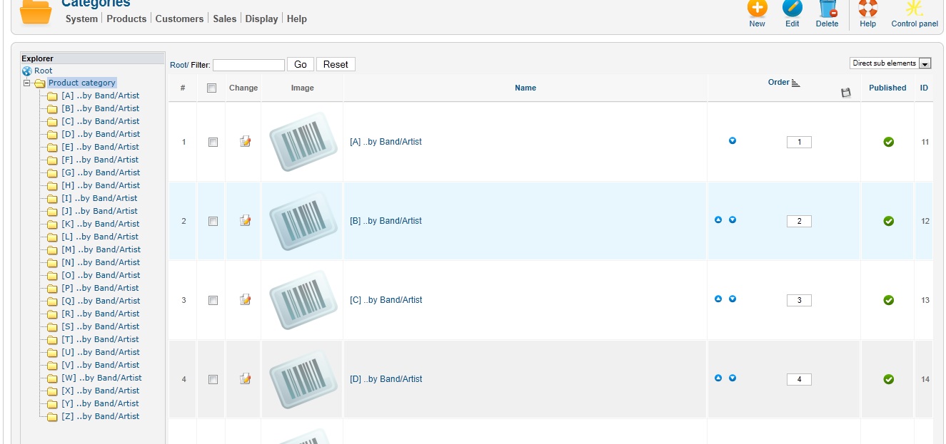

  • Posts: 51
14 years 11 months ago #20960
categories I'm trying to show...
