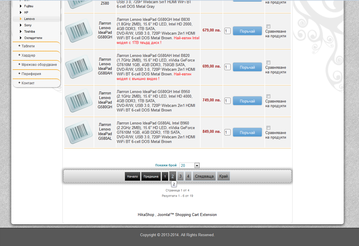

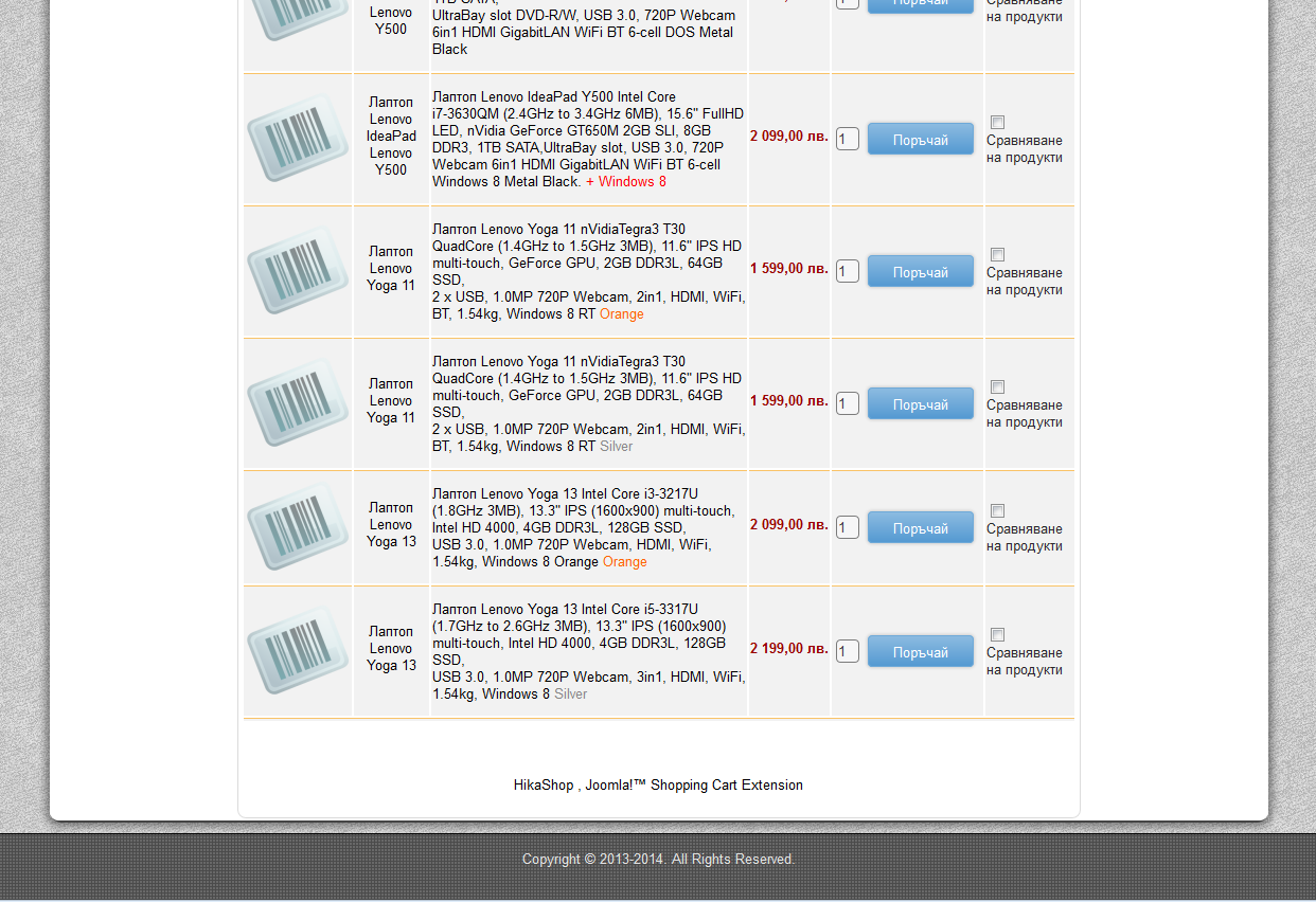

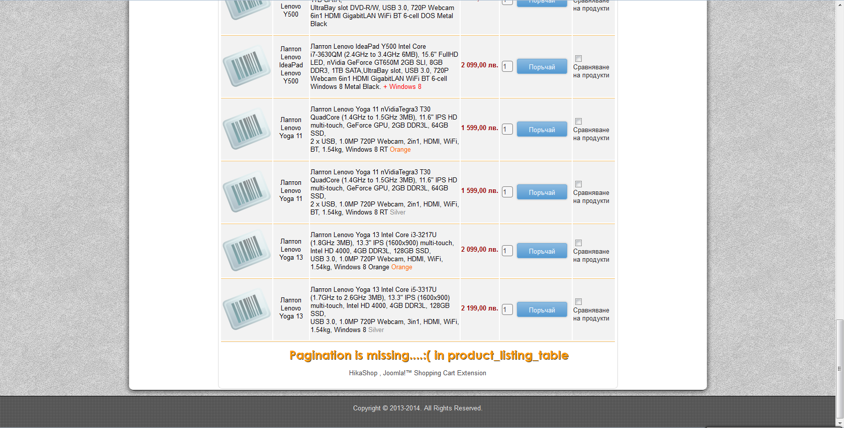

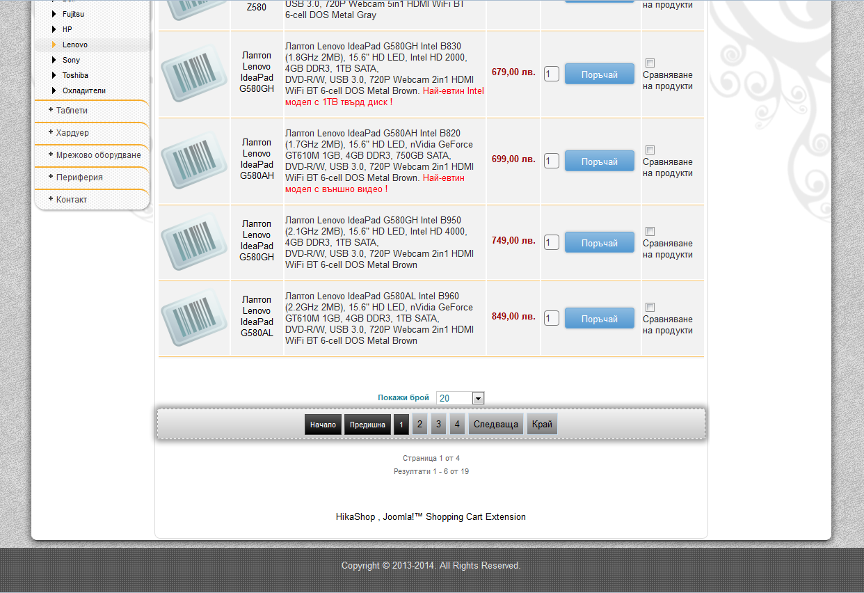

  • Posts: 16
13 years 5 months ago #88053
Hi Nicolas :)
I have a little problem. After change in product_listing_table pagination on bottom side miss.
Please help me :)

  • Posts: 16
13 years 5 months ago #88104
No, pagination parts is not removed. But I noticed something, when i enter the category pagination is ok. But when i push some button in pagination, for example 2. After then pagination block disappears and open all count of products. See the pictures :)
Thgis is my php code from product_listing_table
