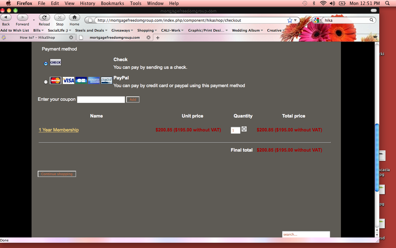

We are trying to implement a 3% processing fee for all products that we sell.
Since there is not a system designed to that yet with your program. I am using the tax as my alternative however need it to now state tax on the website but instead to either not say anything or to say processing fee.
Is there a way to change this "VAT Tax" verbiage within the database? If so does someone know how to do help me change this?

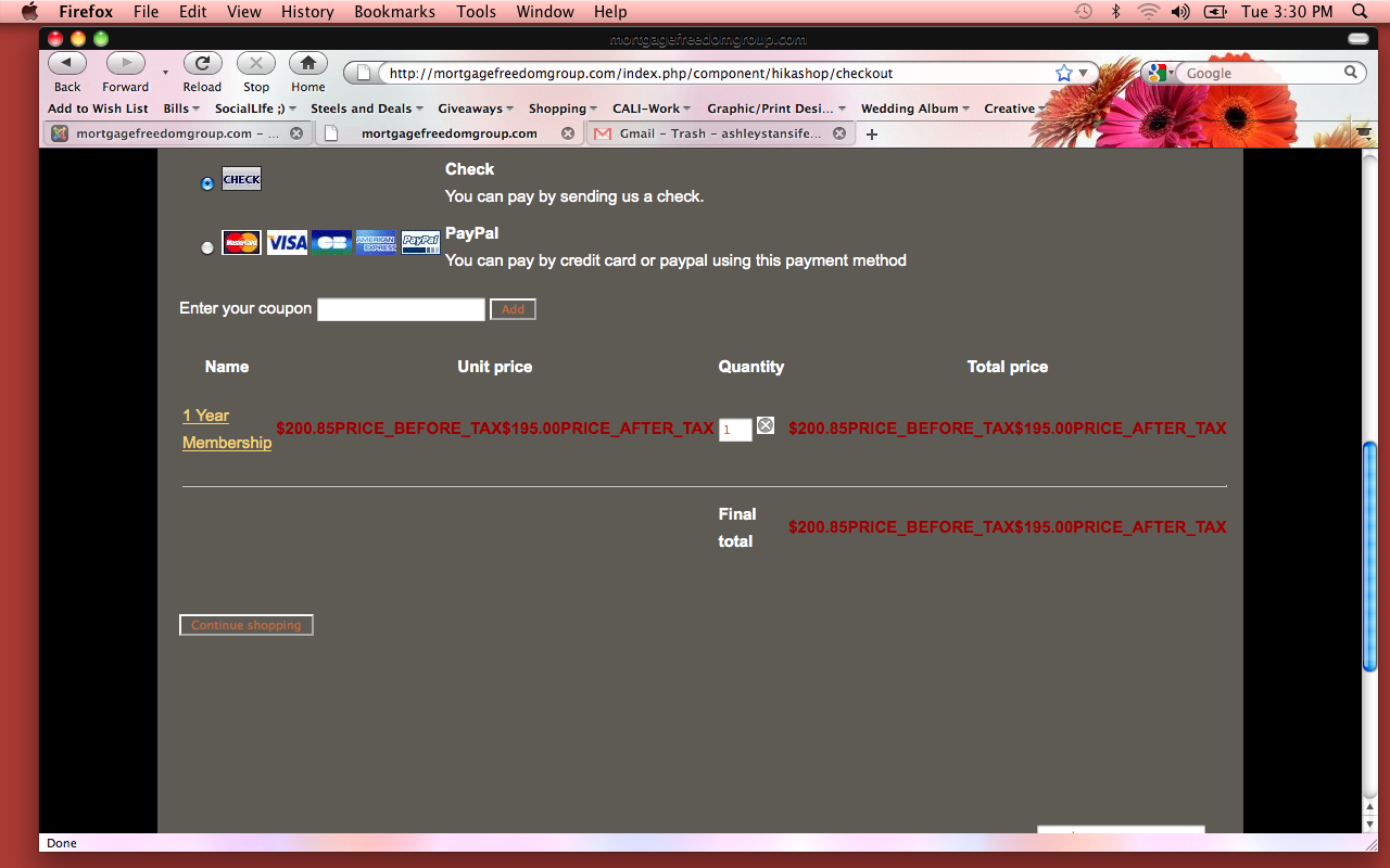

ok I have done this however now on the front end this is coming up and I dont know how to change it.
see Picture

That happens because you removed the lines PRICE_BEFORE_TAX and PRICE_AFTER_TAX from your translation file or you didn't define them proprly. You need to fix your translation file.
