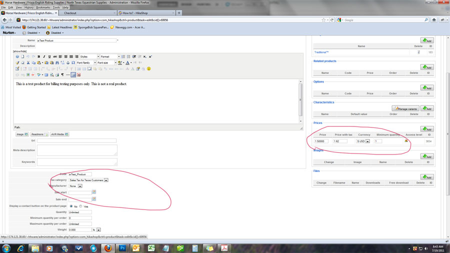

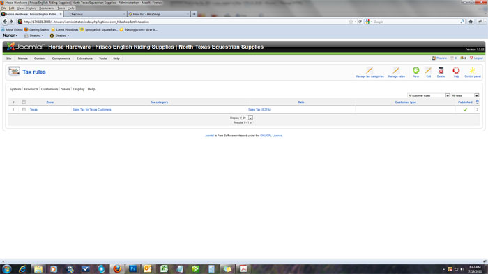

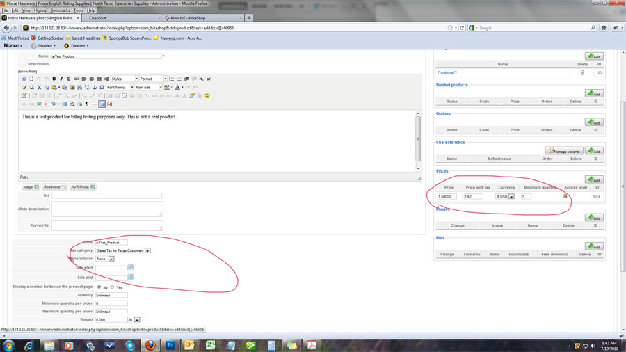

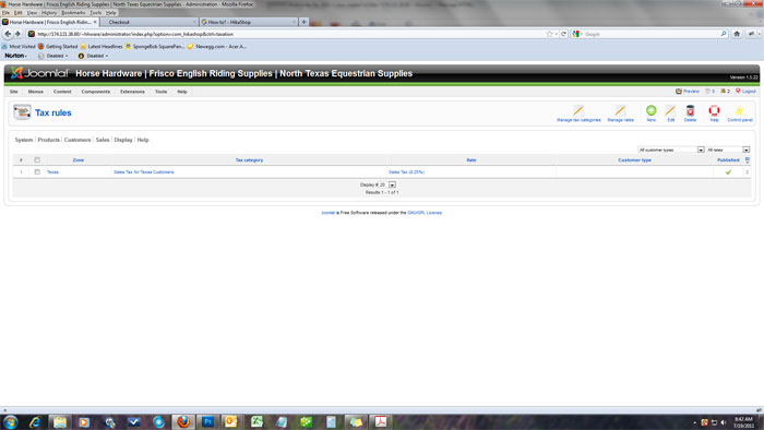

  • Posts: 82
14 years 11 months ago #21555
I changed the total so that tax would compute at a higher rate.
The order notification is NOT including tax. The Paypal is NOT charging tax. Tax was shown in checkout ....but now it's not. Attached is the screen shot of the product and the tax configuration.

14 years 11 months ago #21561
Please provide the URL of the shop so that we can see the problem. As I said in my previous message we've never heard of such problem whereby paypal wouldn't charge you the VAT so we'll need to first confirm the problem and then trace it if there is indeed a bug.
If no VAT is charged and not vat is in the order, it's normal that you don't see it in the emails.
There are several text strings where the word VAT is used in the language file. You need to override all of them.

14 years 11 months ago #21603
Once I'm logged in on your checkout, I don't see the taxes but I see them before being logged in. That means that the problem is that your tax rules are not configured properly and do not tax my address, that's all. And it's normal that you don't see the taxes in paypal and in the email/order, since you don't even see them on the checkout once you enter your address.
I went on your back end to look at your tax setup. You have two texas states in your zones. The zones with the id 4000 and 4307.
The one you set in your tax rule is the zone 4000. However, the one you have attached as a subzone in the USA country zone is 4307. So that means that your customers will select the 4307 one while the tax will only be applied with the address is in the zone 4000, which is not possible since that zone cannot be selected.
So you just have to edit your tax rule and change the zone to the 4307 one and it will work: taxes will be applied for customers with an address in texas.
  • Posts: 82
14 years 11 months ago #21614
That did it! It was driving me bonkers!
