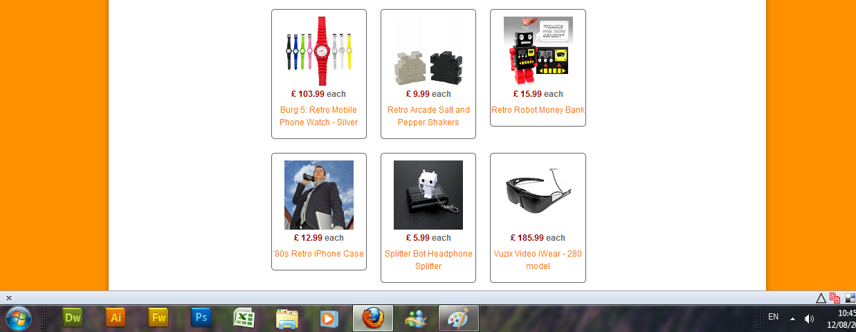

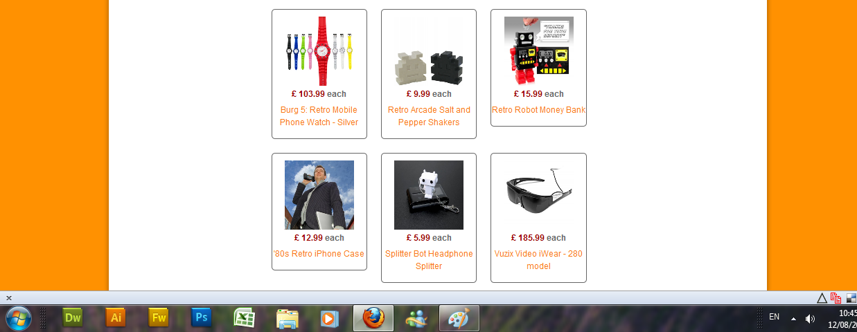

Hello all,
as you can see from the example above my gallery items have different size (the items with bigger description are bigger than the ones with smaller description). Is there any way I can make so all the items have the same size (the smaller gets bigger to match the other)

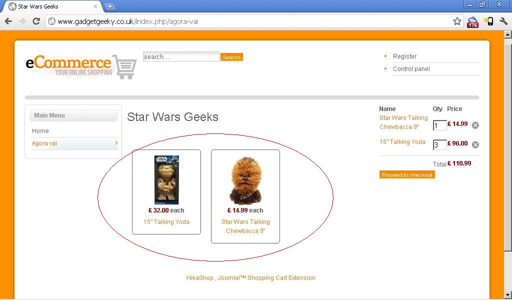

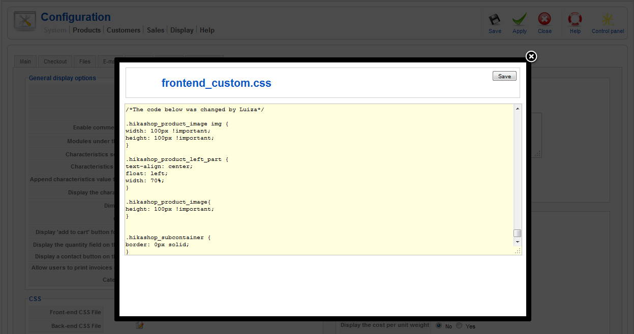

15 years 3 days ago #23452

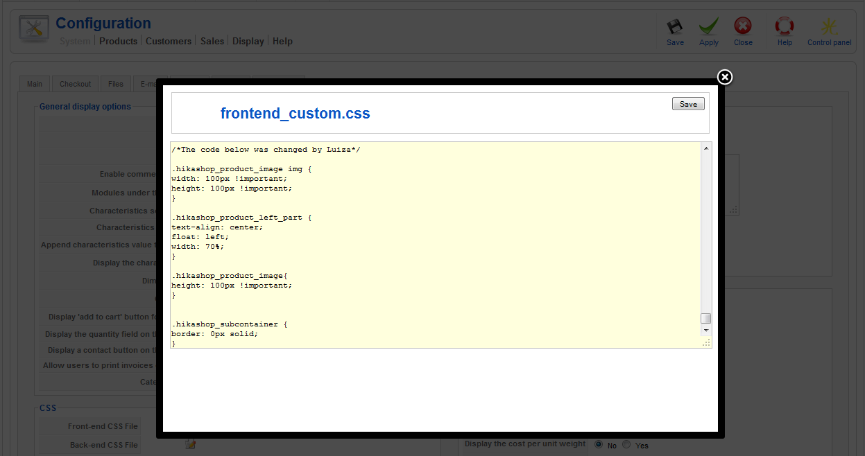

I am not sure what I am doing then.. Please find bellow print screen of the altered css and of the website, the black border just wont go away :( I am aware that I need to save the css then apply and save as I've changed the css before but not sure if I am putting the wrong rule or why, it just doesn't work...

You should try with a !important like that:
.hikashop_subcontainer {
border: 0px solid !important;

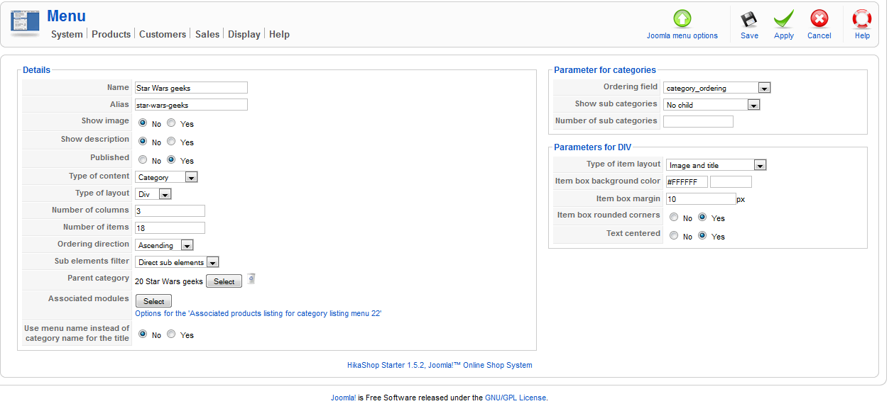

Also, note that if you have the latest version, there is now an option for the border in modules/menus' hikashop options. So you could just turn off that option and the border would disappear.
  • Posts: 66
15 years 3 days ago #23470
Hi, I've changed the css to put the important but it is still not working :( don't know what I am doing wrong... when you say I can change it on Hika Shop option, I've been to it but the only option there is the margin not the border... any ideas what else could be done??

hah, it was a very simple thing a very common mistake, I just forgot to clean the cache oon my browser, I just did and it works fine :D thanks
