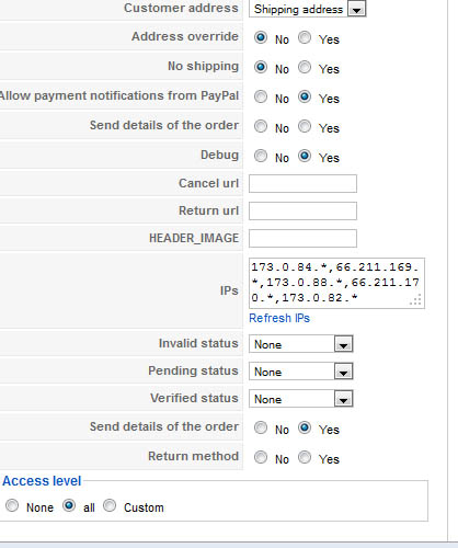

I noticed the paypal-plugin has two check-boxes for "send details of the order", is this correct? Might this cause the problem?

We don't have twice that option. Could you do a screenshot ?

14 years 10 months ago #23050
  • Posts: 85792
  • Thank you received: 14085
14 years 10 months ago #23063
Thanks. I looked at the code on our end and we indeed have the option twice. It's just a wrong copy/paste. But there is no consequences for the paypal plugin.

One quirk I've noticed is that no matter how many times I set it, the top "Send details of the order" selection is unset (no radio button selected) again upon return to the page.

The "Send details of the order" option has been fixed in the new version of HikaShop.
