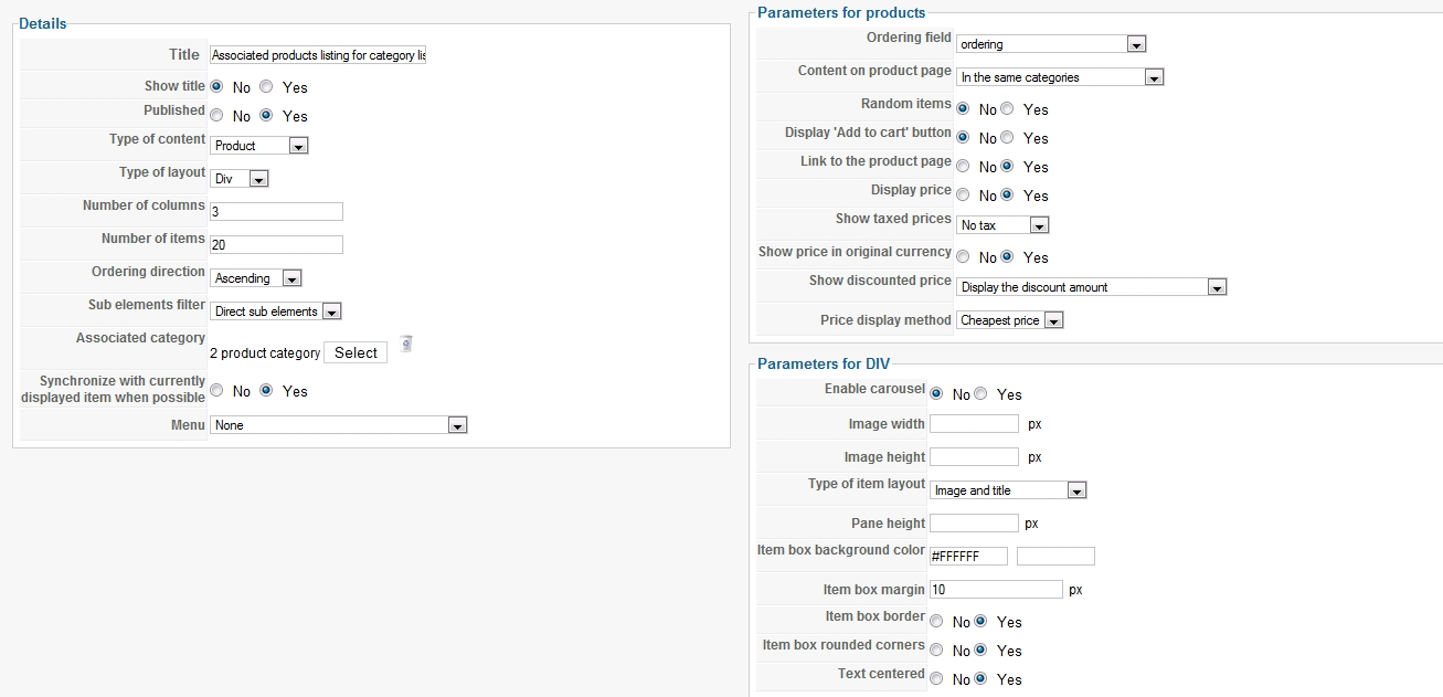

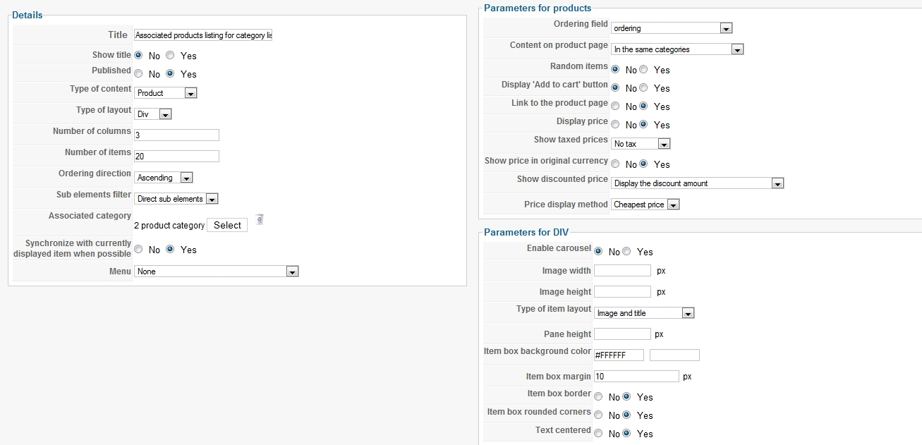

The problem comes from the way you configured the hikashop options of the module with the id 146. Could you do a screenshot of the hikashop options of that module ?

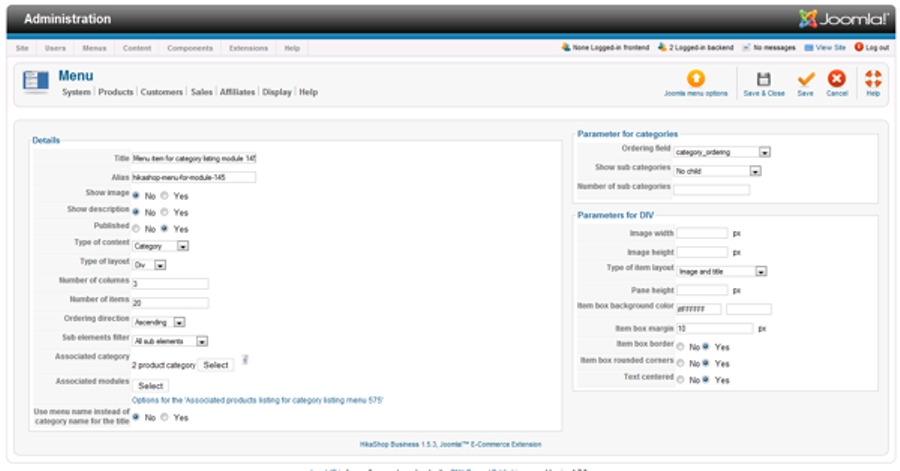

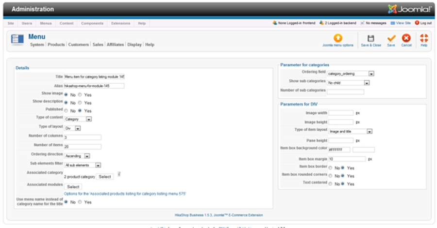

  • Posts: 12
14 years 10 months ago #25796
here it is

14 years 10 months ago #25798
That's a menu's hikashop options, not the hikashop options of the module with the id 146
  • Posts: 12
14 years 10 months ago #25801
i thinks this should do

14 years 10 months ago #25803
In the option "menu" of that page, you need to select a hikashop category listing menu so that it works properly with SEF.
