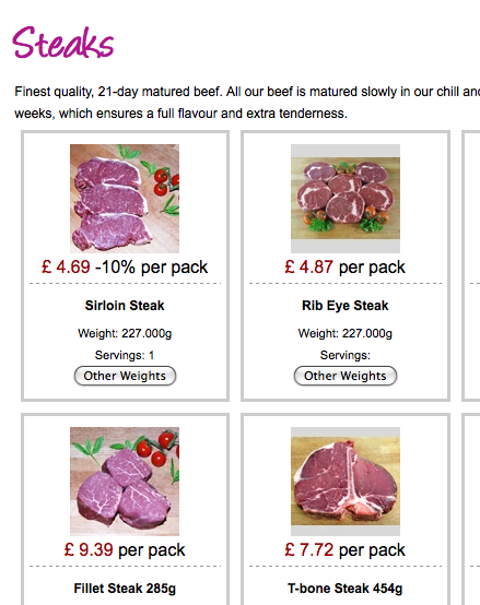

I've added the weight of the product to the front end view for each product, however, I have a couple of questions:
1. I want to have 227 rather than 227.000 - how do remove the decimal point?
2. I want to add the measurement symbol so it will be 227g - what's the PHP code needed to call this, for example: <?php echo $this->row->XXXXXXXXXX;?>?
3. I've managed to edit the front page module to display the weight (product / listing_img_title.php), however I have lots of menus that display product listings - which file do I need to edit to include this?

1. You can do like that: www.hikashop.com/fr/support/forum/4-how-...-decimals.html#19315
2. $this->row->product_weight_unit
3. All the listings of products, be it modules or menus, are displayed with the same view files.

I changed them in show.php for both my templates - see attached.
Any ideas?

The show file is for the product page, not products listings. Your screenshot is a the products listing.
You need to use round($this->row->product_weight,0) in your listing_img_title file
