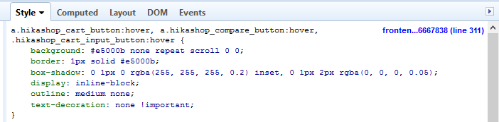

  • Posts: 101
  • Thank you received: 8
10 years 3 months ago #231520
@serbofleconcepts
I think you find it arround line 311 in the frontend.css file

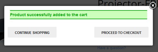

  • Posts: 158
  • Thank you received: 5
9 years 8 months ago #252473
OK, I disabled the pop notice for a while but now I want to add it back, so I'm back on the case with this. I've tried changing a lot of fields in the hikashop.css file (I'd prefer to edit this file via FTP as it allows me to store backups of different versions).
All I'm trying to do it to change the current red background (on hover) on the 2 lower fields to blue (#ccc)
This is the part of the hikashop.css file I've been editing;
I added the background-colour css - is this correct as it's not working for me.
  • Posts: 85786
  • Thank you received: 14079
9 years 8 months ago #252478
The CSS of the buttons usually comes from the Joomla template.
So it might be something to change in the template.
Could you provide a link to that page ?

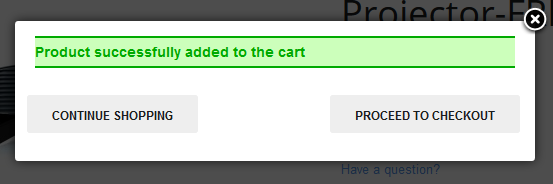

  • Posts: 158
9 years 8 months ago #252644
Just buy any product on leconcepts.com and the popup will appear.
Thank you.
9 years 8 months ago #252652
Note that we won't be able to correctly check your popup code if you don't increase the value of the "Notice popup display time" option via "Hikashop->System->Configuration->Main".

  • Posts: 85786
9 years 8 months ago #252770
As expected, the red color on the buttons when you hover on them comes from the file www.leconcepts.com/templates/gk_storefro...s/hikashop_frame.css of your template.
I would suggest to contact your template provider so that they can provide their recommended solution to change that color.
