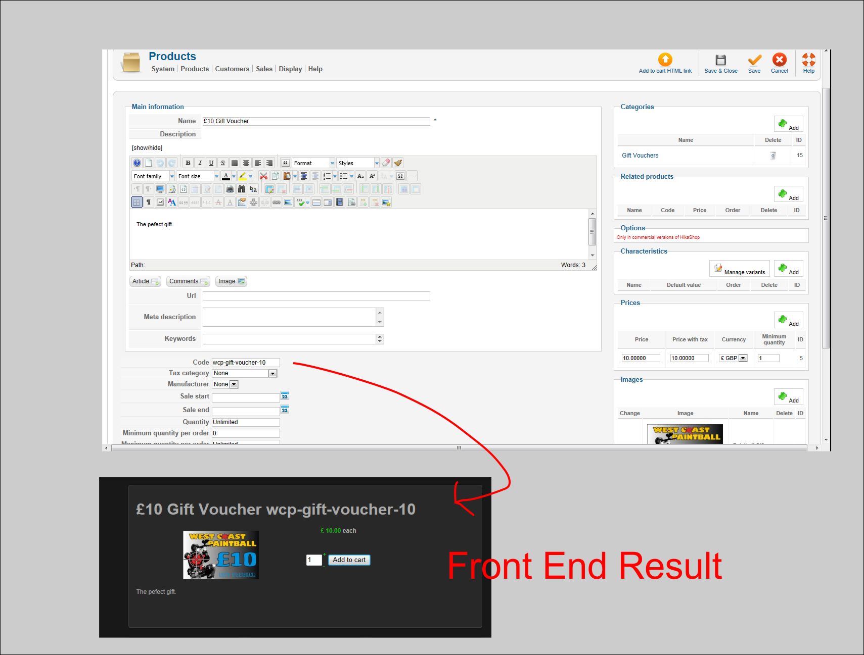

Hello
On the front end on my site, when viewing a product is displays the Product Code beside the product title. How can I remove the Product code from the front end?
See Jpeg example.

14 years 11 months ago #26518
It's probably because of your template:
www.hikashop.com/en/support/forum/4-how-...de-in-the-title.html
By default, the product code should not be displayed on that page unless you changed the CSS to display it.

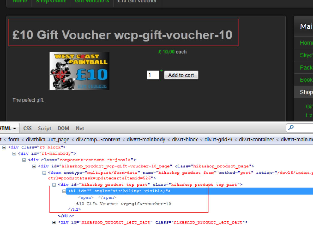

As editing code is beyond me - I asked my brother to have a look, he did, but could not get it to work. He went on to write the below message.
"Somewhere between the JavaScript from the hikashop, and the JavaScript from the site templates there appears to be a conflict.
The source code shows the heading 1 with the correct span tags nested inside. See screenshot: ‘source.png’.
However when viewed from the front end this breaks as shown in the second screenshot ‘rendered source.png’. As this screen grab shows, the spans within are either removed or closed prematurely – looks like classes/ids are removed to.
When JavaScript was switched off the page rendered as expected (although to show the site the wrapper div needed edited with Firebug to set opacity to 1 – for some reason this defaults to 0 meaning that nothing is visible when JavaScript is disabled)."

It's not a problem in HikaShop. The problem comes from the js of your template for the spans processing which breaks the HTML of HikaShop. Because of that, the CSS is not applied properly and thus the product code is displayed.
The modification I proposed above will do the trick by not displaying the product code at all.
If it didn't work it's probably because you didn't do the modification for the correct template.
You don't need to know PHP for that change. You just need to find the piece of code I pasted in my previous post in the file I mentioned and remove it.
