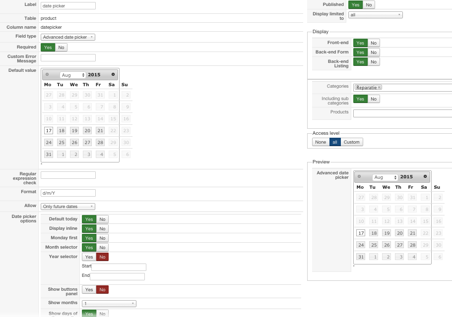

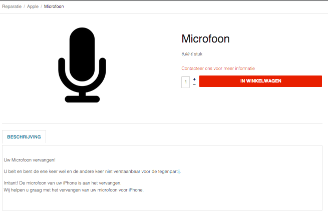

Dear customer,
I red a lot about this issue, but there is something i don't get.

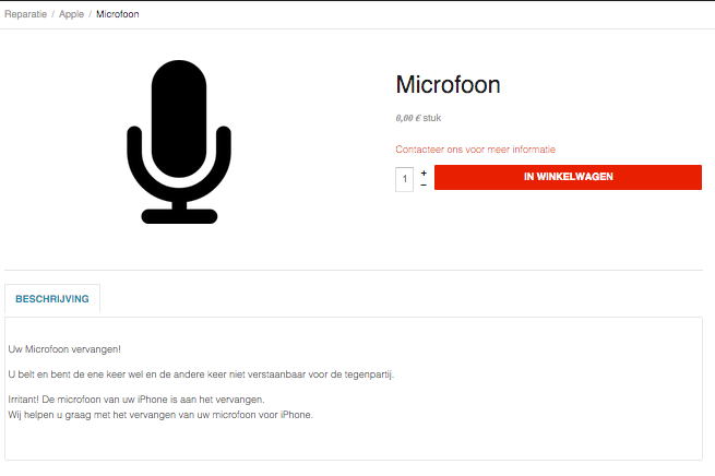

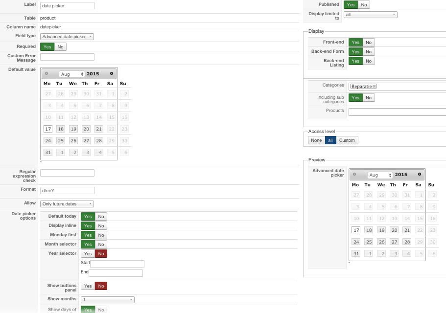

I created a date picker like:
but now i want to add this picker to the products of the category "reparatie".
What do you i have to do to see the date picker in:
extra info:
Most recent version of hikashop business (rsgsm.nl)
Last edit: 10 years 11 months ago by Ziggy.
  • Posts: 86042
  • Thank you received: 14174
10 years 11 months ago #211579
You created a custom field of the table "product" and that will display the field when you edit your product.
If you want to display the field when the customer displays the product page, you instead need to create a custom field of the table "item" via the menu Display>Custom fields.
The following user(s) said Thank You: Ziggy

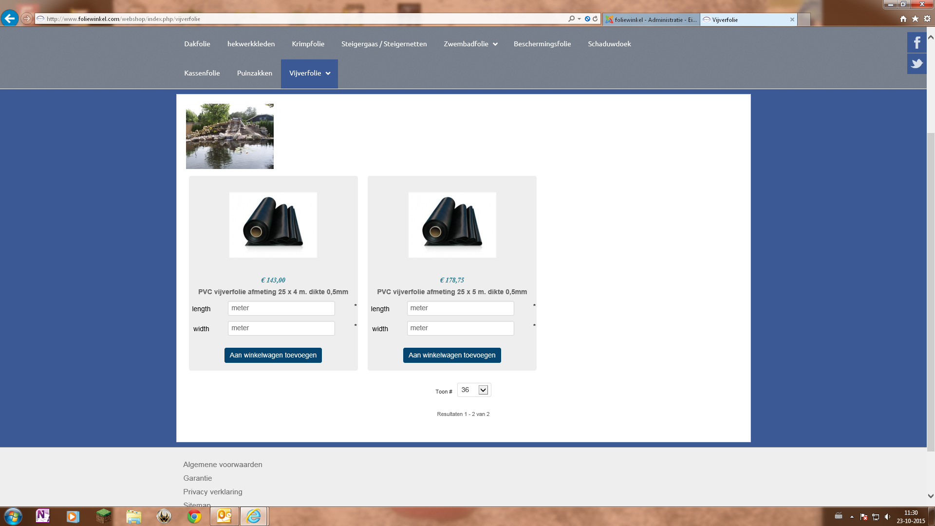

Hello, i read all this topics, but find no answer for my own problem.
I want to have 3 fields so that customers can put in a value.
Like this length x width = total dimension
The last field (total dimension) as an example 10m² must correspond to the price per sqm. so the customer can settle the adjusted price
10 years 9 months ago #217962
Note that you'll probably find a solution through that thread : www.hikashop.com/forum/product-category-...er-square-meter.html
You can sell you products per m2 by creating product per m2, but another solution can be to use the following plugin, and create a "width" and "length" custom ITEM fields which will be used with that plugin. So your that your customers will just have to set a width/length and the price will be automatically calculated.

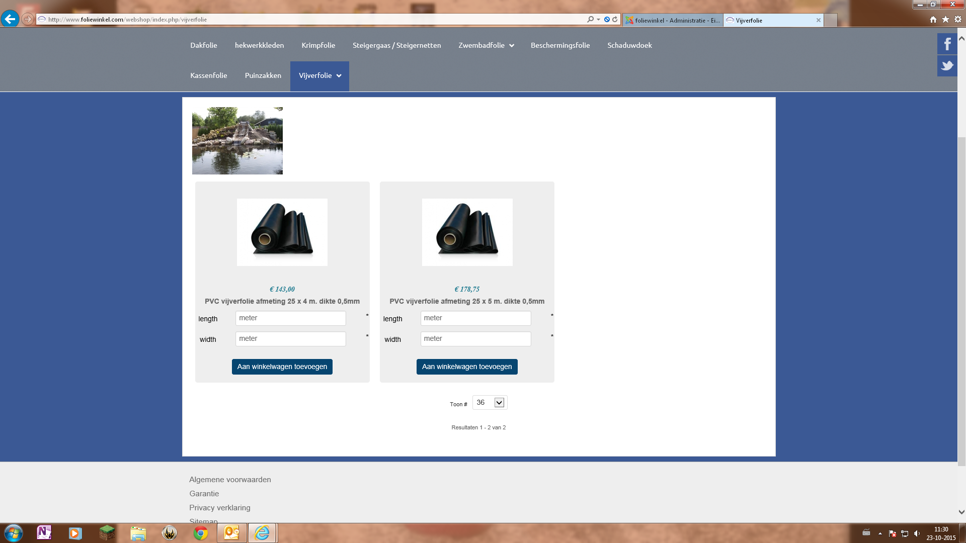

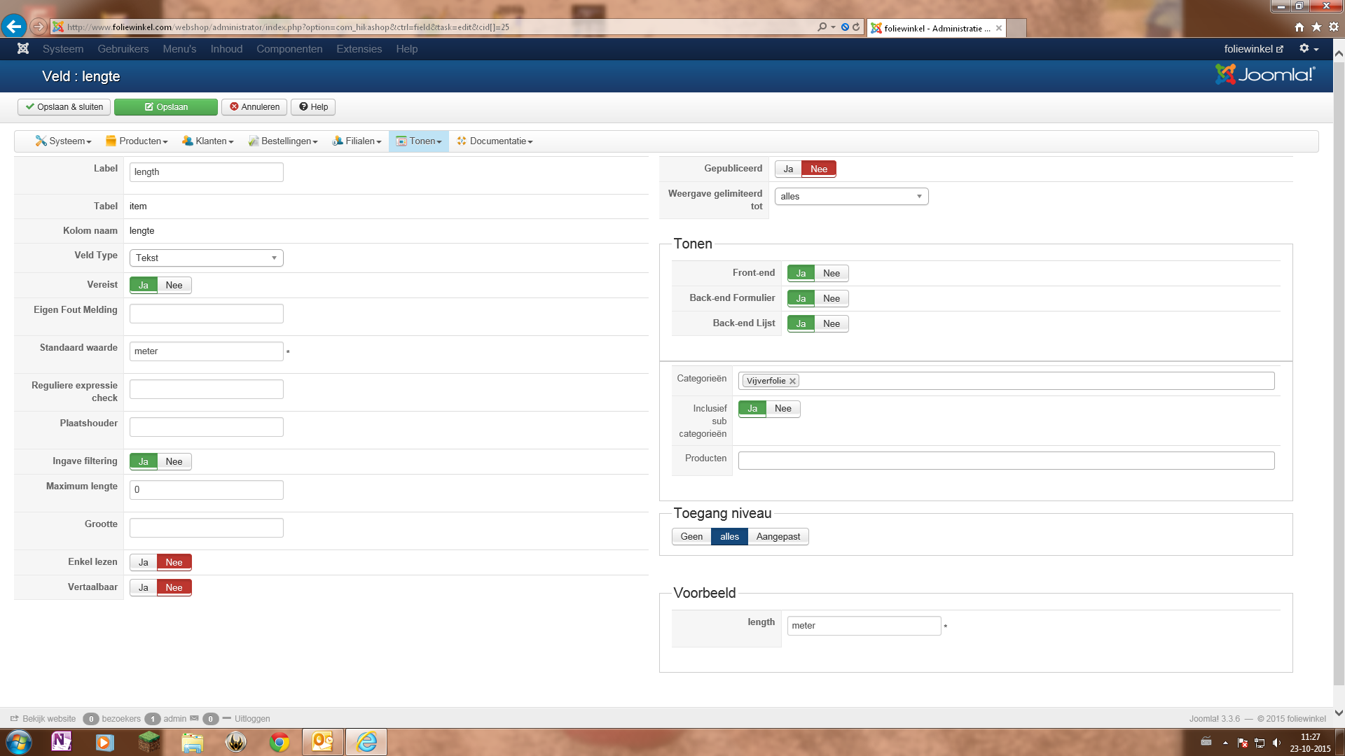

  • Posts: 26
10 years 9 months ago #218108
Thanks i have created the length en width item fields.
its working, but automatically calculated not the price.
Any idea what's wrong?? :unsure:

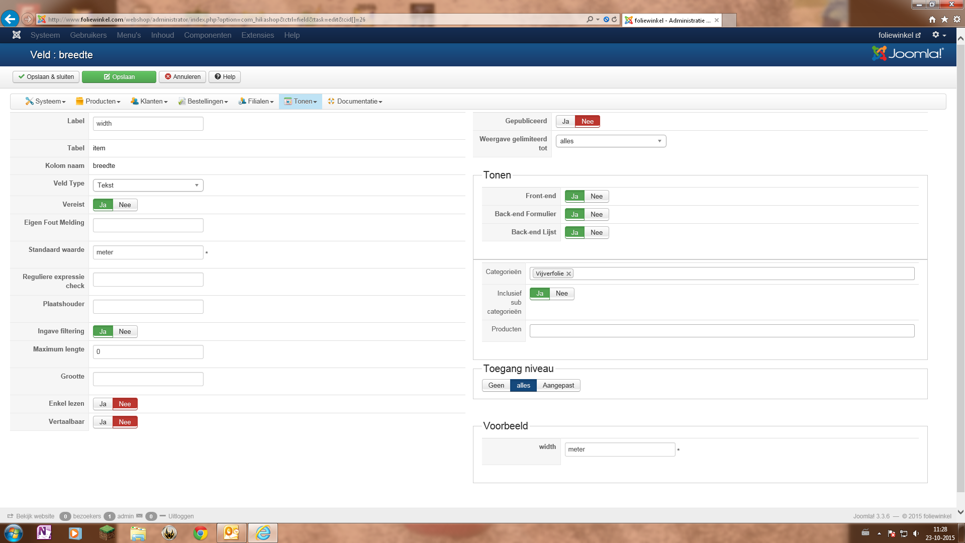

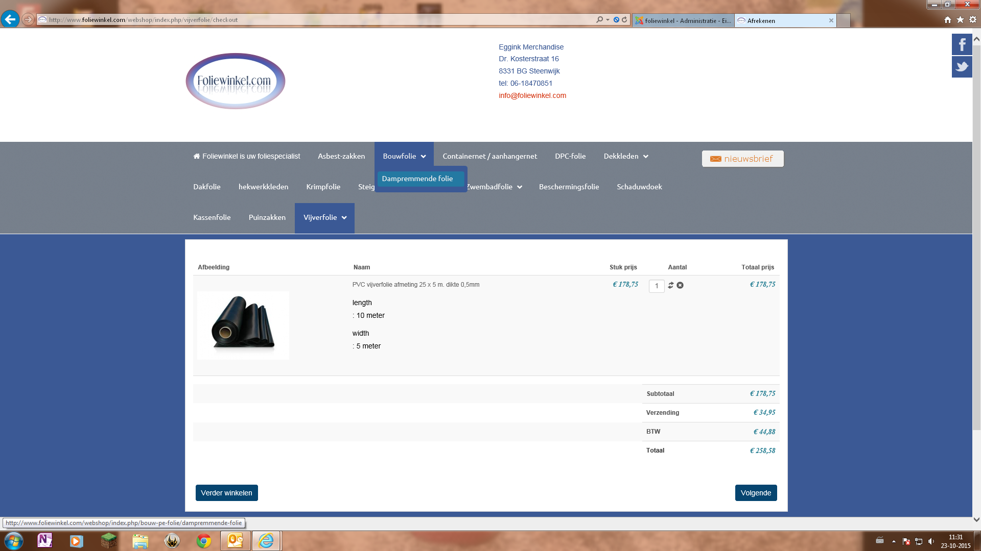

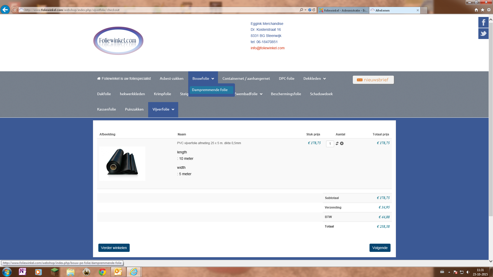

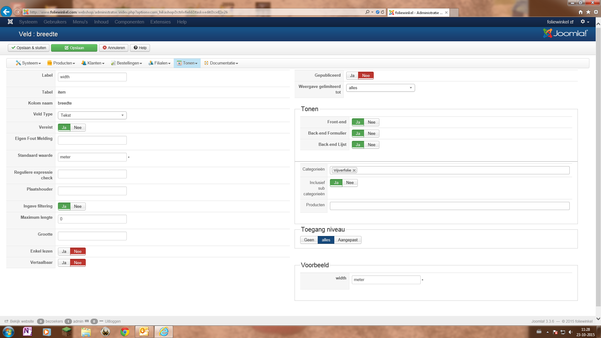

  • Posts: 26
10 years 9 months ago #218180
I installed the plugin and is published.
I make the item fields and they are published.
Only what's not working is calculating the price after i push the add to cart button.
I send some printscreens to clarify.
Last edit: 10 years 9 months ago by Joeri. Reason: vergot
10 years 9 months ago #218475
The issue come from the "Kolom Naam", there it must be "width" and "length" and not "breedte" and "lengte".
That's why it is not working as expected.
If you want to keep these Kolom naam, so you can edit the plugin directly and replace the occurrences of "width" and "length".
The following user(s) said Thank You: Joeri

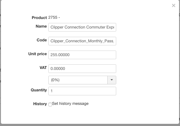

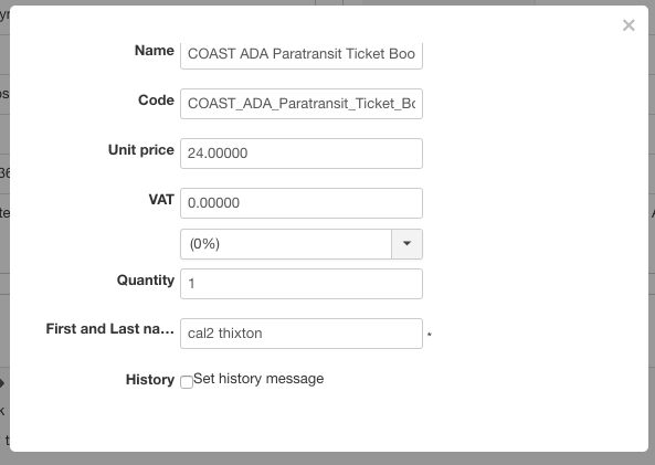

  • Posts: 4

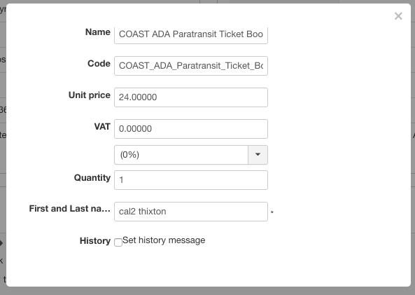

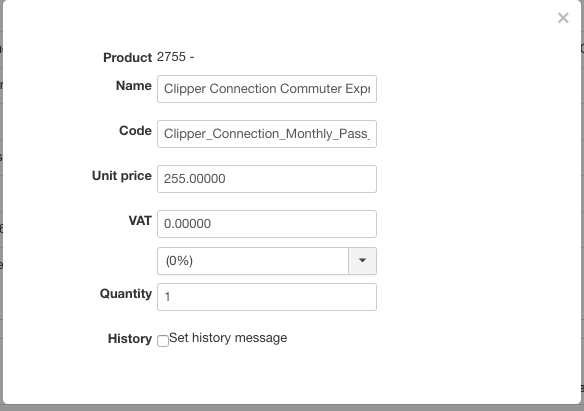

8 years 11 months ago #277437
We have been using Hikashop for several years now and upgraded to 3.1.1 business this summer and it broke part of our site.
We sell 3 types of bus tickets.
1) Two have variants with the year, month and route along with a custom field asking for the card holder's name to put on the bus card.
2) The third has no variants and only asks for the card holder's name (it is just a book of tickets which can be used at any time).
Everything worked fine after the upgrade until we noticed that the card holder's name info was not being stored on the first two types of tickets (#1 which also ask for the year, month and route), while the card holder's name is saved on the third type (#2 the book) even though for all three, the card holder's name is required when adding the product to the cart.
All 3 products look to be setup the same and we cannot see any category or permission differences between them.
Additionally, when drilling down into an order, for #1 types, the field for the card holder's name is missing, while on #2, it is there (see attached).
This only broke since the upgrade to business. Any ideas? Thx.
