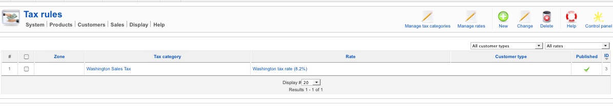

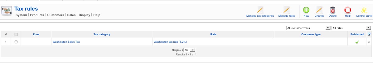

Could you post a screenshot of your tax listing and the URL to your website so that we can test your configuration on your website ?
  • Posts: 31
15 years 7 months ago #3573
Here is the link. Screen shot of tax rule attached.
paramipress.com/books/mapping-the-dharma/mtd
  • Posts: 86042
  • Thank you received: 14175
15 years 7 months ago #3574
In your screenshot I see that you didn't set the limit on the washington state ( the zone column value is empty ). So, it's normal that the tax is applied whatever the address. You should edit your tax and select your zone.

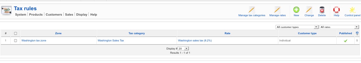

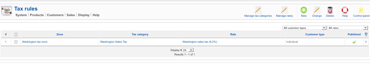

  • Posts: 31
15 years 7 months ago #3582
I'm still not getting it. After trying again with a Washington address, now no taxes are applied. Here is a recent screen shot of the tax rule.
  • Posts: 45
15 years 7 months ago #3586
In Zones you have to enter Washington as the default zone and type as State.
The way you have entered it I guess the system does not point this zone to the state "Washington"
Edit: Meaning when you add the zone again click in the little icon in the Zone, find Washington in states and add it.
