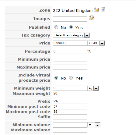

I'm trying to set up specific postage for some Scottish Islands.
One for example has postcodes beginning PA37 - PA39
However, if I try to ship to a test address with postcode PA37 1SE, it doesn't work. I already have a general United Kingdom shipping method at £3 and anything I try to get from the PA37 address defaults to that.
This is my settings, am I doing anything wrong?
Last edit: 14 years 11 months ago by castus.
  • Posts: 86179
  • Thank you received: 14217
14 years 11 months ago #27437
The first character of the second part of your post codes is also a number. Because of that, the system does the comparison with 371 and the range 37-39 which means that the post code is outside the range.
You should try with a minimum post code of 370 and a maximum post code of 399.

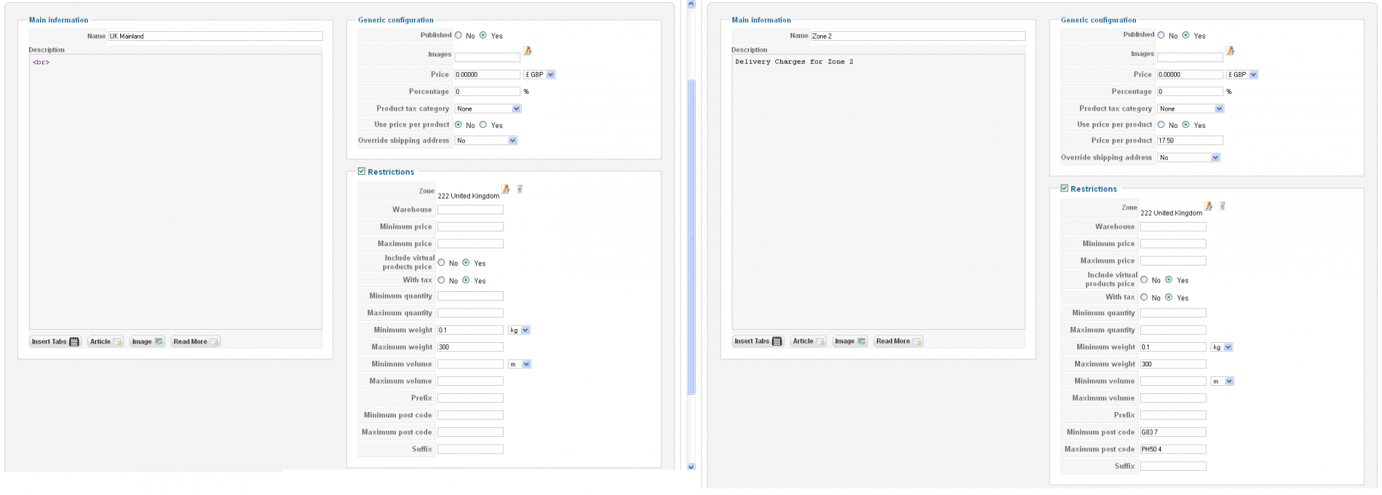

Hi There,
I'm having similar issues, but I imagine things have changed since the 2 years this topic was created!
I've already got a Shipping Method for the UK setup with free posting which is pointing to my United Kingdom zone. Now I've created another shipping method with the cost of £17.50 for Zone 2 deliveries, also pointed to my United Kingdom zone, so I'm guessing if I've configured the Minimum and Maximum post codes right it should add the extra costs?
Mines slightly more complicated as I've been given a list of post codes for Zone 2 which I'm attaching in this message. I tried G83 7 as the Minimum and PH50 4 as the Maximum but I'm guessing that's not how it works as it just has the free delivery option.
12 years 9 months ago #132904
For example, for the post code within this range : IV10 8 - IV9 8 you'll have to set the :
- Prefix option to IV
- Minimum post code option to 26
- Maximum post code option to 637
So, you'll have to create 1 shipping method per prefix.
