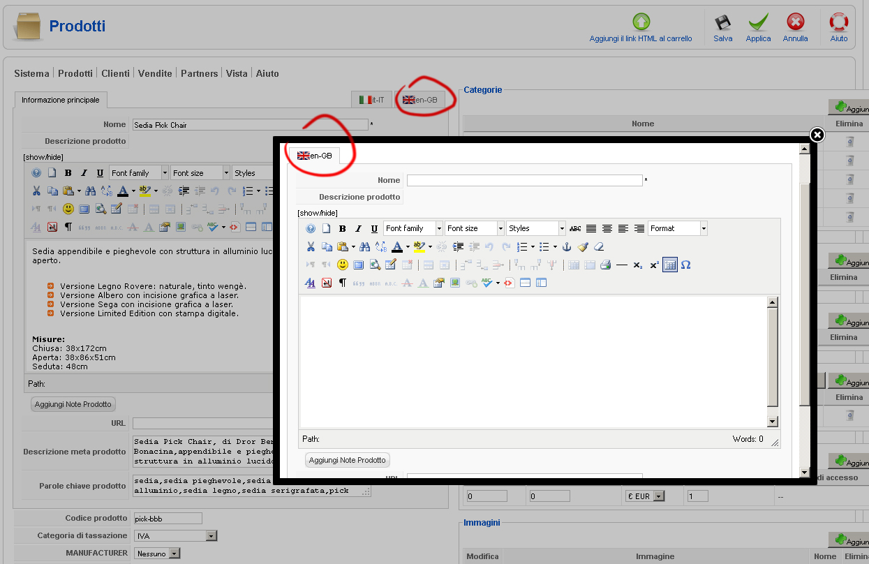

Ah Ok but I already do this.
I thought it was possible to use the panel in the product tab, like in the pic attached.

14 years 8 months ago #27837
No, that would require to modify the views there to handle that, as well as an option on custom fields to select whether it is translatable or not.
It would be possible to add that of course, but it's not possible right now.
