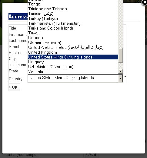

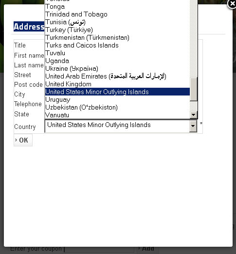

1. There is no option for USA (United States of America, only USA outlying islands is displayed) on the country drop down for customer registration (Address Information during checkout process)

However, United States of America is missing from the list of counties available.... is this from a file somewhere?

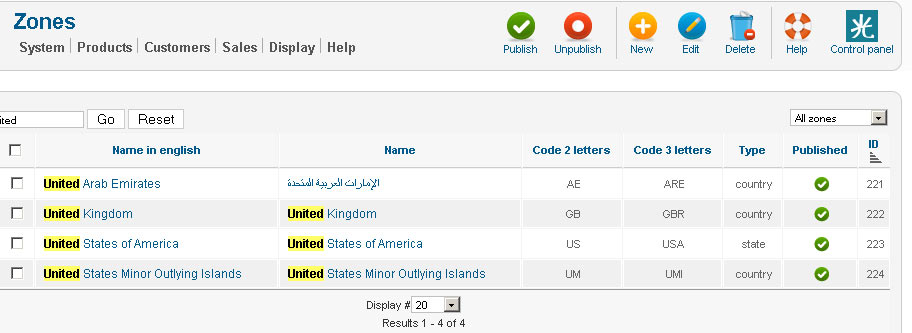

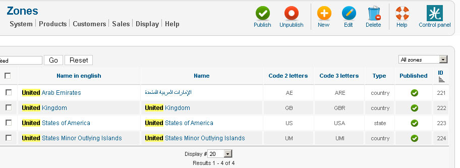

However, I did not delete it, or unpublish it. In fact I haven't done much at all, it is a new install... testing it out.
I have added 2 products, some categories and a tax zone
Anyways, am including pic of System > Zones that clearly shows the published state

  • Posts: 38
14 years 9 months ago #29794
OH! I see it... Type = State!
Now, how did that happen?? :unsure:
Thanks I've got it
  • Posts: 86050
  • Thank you received: 14178
14 years 9 months ago #29796
Yes, that's the problem. The USA is a state instead of being a country. So it's not displaying in the country dropdown. Just changing it to country will make it display.
