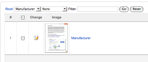

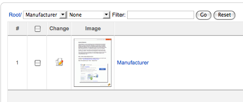

Then, you're probably talking about the name of your main manufacturer category.
Go in the menu Products->Manufacturers and click on the Root link on the left. Then, edit your "manufacturer" category and change its name.
  • Posts: 13
14 years 10 months ago #30021
nicholas,
at first I was a bit confused by what you suggested, but then I found that I had to edit the category name for what I had changed to 'artist' (category 10)
now it works perfectly!
