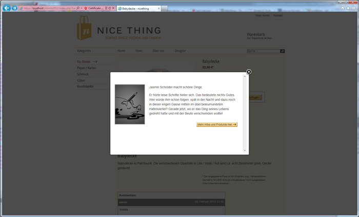

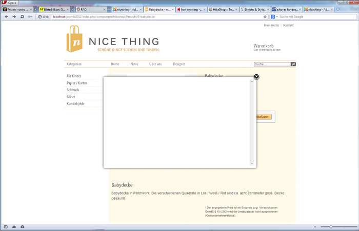

  • Posts: 95
13 years 6 months ago #89541
Yes, after view days I can find the same problem. Seams to be a Opera-Browser problem, why I attached two pictures: without content in Opera and with the content in IE.
Have you an idea, why this things happen?

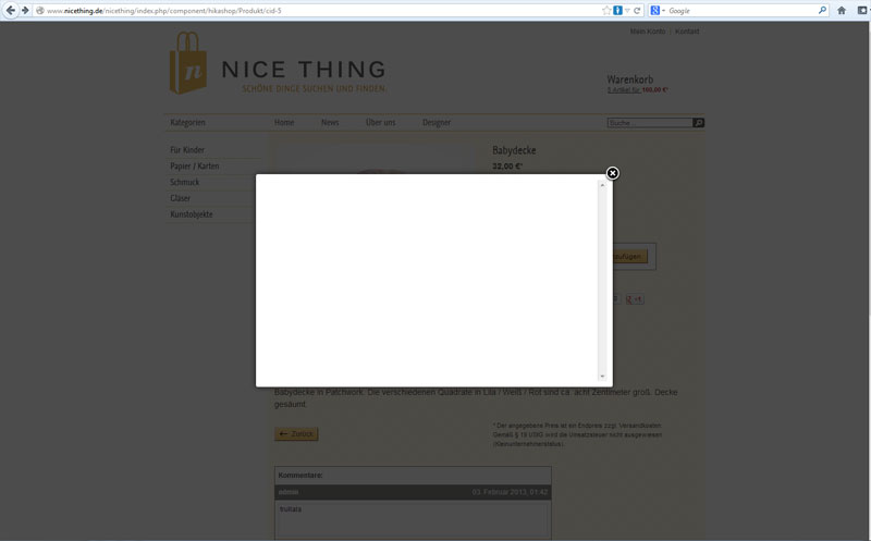

Now, all my problems are online. Have a look here:
www.nicething.de/nicething/index.php/gla...1-black-russian-glas
On the right is the "Brand" Designer-Link. This opened a popup-window with Designer-Details - sometime its working, but not always.
One thing more: If I want buy the product it will figured in the cart. But sometimes I can't open the cart ("Warenkorb" on the top). Offline works, but online its a hazard-thing.

The popup of the "Designer" is a lot of times empty (see actually screenshot). I don't know why. (After clicking some sites is appearing sometimes.)
Thanks for give me the hint to http - I ignored that. Now is working.

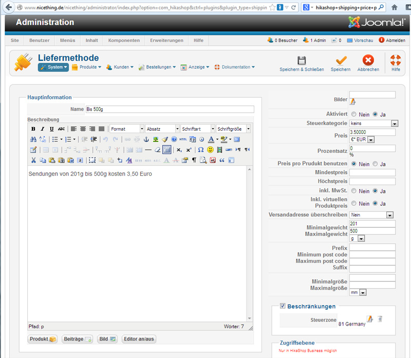

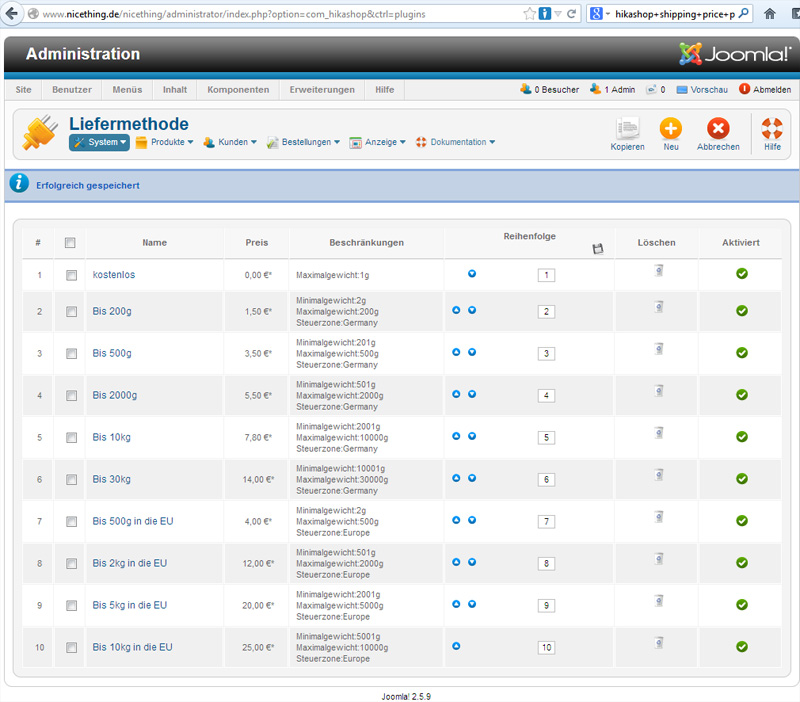

I don't want a price per product. It would be nice, that I can determinate a weight-"area" e.g. 501g - 2000g will cost 5,50 Euro. Then the amount of the weight of various products count automatically the shipping price (e.g. 150g + 300g + 200g = 650g -> 5,50 Euro).
I 've tryed it (see the attached files) and sometimes it is working a bit - but not sure (you can test it on my site).
Also I have set, one time for testing, the price per product and it dosn't working right too. I think the manual shipping method no is working fine on my site.

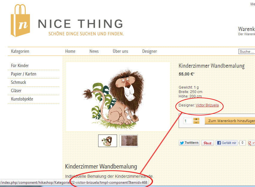

For the problem with the empty popup. I've tested it more and I've seen that the link is different when it won't work.
If ends with "...tmpl-component" its going right. But if ends with "...tmpl-component?Itemid=468" will be appear empty (see attached screenshot).
Of which depend it on - no idea.
