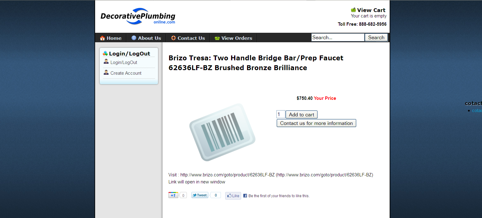

still not there...
made the change, now page loads, but url show twice, and is not clickable....see image

  • Posts: 86179
  • Thank you received: 14216
14 years 10 months ago #30177
It's definitely not good to do that at 3am :)
The second line should be:
echo JText::sprintf('MANUFACTURER_URL','<a class="modal" rel="{handler: 'iframe', size: {x: 450, y: 480}}" href="'.$this->element->product_url.'" >'.$this->element->product_url.'</a>');
and not:
echo JText::sprintf('MANUFACTURER_URL','<a class="modal" rel="{handler: 'iframe', size: {x: 450, y: 480}} href="'.$this->element->product_url.'" >'.$this->element->product_url.'</a>');
