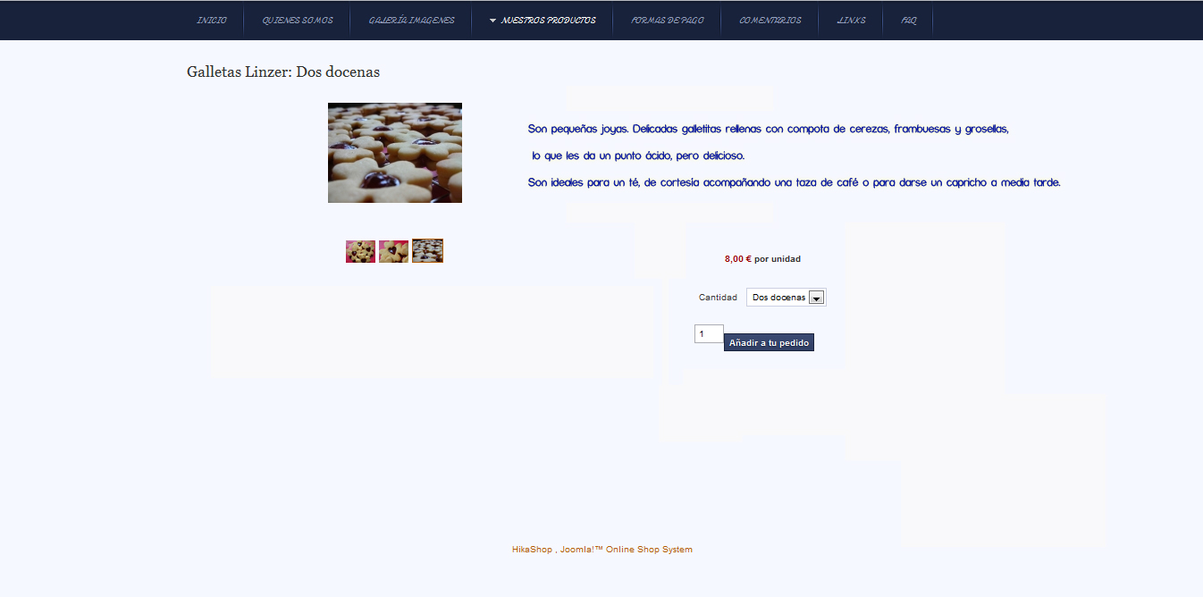

Hello, I would like to change the description of the product
Now I have to do; www.claradehuevo.com/webprueba/index.php...o/12-galletas-linzer
But I want to do
This is an edited picture by photoshop
What do I have to change?
Thanks!!
Last edit: 14 years 8 months ago by astru.
  • Posts: 86058
  • Thank you received: 14184
14 years 8 months ago #30902
You should move the code:
<div id="hikashop_product_description_main" class="hikashop_product_description_main">
<?php echo JHTML::_('content.prepare',preg_replace('#<hr *id="system-readmore" */>#i','',$this->element->product_description)); ?>
</div>
inside the div hikashop_product_right_part in the file 'show' of the view 'product' via the menu Display->Views.
If the width of the description is too big, the whole right part might go below the image. In that case, you will need to add some CSS like that :
.hikashop_product_right_part { width: 400px; }
in the front end CSS that you can edit via the Display tab of the configuration.

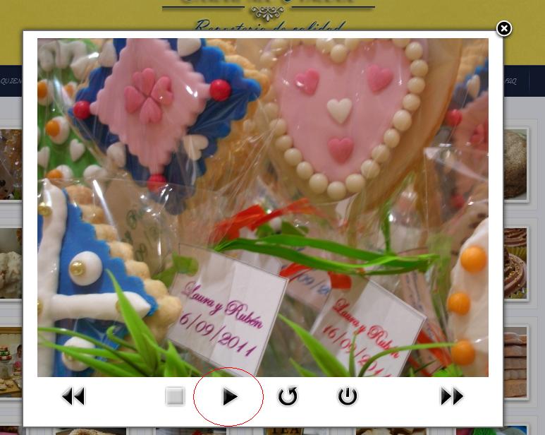

I have another question.
By increasing the images of my products
How I can add a button next or play like these?
  • Posts: 86058
14 years 8 months ago #30957
There is no option for that.
You would need to override the image display by using another shadow box system. But that require programming skills.
