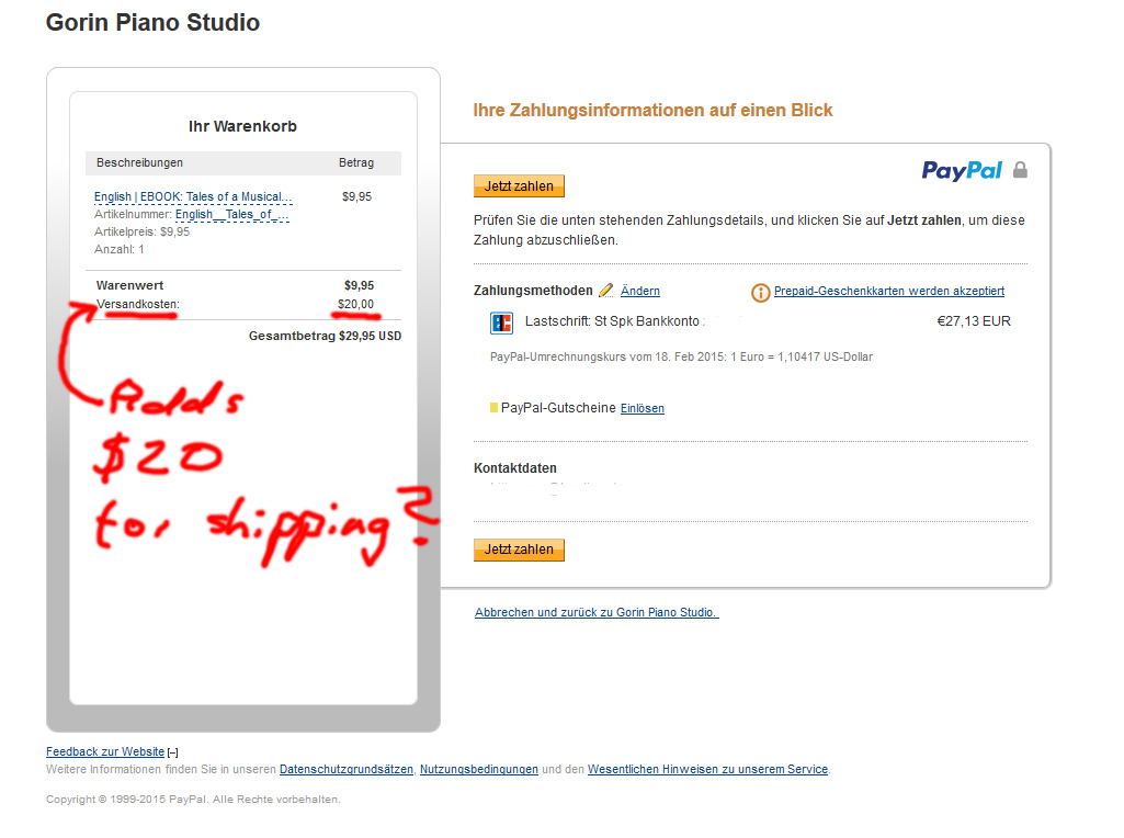

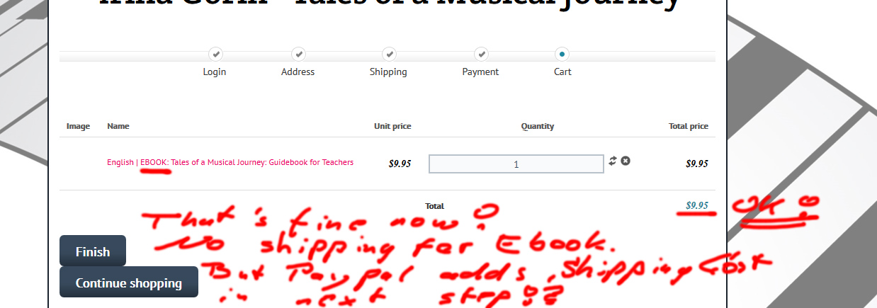

11 years 5 months ago #191114
Hi!
Thanks you are right, there was a weight typed in. Now Hikah calculates the right total end-price when a virtual product is in the cart!
BUT NOW I HAVE A STRANGE EFFECT:
Hikah has the right Total-Price but at the end of the checkout, when the Paypla-Website comes up, Paypal adds 20 $ shipping-fee by itself? Paypal only do that when I bought virtual products?
I attached screenshots?
I checked the options of the Paypal-Module but cant find a solutiion...
Thanks again, Frank

  • Posts: 18
11 years 5 months ago #191275
Hi jerone,
I tried to set "Send Details" to NO but it didnt help.
After that I tried to use my own Paypal-Adress for checkout (and not the Paypal-Adress of my customer) and then it worked fine and Paypal dont put own shipping-costs onto the virtual products!?
Could it be that my customer had made some settings directly at Paypal that generate tha problem and Hika wont be the reason for that problem?
Thnaks, Frank
  • Posts: 86027
  • Thank you received: 14171
11 years 5 months ago #191607
You should deactivate the shipping costs that you configured in your PayPal merchant account and then you won't get shipping fees added to the orders that you want to pay via PayPal.
