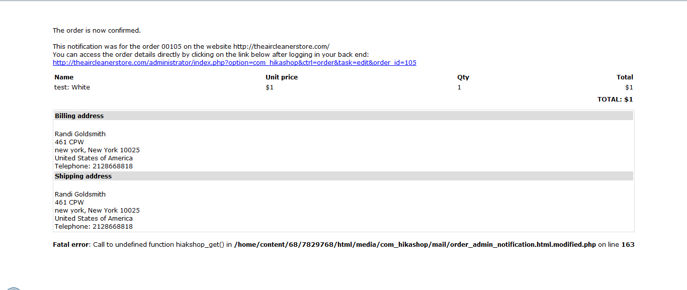

14 years 8 months ago #31595
Didn't work. when I use this code and place an order online, instead of getting my normal "thank you/confirmation" page, I get the following. See image attached with screen capture.
  • Posts: 86058
  • Thank you received: 14184
14 years 8 months ago #31609
There is a typo in the code of that user.
It should be hikashop_get and not hiakshop_get.
Try with the same code but changing that.
  • Posts: 53
14 years 8 months ago #31626
No typo here:
$userClass = hikashop_get('class.user');
$userClass->get(false);
$user = $userClass->get($data->order_user_id);
echo $user->user_email;

  • Posts: 86058
14 years 8 months ago #31678

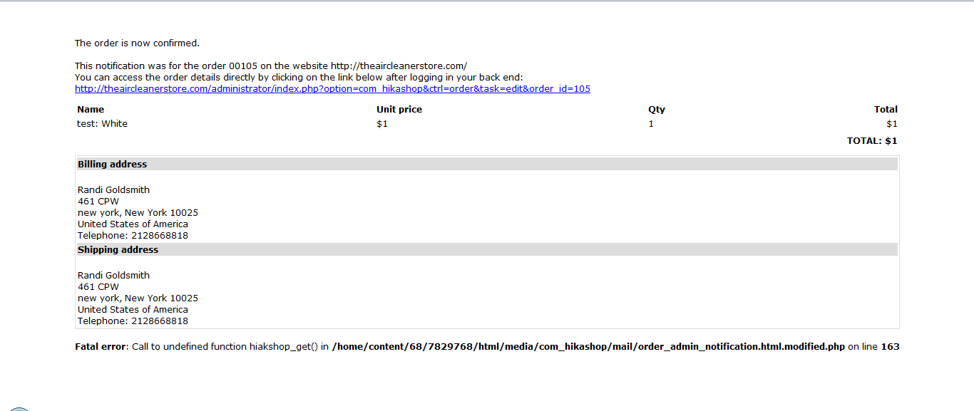

The error message in the capture you made was "Fatal error: call to undefined function hiakshop_get...". If you corrected the typo, it's not possible that you get the same error message since the typo was the cause of the error message.
  • Posts: 53
14 years 8 months ago #31690
I got that error message without a typo in the code. I never put the code on my site with the typo.
  • Posts: 86058
14 years 8 months ago #31724
I can see the typo in your screenshot...
Anyway, if you don't have the typo and still the error message, maybe it's because you're using an old version of HikaShop ?
In that case, you should use hikashop::get instead of hikashop_get.
  • Posts: 53
14 years 8 months ago #31742
You made a valid point about the typo in the screen shot. I did it again and it worked. Thanks.
