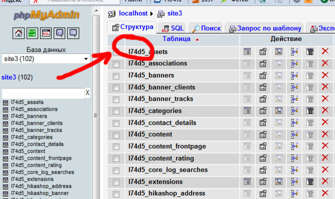

  • Posts: 2293
  • Thank you received: 315
14 years 8 months ago #31623
your sql query is wrong.
in joomla 1.7 there is random prefix before any table.
you can see it in your phpmyadmin like this:
and so see your prefix and replace "jos_" in your query on your in to your prefix

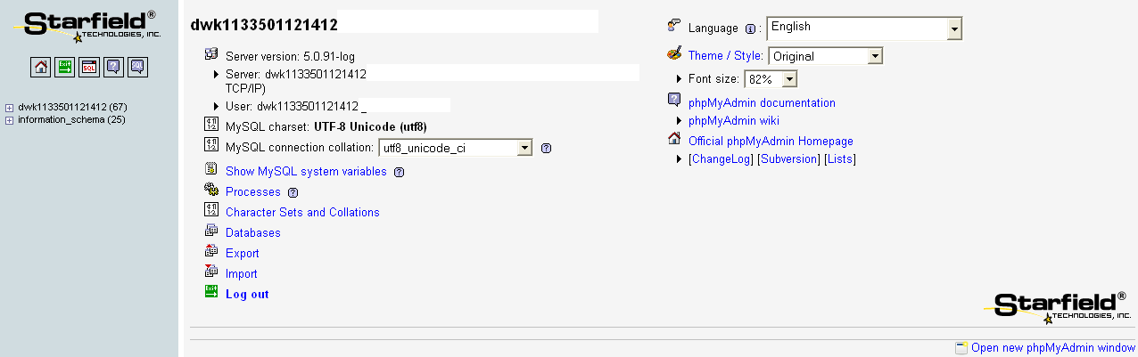

14 years 8 months ago #31627
I went back and looked, and my prefix is actually "jos" instead of some random numbers. Here are some screen shots of my phpmyadmin...

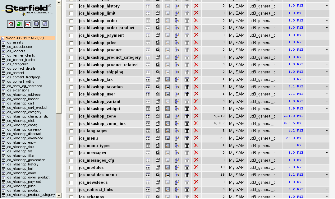

  • Posts: 5
14 years 8 months ago #31628
and here is what is displayed when I click on my database table on the left...
  • Posts: 85989
  • Thank you received: 14163
14 years 8 months ago #31649
Please open the jos_menu table make a backup of it with the export tool. Then, look for any hikashop related menu and delete them. Then, reinstall HikaShop and you should have the menu.
