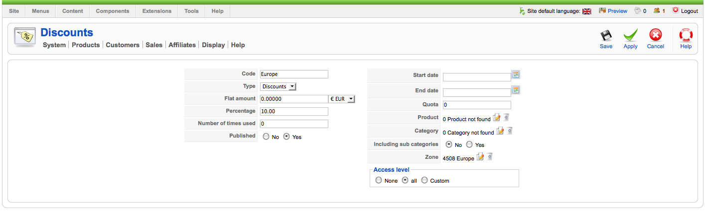

1. Could you do a screenshot of the options of your discount ? (As a rapid alternative to the problem you could create one discount per country since that is working as you said)

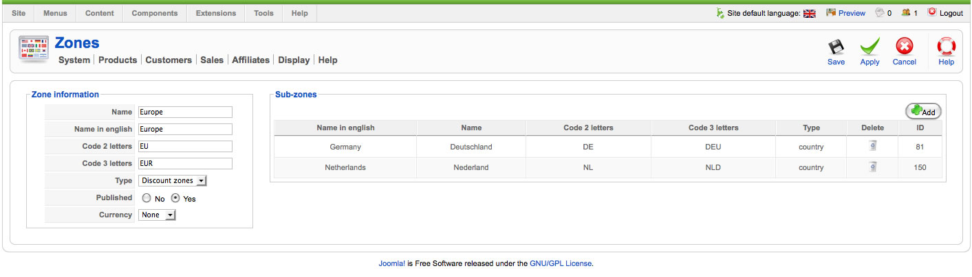

1. Attached is a screenshot of the discount (and also the zone).

Yes, that would help. Your settings seems fine. You can use our contact form to send us the access. don't forget to give a link to that thread so that we know why you're contacting us.
