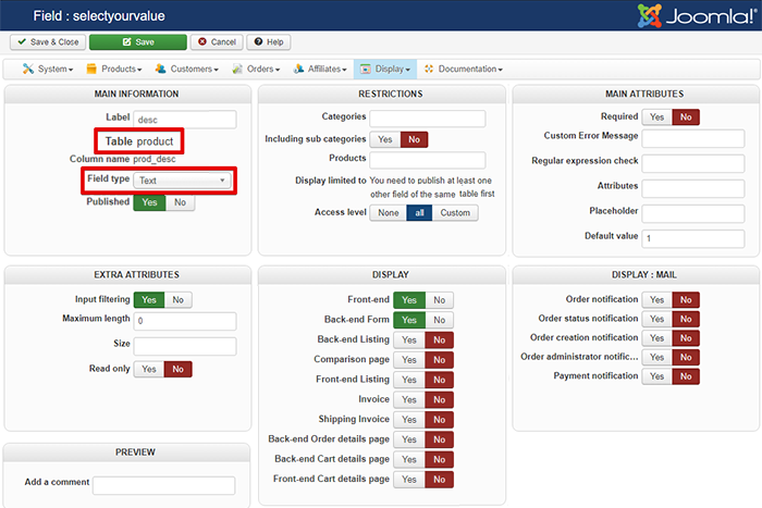

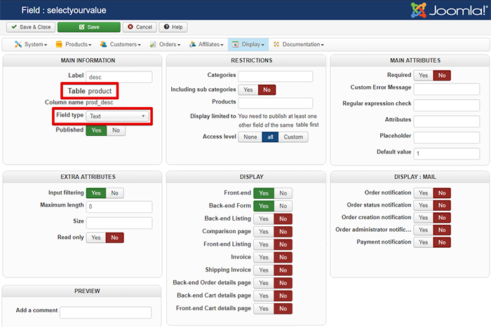

8 years 11 months ago #273628
I think you use an Item Custom field and create an override view, you need to have html & php knowledge, follow these steps :
- First, go to Components => HikaShop => Configuration
- Then in Display dropdown select Custom fields
- Click on New
- Reproduce this settings :
And add your custom code in order to have your custom field display on your listing view :
- Define which listing type you use among listing, div or tabular
- Go in your Main HikaShop Configuration part (like previous)
- On Display dropdown this time select Views
- Use 3 filter dropdown with Product/YourTemplate/Front end
- Select your required among listing_div, listing_list or listing_table
- Add where required this code to display your custom field :
echo($this->row->prod_desc);
Just be sure to be in the block that start with :
<div class="hikashop_subcontainer <?php echo $this->borderClass; ?>">
, around line 125 and before this command :
unset($this->row);
And to see how to proceed, see this tutorial .
After this you will have to full your custom field directly in your product backend configuration.
Hope this will help you to achieved what you wants.
