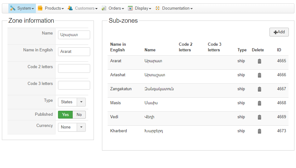

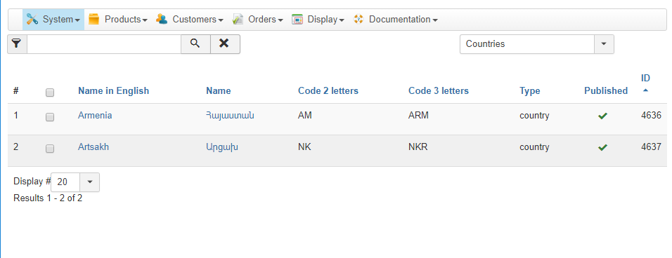

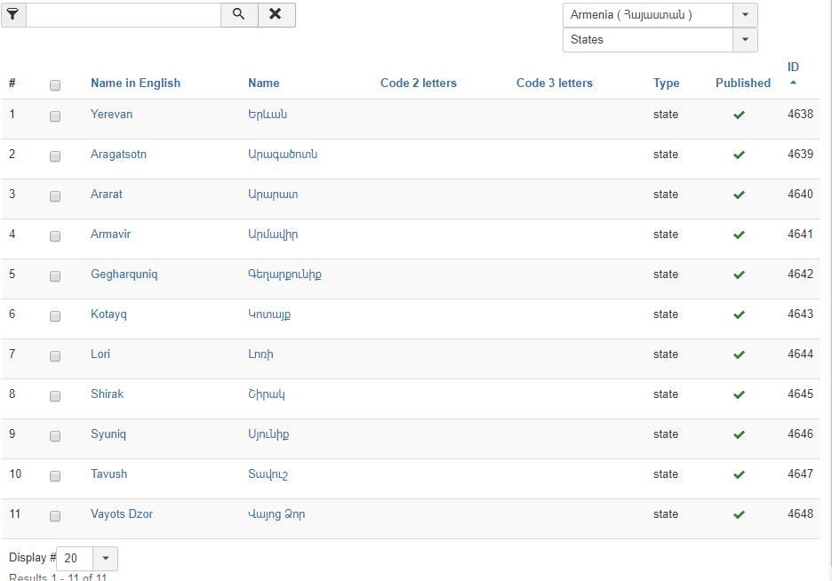

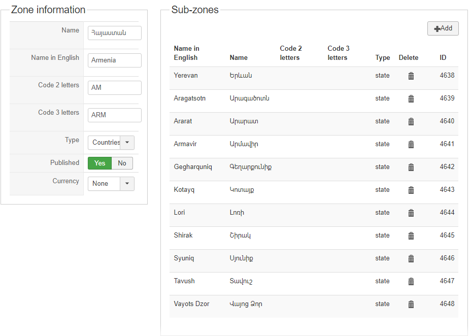

  • Posts: 1
9 years 4 months ago #266309
Hello. I have a problem with country / state / city settings and managing shipping by the selected zones.
By default after choosing a country, the filed "State" shows only the states of the chosen country.
I have created states in the sub-zone of the country and then created shipping zones in the sub-zone of the state. So I think this should have linked the shipping zone to a state that is linked to a country but that doesn't work.
From the "Custom fields" section I have changed "City" field to dropdown and chose it to show the listing from "Shipping zones" that I have added from inside of states names.
It does show everything from the shipping zone but does not automatically filter to show only that shipping zones that are created inside a particular "State zone" and linked to it.
I need to do the following: After choosing a country, only the states of that country should be shown and after choosing a state, cities of that state should be listed only.
In addition to that I have created manual shipping plugins with exceptions to zones where I have chosen a shipping zone. When I choose a shipping zone in the address window in the filed "City" the checkout system says no shipping method was found. If I change "State" filed to show "shipping zone" listing the shipping plugin works.
Please help me to find the problem out.
Thanks in advance
  • Posts: 86042
  • Thank you received: 14175
9 years 4 months ago #266429
The "linking" between the country and the states is only done between these two types of zones. So it's normal that what you're doing doesn't work.
Similarily, the shipping methods "zone" setting only take into account the state and country custom fields.
So it's not that there is a problem. It's just that you're trying to do something which the system isn't capable of.
If you only want to ship to Armenia, then you could actually repurpose country zones as state zones and state zones as city zones and modify the label of the custom fields address_country and address_state to select respectively the state and the city.
That way, the cities would refresh when you change the state. The drawback is that there wouldn't be a country selector. You could potentially create another custom field to have it, but the states field wouldn't refresh accordingly.
