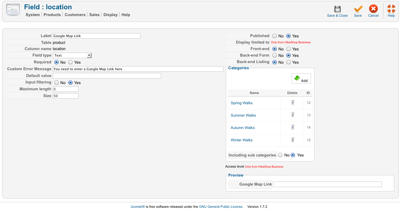

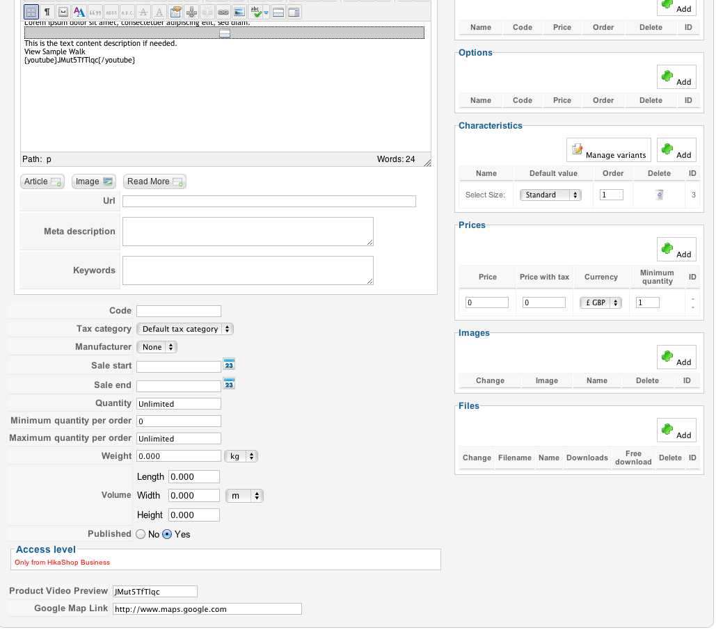

Trying to do a similar thing now with a link to google maps
I have added a custom field for products, and this displays as a text box on the add products page where I can enter a link.
My column is called 'location' and my code is: <?php echo JHTML::_('content.prepare','<a href="'.$this->row->location.'">Location</a>'); ?> in the products, show.php
However I cannot seem to get the link to work on the frontend, it just goes to the root of my website all the time???
Any suggestions?

If you don't use a content plugin, you can simply do:
<a href="<?php echo $this->row->location; ?>">Location</a>
Make sure that you have the http:// in your location field.
If that still doesn't work, please give a link to that page so that we can see what you did.

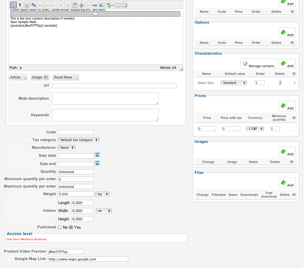

As you can see from my screen grab, I entered www.maps.google.com
Last edit: 14 years 8 months ago by jazzmeister. Reason: mistake
  • Posts: 86116
  • Thank you received: 14211
14 years 8 months ago #33528
Are you sure that the column name of your custom field is "location" and not something else ?
Because the code is correct so I don't see why it wouldn't work unless it's not the correct column name.

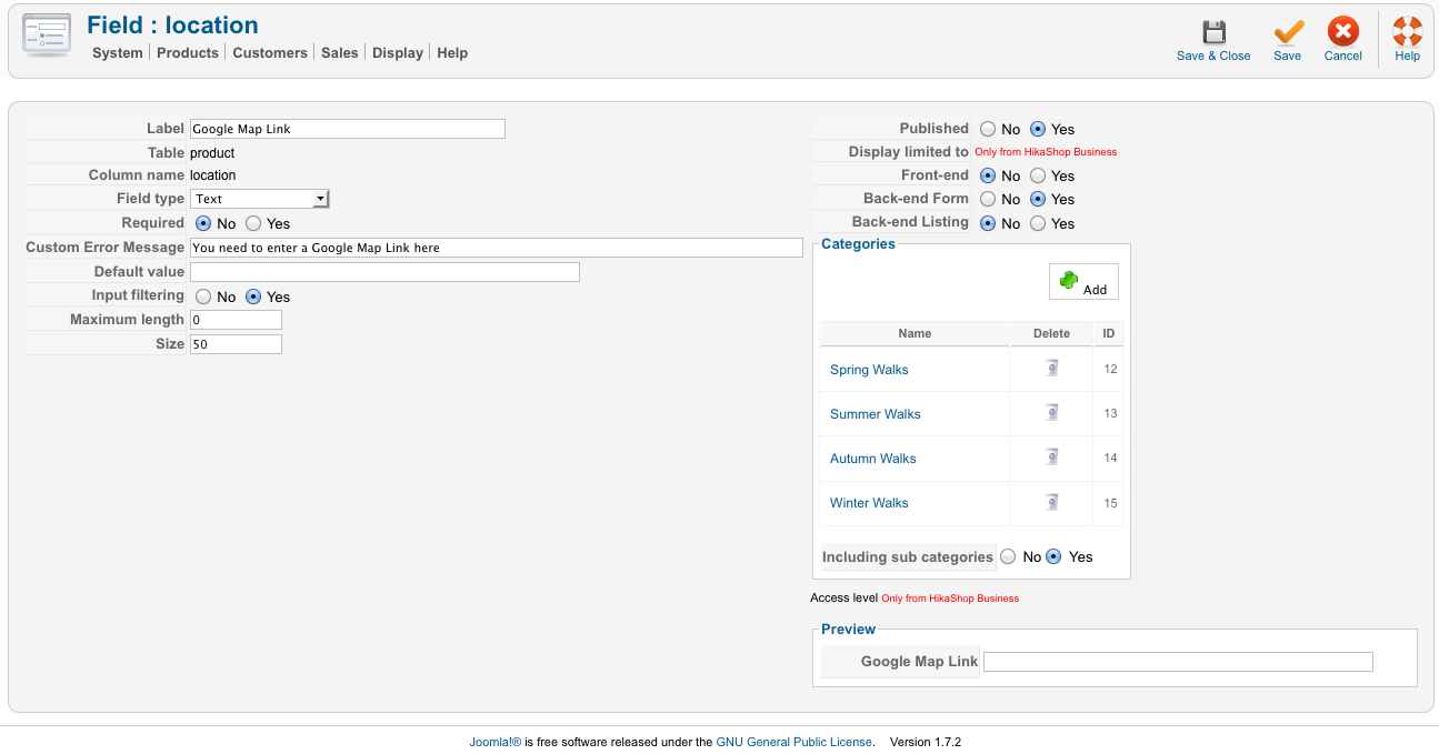

  • Posts: 21
14 years 8 months ago #33540
yes the column is correct please see image.
