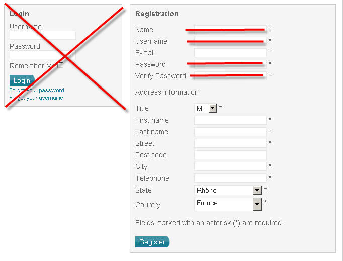

I would like to make the purchase process as easy as possible for the visitor.
How do I configure Hikashop so that the customer does not have to create a username and password when making a purchase?
The only information I would like for the visitor to provide me with is similar to this:
