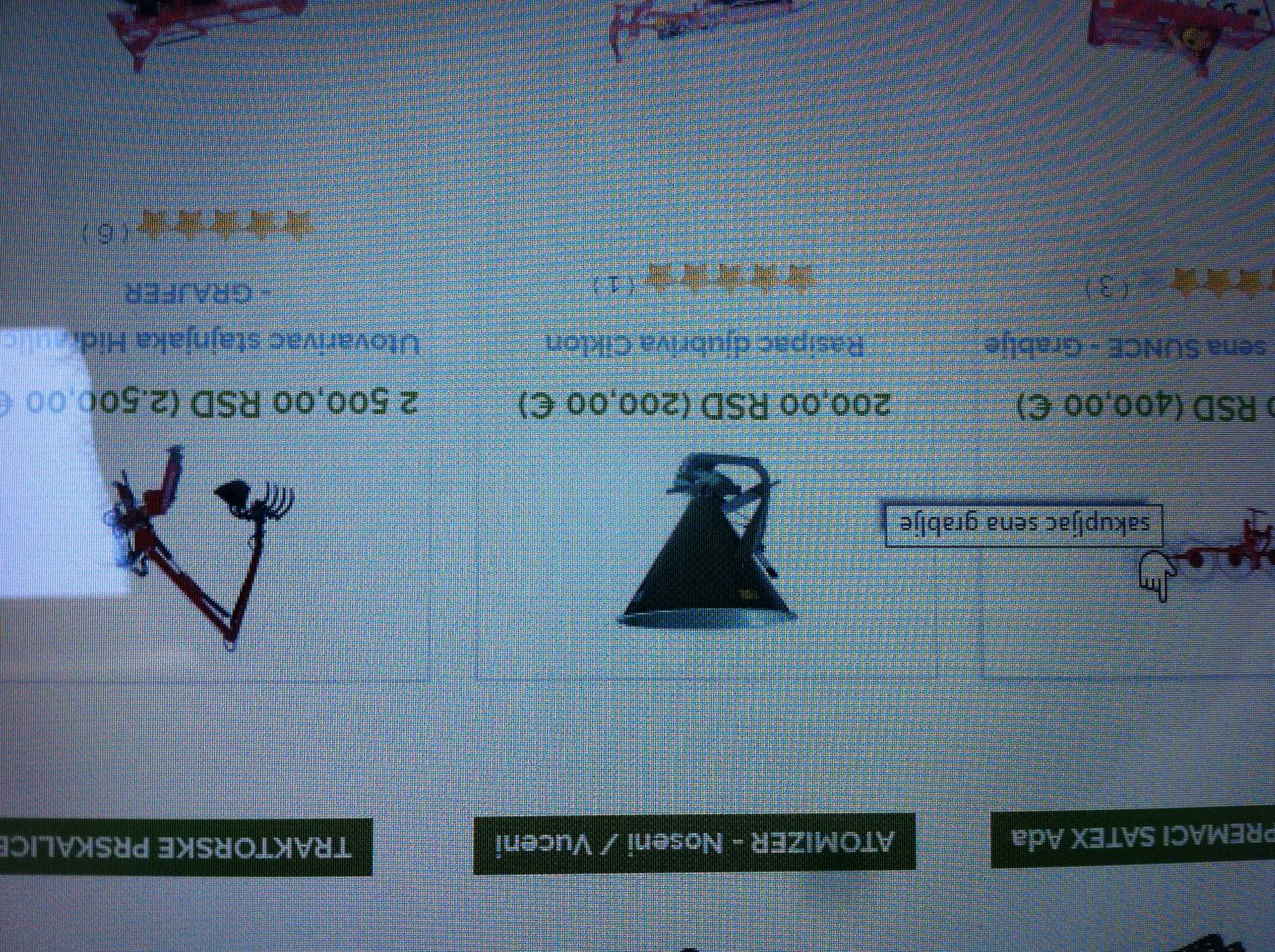

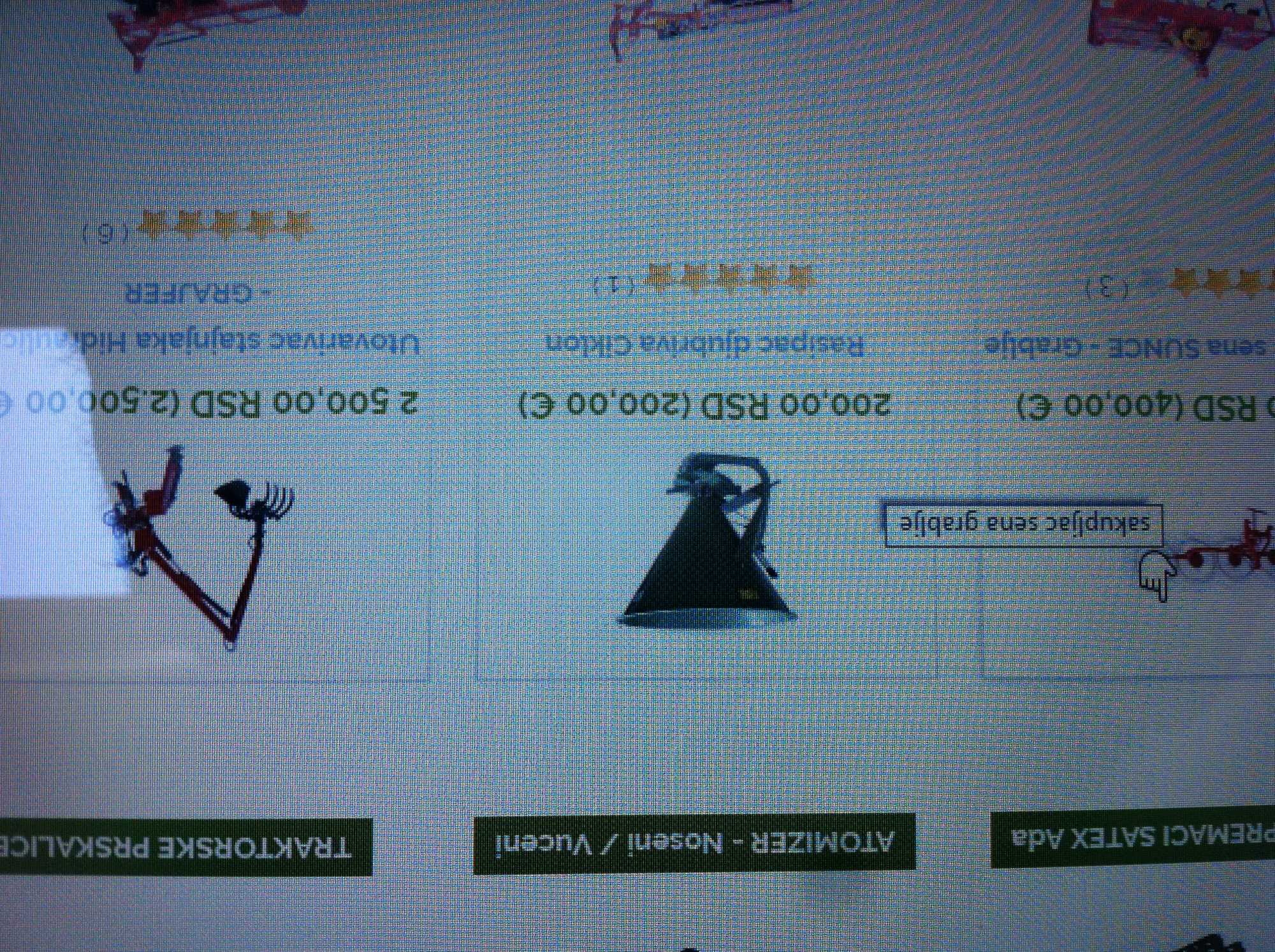

  • Posts: 1
9 years 10 months ago #250635
Hello, an you help me.
I hava a problem with price, how to remove double price? You can see doble price on: www.poljomarket.rs/kategorija/24-prikljucne-masine
