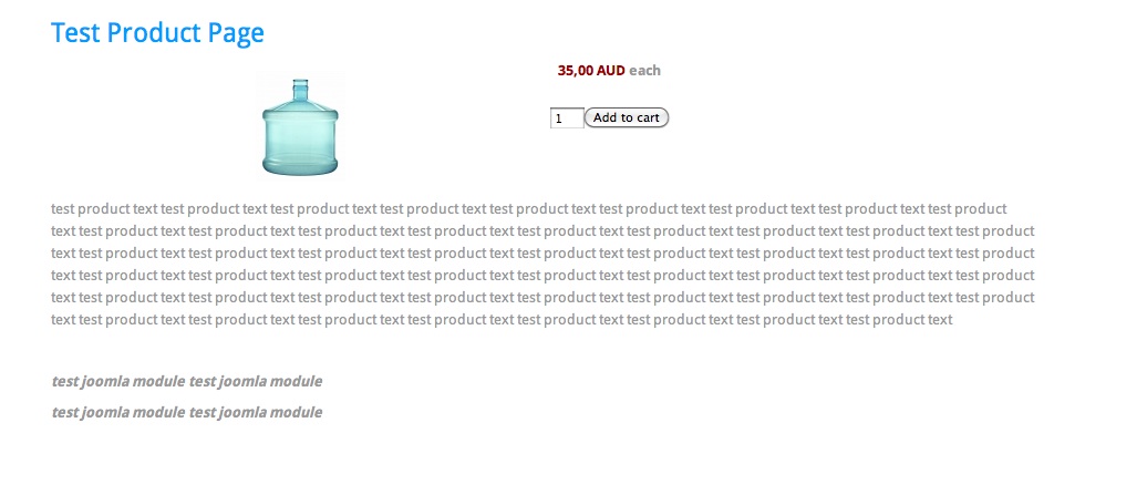

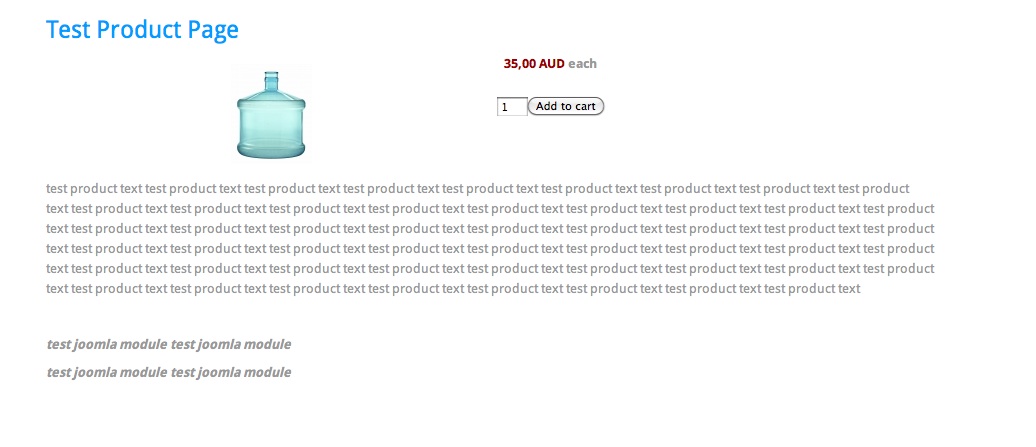

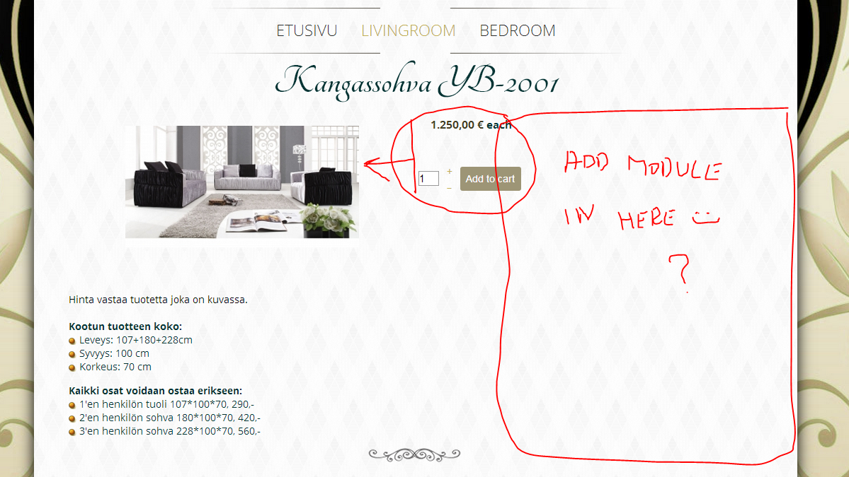

I've made up a test product page and attached a screenshot so you can see more.
As you can see i'm trying to display the joomla module to the right-hand-side of the price/cart display but above the text. Is this possible?
Really appreciate your help.
Thanks.
  • Posts: 9
14 years 7 months ago #34513
  • Posts: 86049
  • Thank you received: 14177
14 years 7 months ago #34550
If you want to display the module there, you should edit the file "show" of the view "product" via the menu Display->Views and add your module display code in a div html element with a class name just after the div with the class name hikashop_product_right_part. Then, you will need to modify the CSS so that it displays next to the price/cart area. I will need to see directly the page with firebug to help you more precisely with the CSS to use so please give a link to that page once you modify the view file.

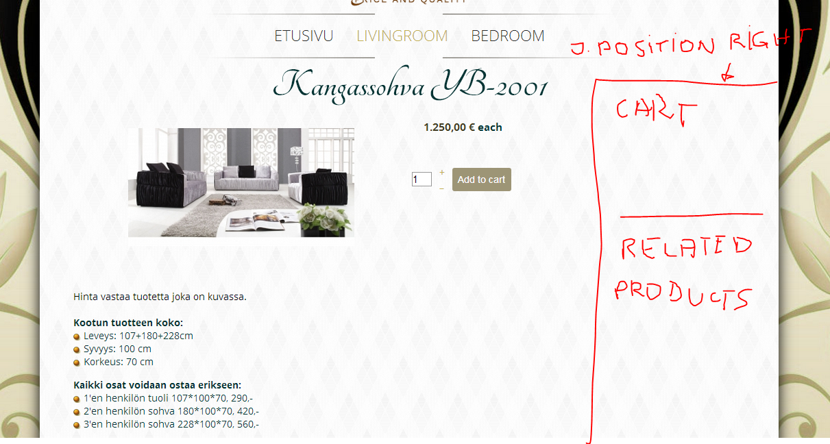

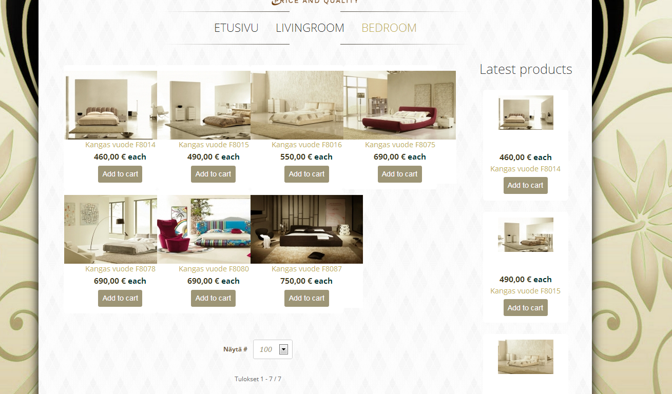

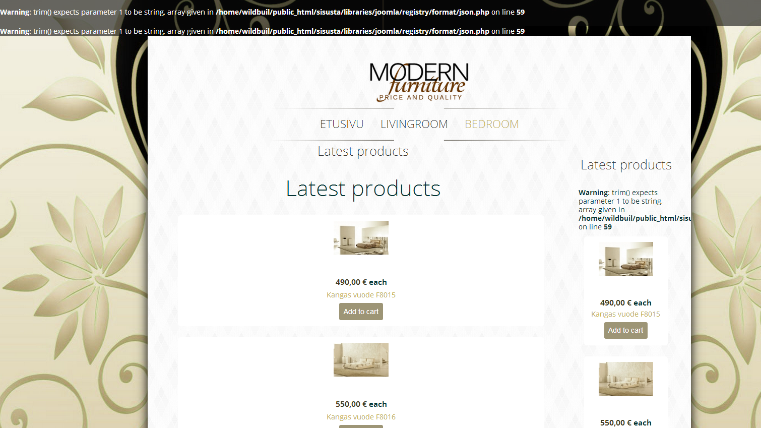

HOW can i display "stuff" like Cart, Related/latest products ONLY on product page on the right joomla module position?

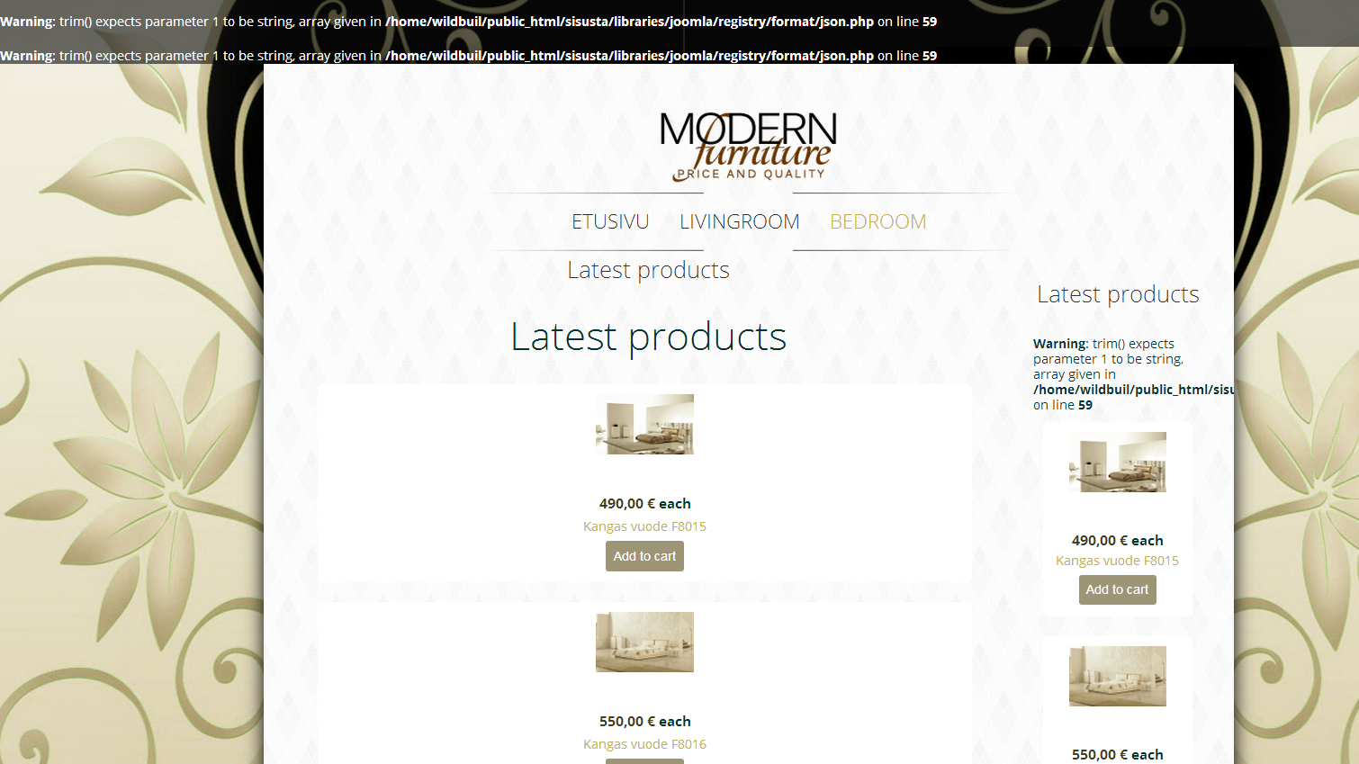

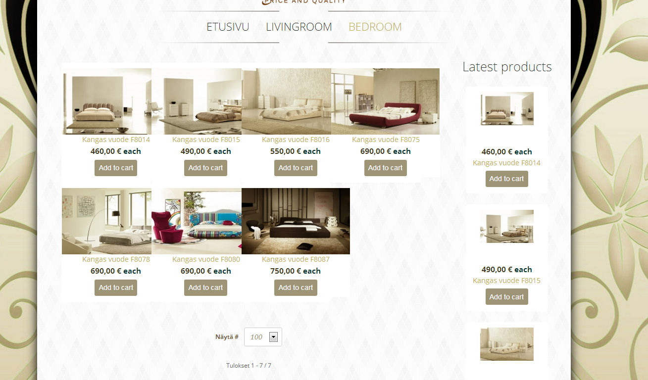

so far i did actually managed them to appear to right position on product page (PIC 2), but they also appear on everywhere else (PIC 3, ), and sometimes even twice on product page... I would like RIGHT module position appear with cart and related products ONLY when product page is displayed not anywhere else.

  • Posts: 86049
12 years 10 months ago #126535
Joomla doesn't offer such options by default. You will need to install "Advanced Modules Manager" to be able to restrict a module to a specific page of HikaShop:

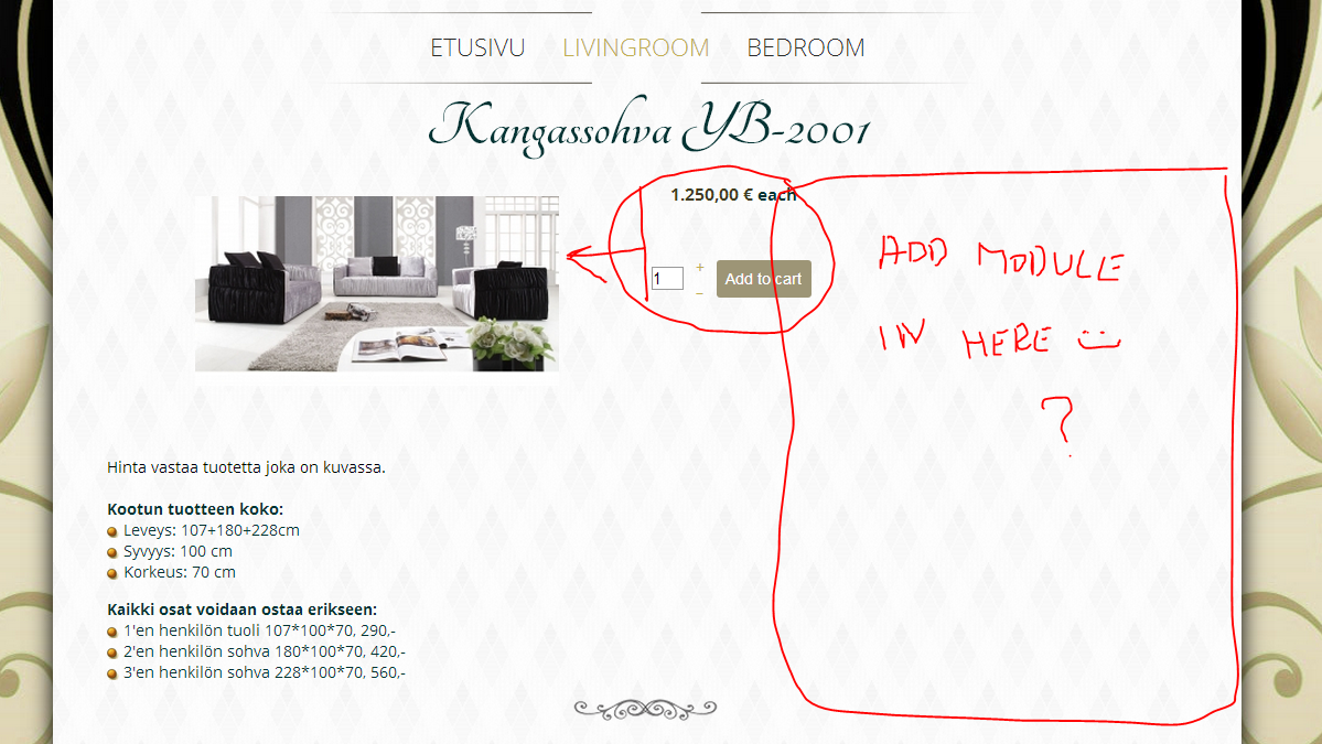

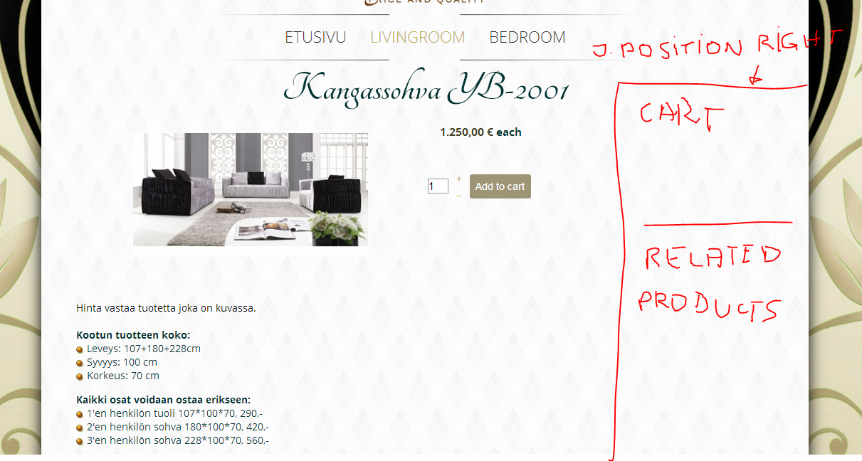

is there possible to add some modules in product pages at the top right corner like on pic?! coz right now related products and modules are shown at the bottom of product page...
page just looks so empty up there :/

  • Posts: 26381
12 years 10 months ago #126586
HikaShop have an option to display modules under the product page but, depending your template (specially, your CSS) you can display it at the right.
You can also override the product page display and more precisely the "product | show" page.
There are display in the div with the id "hikashop_submodules".
You can put CSS rules for it and you can find the block in the view too.
