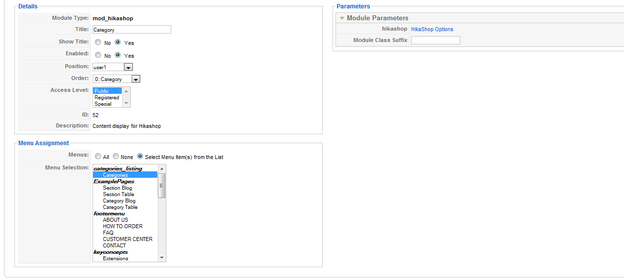

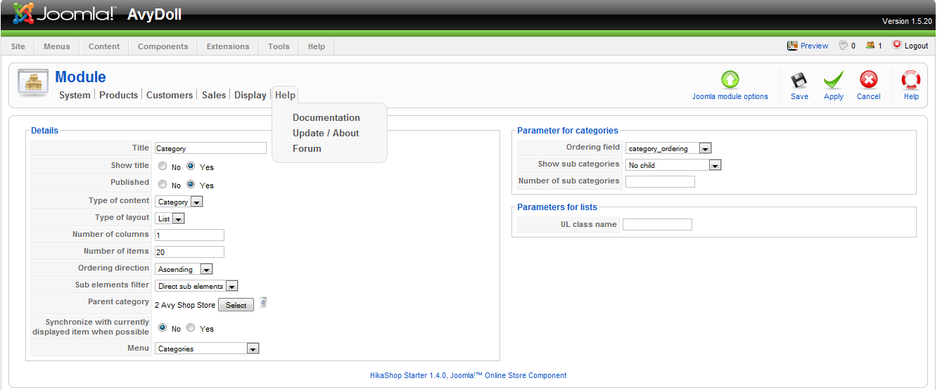

Could you post a screenshot of the Hikashop options and one of the joomla options of your module ?

15 years 7 months ago #3630
Here they are.

Could it be that you don't see the module because it can only be seen on the "Categories" menu ? Maybe you could try to set the 'menu selection' option to all temporarily and see if you get something on the front end ?
  • Posts: 4
15 years 7 months ago #3637
Thank you very much. It works now :)
