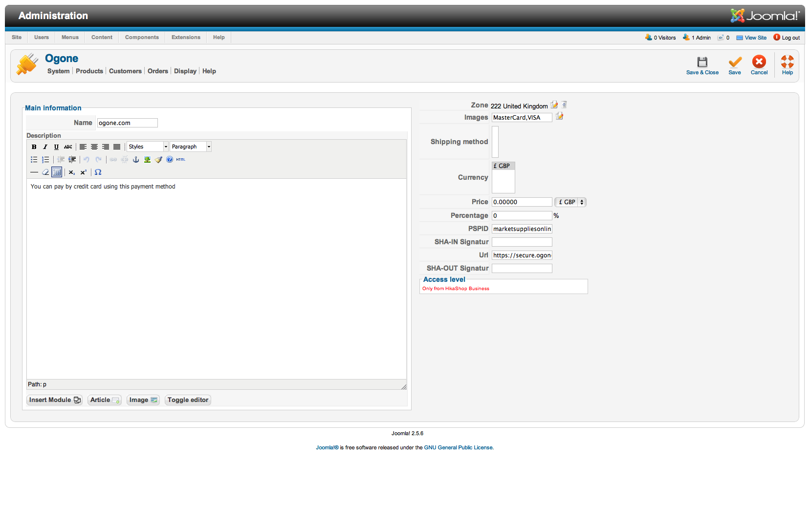

  • Posts: 7
13 years 11 months ago #58608
Please find attached a screen shot of the payment plugin settings. I have deleted the sha-in and out details for security reasons, but cannot figure out any reasons why this is not working.
If you'd like me to send you screen shots of any other settings please just let me know.
Many thanks,
David
  • Posts: 85786
  • Thank you received: 14078
13 years 11 months ago #58677
Please remove the zone restriction that you have (because otherwise the payment method would only be available for UK customers so it wouldn't display if your address would be outside UK).
Also please deselect the GPB currency.
Finally, I checked the code and the plugin only accepts the euro currency. It seems that you're using GPB so it's normal that it doesn't show.
You would have to edit the plugin file plugins/hikashoppayment/ogone/ogone.php and change the line:
'EUR'
to:
'EUR','GBP'
if you want it to work with GBP.
